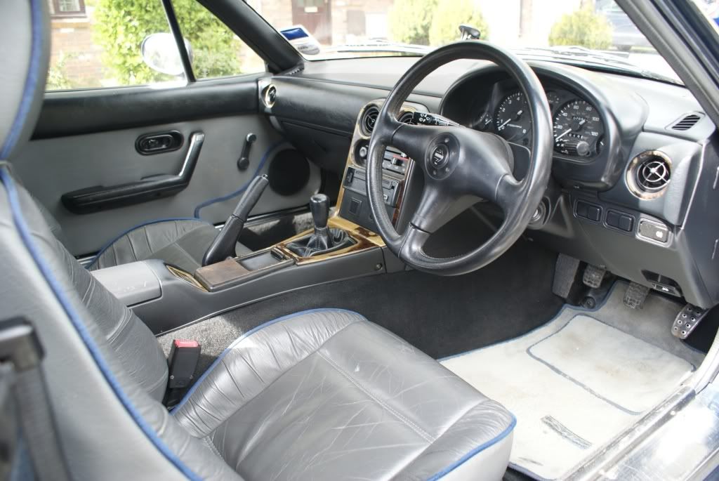

I have just got a MK1 Dakar, and below the stereo on the right there is a headlamp dip switch, and to the left just a big blank panel. (ive attached a pic which you can kind of see it on)
I was wondering if you can get a clock to put in the big panels place as I notice there is no clock in the car

 Hi, there is normally a small compartment under the stereo, yours seems to have been blanked off. You can get an mx5 clock with a small compartment next to it or a bmw E36 clock fits perfectly ( you can find them off ebay)Big Smile.
Hope that is of some help.Fishy
one of the two blanking plates contains wiring for the optional dash dimmer.  Pop them out with a flat-bladed screwdriver to check which it is.

 I did this…you could use a different clock if you wanted and put it where the left hand blanking plate is used for the electric mirrors on other models:
http://www.mx5oc.co.uk/forum/forums/p/9503/52109.aspx#52109
The BMW clock/cubby solution does not work too well on UK models as it leaves an irritating gap of about 1cm that needs to be filled with something. You would also have to relocate the headlight levelling switch.
Mine has a square clock, which fits in where the blanking plate is in yours.
And where did that clock come from?
 Got mine off eBay…fitted to some special editions…come up from time to time but go for quite strong money.
I would assume the clock was there when the car was new…
Technically, thats all Japanese and UK 1996+ plus, as these both used a slightly different radio rurround. You can fit a radio surround from an earlier car (and then fit the steel clock plate solde by SFT), but you’ll end up with a non-flush fitting radio.

Mine looks like this now!
That looks excellent.  I found this via google (before I ventured into the forums); I too have been looking for a clock and the Renault 19 one seems just right (although the prices are now around the £20 mark).
