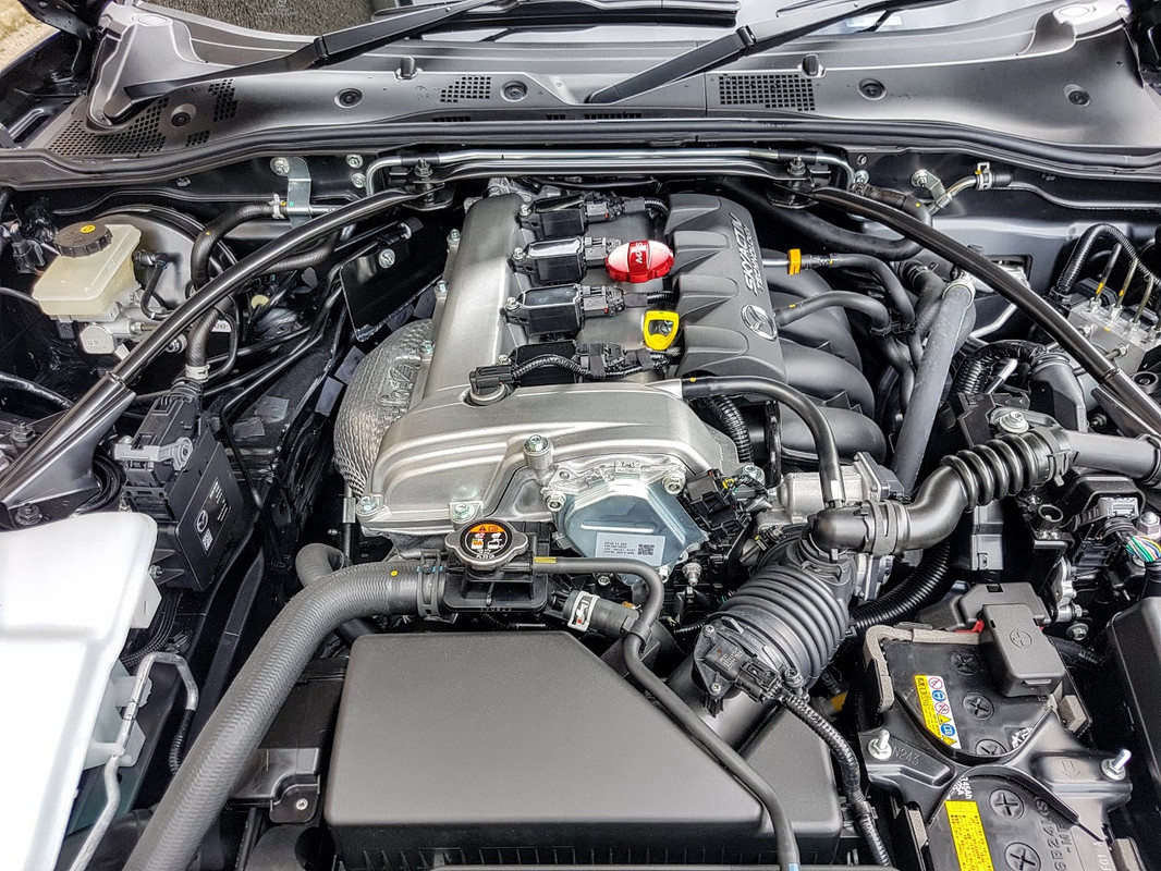

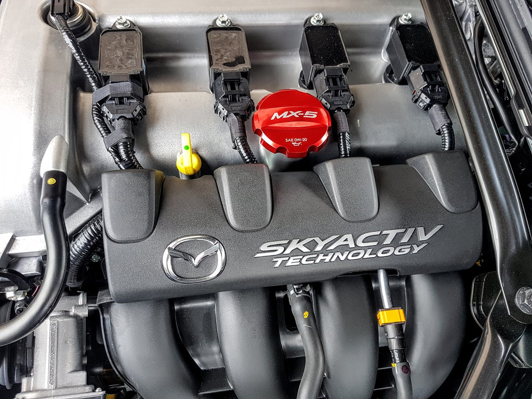

Oil Cap

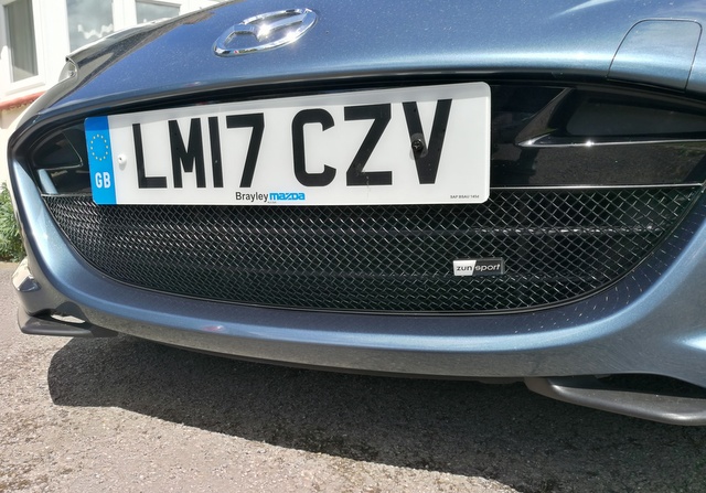

I just this week went for the half-grille.  I wanted to retain the standard appearance of the car but with the cooling aperture being relatively low, and the bars being so widely spaced, I decided it was worth having some protection even if stone damage is a rare event.
Appearance-wise if you go for black, full/half doesn’t make much difference IMO.
As you probably know, you will need to make holes in the original grille to fit a Zunsport.
If you go for full, you might well end up drilling more holes for the number plate if the existing ones don’t coincide sufficiently well with the holes in the mesh.
Regarding fitting, I drilled 1mm pilot holes for the quite small screws provided.  Just forcing them into the fairly thin plastic of the original grille as implied by the fitting instructions seemed a bit messy/risky to me.  But I tend to overthink these things.
The top hook was reluctant to engage.  I opened it up slightly, it wasn’t a problem.
Appearance:
