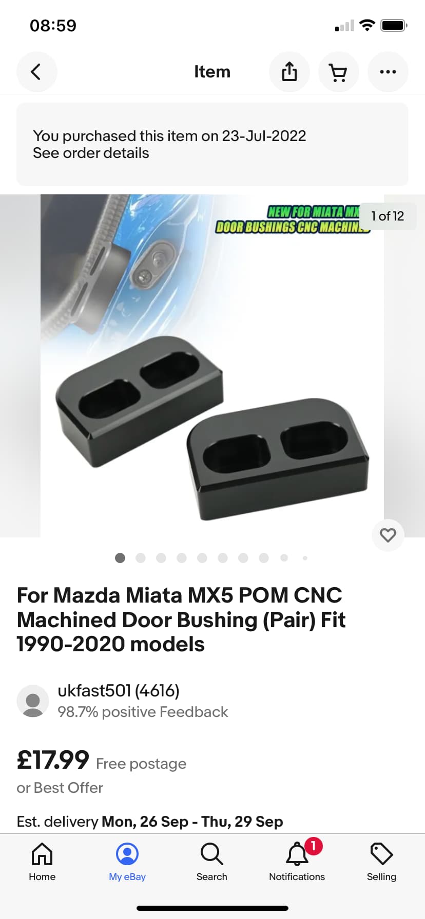

Fitted replacement bushings to my NC a couple of months ago. It took 10 mins and there was a noticeable difference. The car felt stiffer, opening and closing is firmer and possibly reduced some rattles. I bought mine off eBay see pic.
