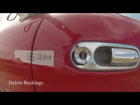

I’m not sure what the video shows.
That they’re no different?
the video shows they move less, and suggests in description some change to NVH. But not at miracle levels. A little rubber bush can’t support the twisting of an entire 1100kg car. But for £15 it looks like a small measurable improvement. That may possibly be amplified under even tougher driving conditions, e.g. smashing over a kerb on track.
Yes.
Lets see if in a few years time, there are some NC and ND door handle failures, because they broke after too much hard slamming./ hard pulling. Those assemblies aren’t cheap.
Lets see 3 videos with each, and 3 videos with a brand new Mazda rubber block. The difference appears insignificant. Might not be even on the same roads, same speed.
So they made no discernible difference to your car ast?

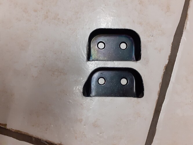

Hi ast,
Your video shows that you have the ‘later’ door cups (I believe these were changed from ND2 onwards) that do NOT fit the door bushes. The slack that you show clearly indicates this and I can also see that the shape is not a match for the bushes.
The lower cup is the one you have and the upper one is the correct one for these bushes. All MX5 had the upper type right up to ND2.
However do not fret as I can confirm that even with the correct matching cup you will not be able to feel any difference.
It may be worth amending your video with the information regarding the differences in the cups that I have been able to glean from my experience.
Not my video. My car doesn’t have rattly doors after 275k kms,
Not my video. Not my car. After 25 years of MX5 ownership, I see no compelling argument that convinces me that I need these parts. I think these parts are a waste of money, but others will disagree.
