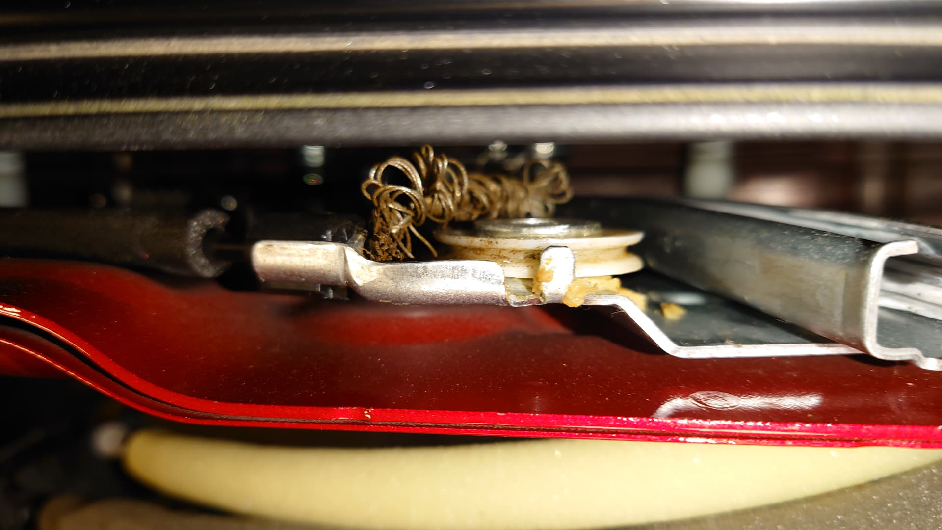

The cables fray and break. Mine was replaced on the driver’s side under warranty. Quite a common problem.

On mine the fraying was in the section of cable that goes over a nylon pulley at the top of the door. I think it is the frequent movement and twisting that causes it to weaken and break. I was lucky as the frayed and broken strands were rubbing against the glass making a strange sound so I had it sorted then before the whole cable snapped.
