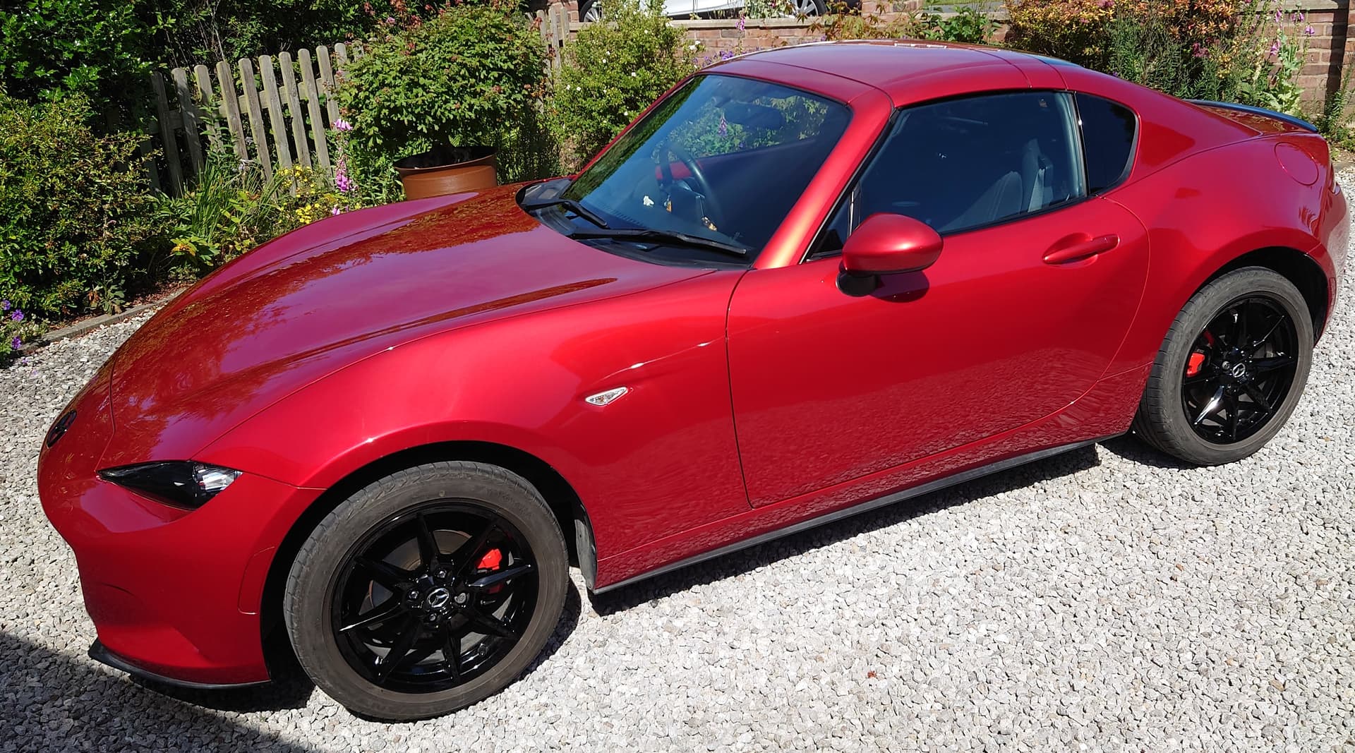

Hi everyone! My MX-5 RF is now repaired. I couldn’t get photos for all of the procedure but here are some. I can delete them if they are of no value!
Part cost me £45 from Mazda dealer and £40 labour from my local mechanic!
Ofiaich!
…looking good, pleased you managed to get it fixed at a reasonable cost!!
That old cable was well and truly mangled. £40 labour sounds good. Result.
