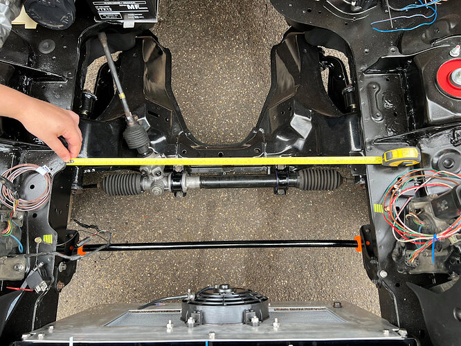

Currently designing the HV battery pack. It looks like we could easily fit 32kWh in the engine bay and this would weigh about 135kg + cooling plates + enclosure. We have just weighed the car at 587kg, so we are very confident we will hit our 970kg target weight. We could fit more batteries where the petrol tank used to be but we are more interested in reducing the weight than adding more range. In theory, we could match the original weight and have close to 200 miles of range if we wanted.

We have a Cupra Born V2 58kWh. It’s a great car and does 220 miles in summer and about 190 miles in winter. This easily covers 99% of the journeys we do and we have not had any issues going across country in it and using public chargers.
My previous sports car was a 450kg Fisher Fury R1 (motorbike engined, 400hp/ton) and did about 80 to 120 miles on a full tank of fuel (depending on how you drove it). It met my needs perfectly and this is why the MX-5 is being designed to this range too. As the technology improves, it would be fairly easy to upgrade this later should we wish. The car is purely for fun, local driving around the B-roads of Suffolk and Norfolk.
The MX-5e is a test bed for our next ‘scratch’ collaborative EV build which will have over 200 miles range, 350+hp and weigh less than 1000kg. The Open Source Sports EV (OSSEV) project is the reason we are building the MX-5e first. https://ossev.info
What will the fore aft weight distribution be with these batteries?
We have some control over this. Bear in mind that the engine and gearbox removed weighed 197kg. Then you have a whole load of other stuff associated with the ICE: Exhaust (20kg), air intake system (4kg), cooling system, fuel tank (22kg), fuel (40kg), heat shields, sound deadening, etc.
We have fitted a motor and reduction box which weight about 82kg and these sit where the gear box was. The full 32kWh battery pack is about 140kg. Inverter is 22kg. So 240kg in total.
Then there are all the other things we have done to reduce the weight such as completely rewiring the car from scratch, to remove redundant wiring. We are using a much lighter 12V battery as we don’t need to turn and engine over.
So seems like a few tens of kilos moved forward, and an overall reduction.
