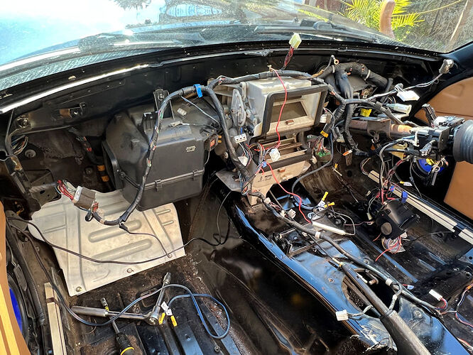

We are replacing the tan dash with a new black one and a new black carpet at the same time. It’s taking ages though.
There is an easier option. It’s called paint. :wink:
I did paint a few pieces to see how it turned out. It was OK. We needed to remove the dash though to service everything behind it. All the foam has turned to dust. The whole wiring loom is being replaced with a new one that supports CAN bus. The air-con is going. We are even contemplating a custom dash which will be much lighter in weight.
It’s gone now :grinning:
Now have a complete black interior, to replace the tan one, including this new dash.

Having removed the dash in the MX-5e, we have also taken it apart. Plan A is to see if we can make up a curvy, custom dash based upon the metal support frame within it. We took and angle grinder to it to remove the unwanted brackets and rubbed it down to remove the surface rust. It has now been treated with an etch primer.
In a 30+ year-old car, anything made of foam or rubber is crumbling. So we are refurbishing things like this fan unit as new. It has been completely taken apart, cleaned and new neoprene rubber tape seals installed. Any rusty parts were treated and repainted. It has made us realise that we need to do the same thing to Yoko now.

Despite extensive modifications to the wiring loom, I was very chuffed when it was all put back together and the MX-5e started first time :grinning:
I’ve now added in the wiring for the 10" touch screen, sub-woofer, etc.
