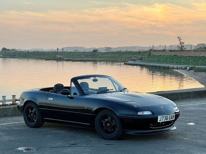

Another “test drive” up to Orford Quay. Dynamically, we are really happy with the car now. The new wheels and tyres have improved the ride and the grip levels are really good.
Enjoying driving the car in the sunshine whilst we do more research and buy more bits for the conversion.

Can’t stop driving it :rofl: Tinted side repeaters fitted. Tinted LED front lights being built :sunglasses: Black cars are hard to photograph!

Lovely photo.
