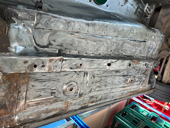

The car is currently up on ramps, whilst we remove all the old underseal, treat any rust found and them prime it and re-underseal it all. We can then fit the new subframes, suspension arms, ball joints, polybushes, etc.

Pretty much completed both side of the floor now :sunglasses:

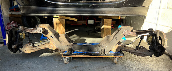

Dropped the front subframe to get full access to all the chassis parts that need treating. Remarkably little rust on this 1992 Eunos Roadster!

We have primed the floor using a Buzzweld glass reinforced primer. This should see the car last another 30+ years :sunglasses:
