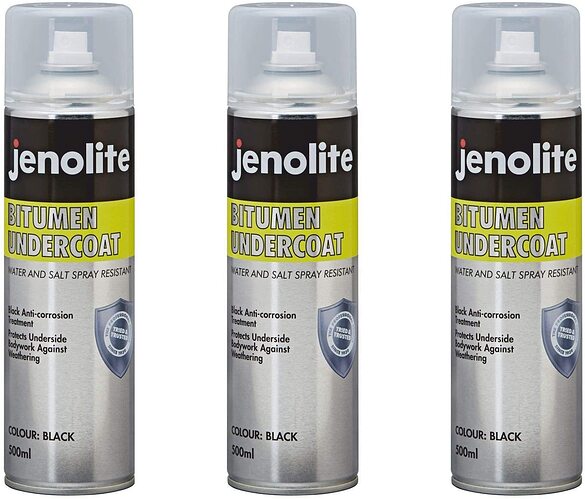

I’m mentally preparing myself for spending my entire next weekend under the car, Ill go through all of the panels that are accessible to me, I want to sand & scrub them all down with wire brushes & then apply rust converter, would you be able to recommend what type / brand of paint to use at the end, the arches & sills actually looked ok surprisingly
Would something like this be ok to coat the underside once I’ve dealt with the corrosion?
I used Bilt Hamber Hydrate 80 rust converter and also their black two part epoxy mastic. Follow the instructions, it stinks so do it outside and wear a mask and gloves, old clothes too when applying.
For good measure put two coats on the worse areas that catch the weather under there and I put a third coat of black Hammerite around under the rear wheel arches and rear sub frames, that’s the parts that the exhaust back box hangs off.
