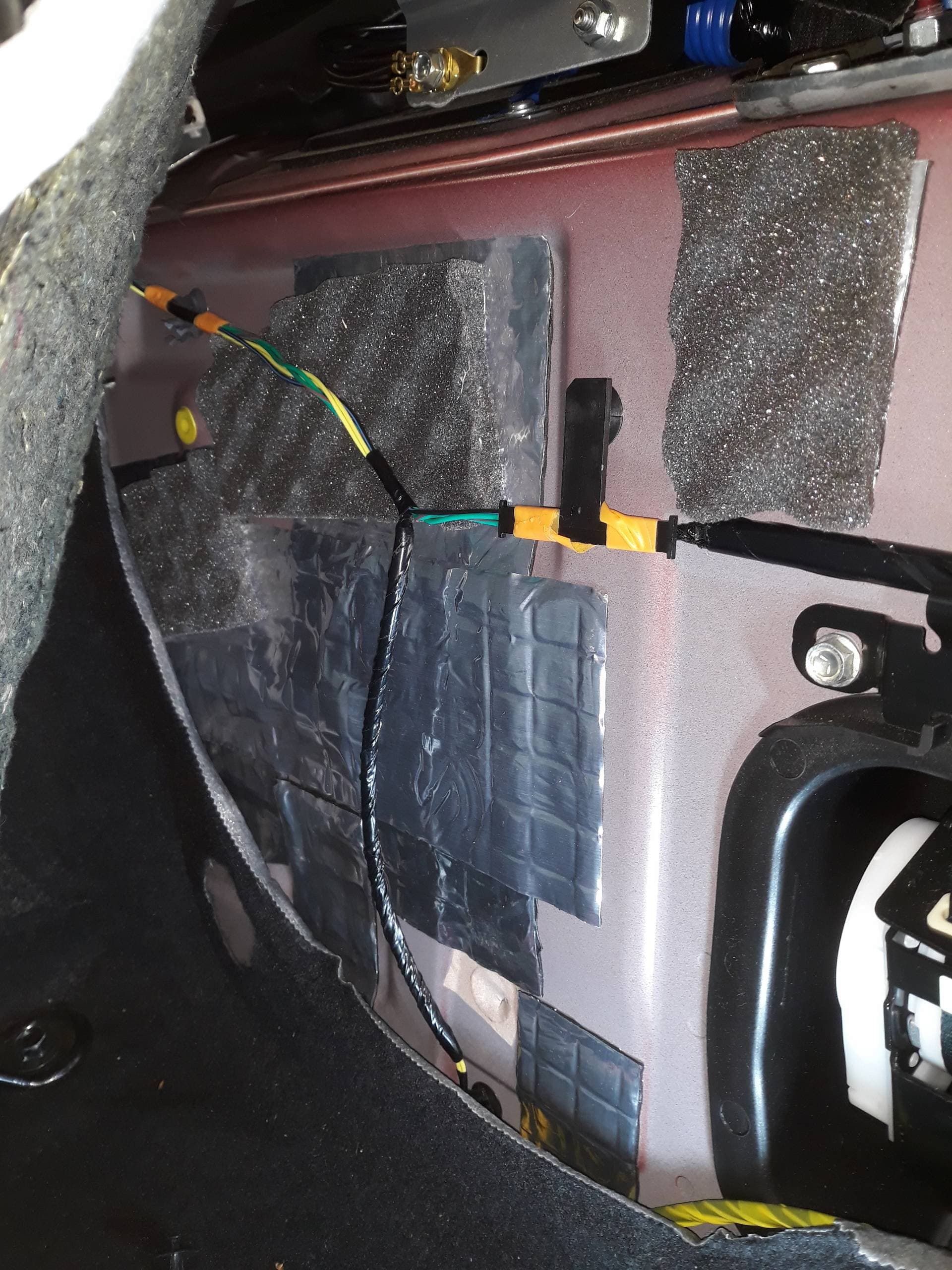

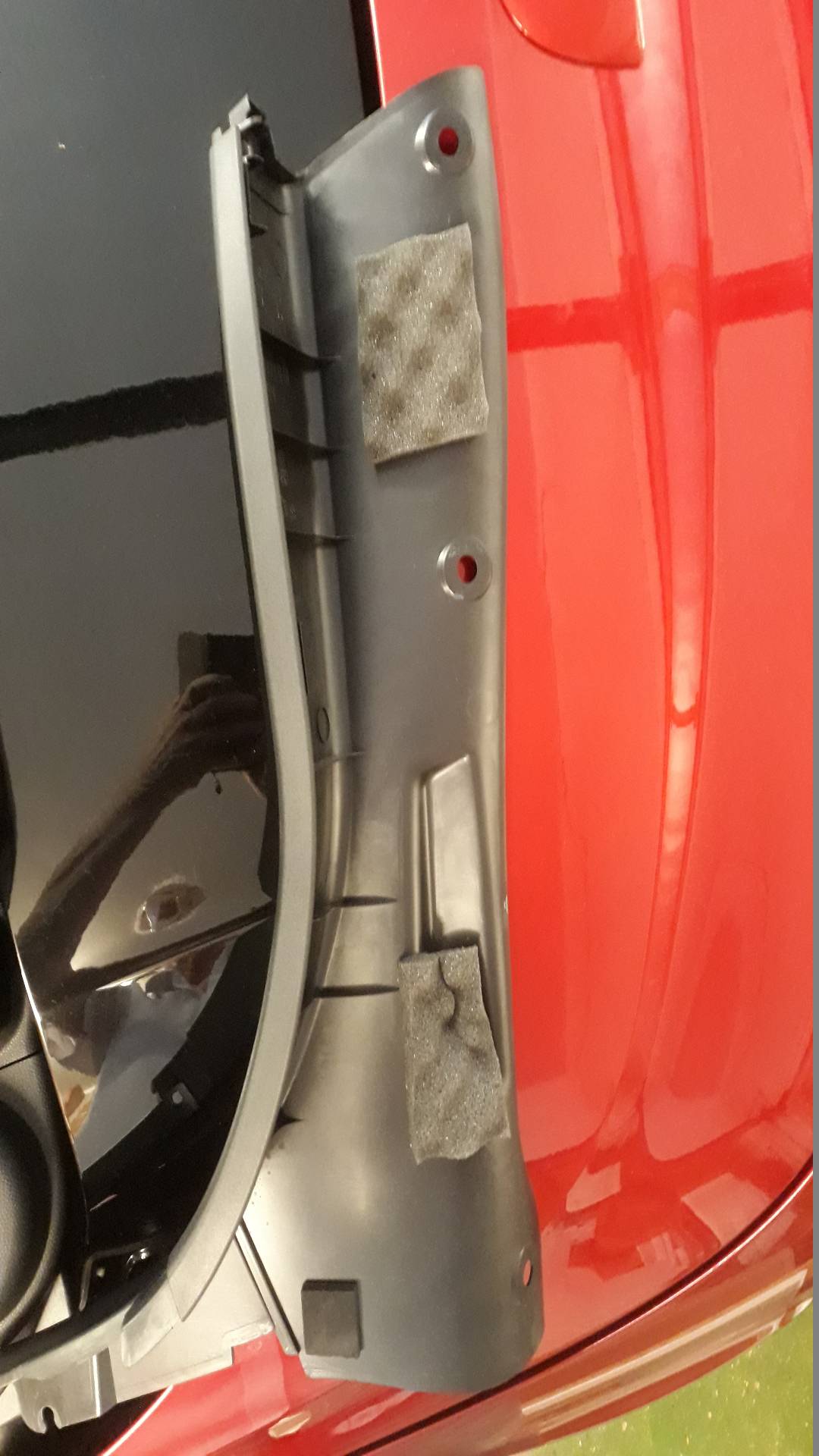

Tweaked the sound-deadening slightly to stop the rear-trim behind the seats rattling on certain low notes in the bass from the sub. Mazda’s bits of felt on it behind each seat were not enough.
I simply added some of the sticky-foamy Silent Coat in suitable places on top of the existing foil layer and on the B-pillar trims to damp out the resonances without making the trim bulge.

Pics of the passenger side foams.
