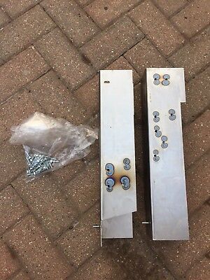

Now. What’s the best way of doing this the right way. Honestly, I don’t know what i’m really doing. I’ve found another set on ebay, Link bellow. But I don’t know any feedback for these.

Link to eBay set.
I used a pair off of ebay on my Mk2.5. Looks like the ones you have shown.
They were well made, fitted fine and all the pre-drilled holes are in the right place.
I primed the inside before fitting and then injected loads of waxoyl in when done.
I bought those exact ones, I forget which company they’re actually from but they’re more annoying because they’re one piece rather than 2 pieces of the MX5 Restorer ones. With these I had to cut one of the sides off (outer) and then installed the inner side with the underside as one piece and then welded the outer in as well. I made up a steel template so I could be sure these new ones were in the exact place the old ones were, measure hole distances etc.

Ahh brilliant, that sounds like the set that just arrived today!

Update. Car’s Sorted on that front - https://imgur.com/a/vJtvUva I bought these rail repair panels - Set of Mazda MX5 Chassis rails repair panels | eBay
