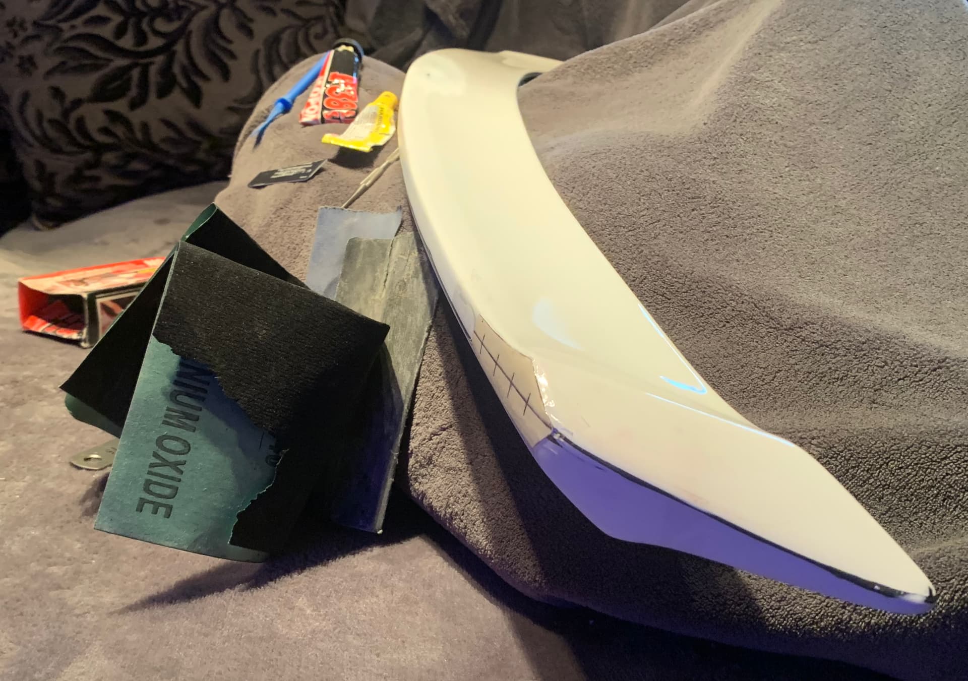

I don’t want a horrible little lip spoiler, neither do I want a stupid great GT wing.
I’m looking for something more traditional, iv found a few that i like but in every case they say “NOT FOR PRHT”
so my question is why? why cant i put this type of spoiler on my PRHT?

I really want something VERY similar to what’s on the blue MG in the picture but made for the mx5 NC.
both the rallybacker and mx5-parts one are only as wide as the boot lid.
I want one on which the ends will tip down into the line of the rear wings.
however, after an hour of searching, it looks like there is nothing other than a choice between the aforementioned mx5 parts and the rallybacker.
yes there are the GT wings but they are just too overstated! and quite honestly would look and feel silly on an everyday driver, street car.

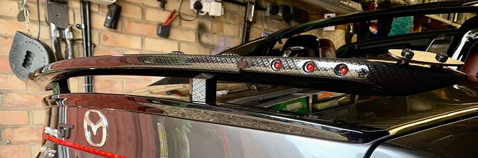

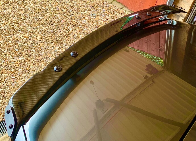

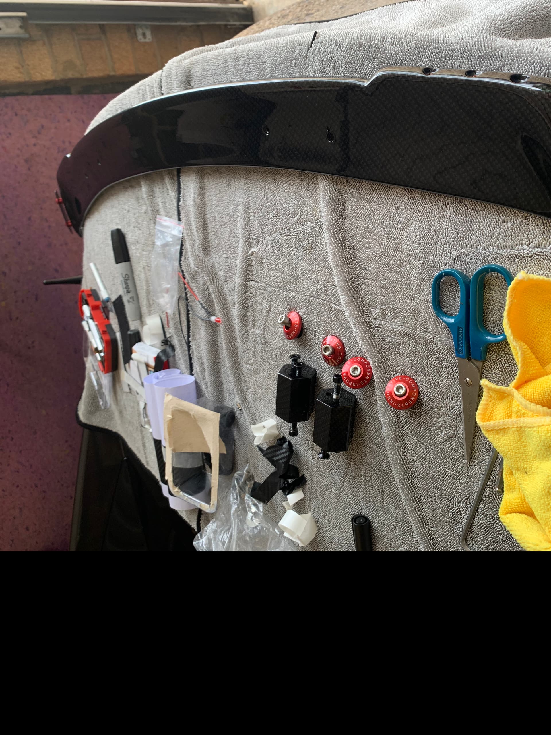

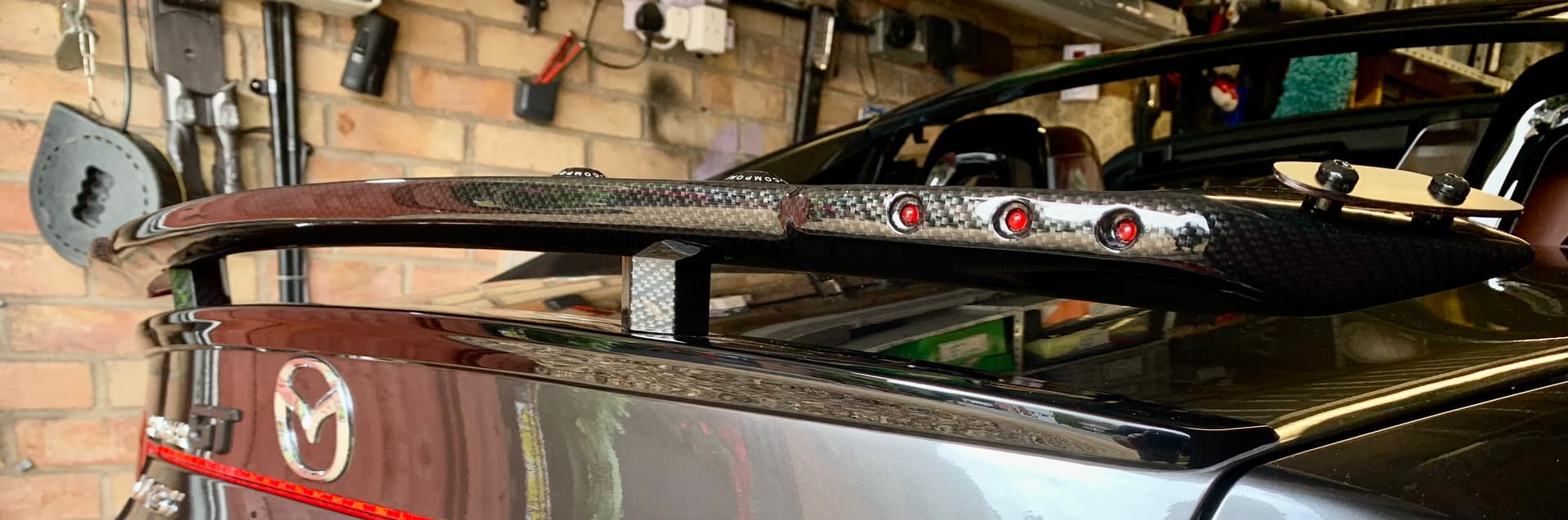

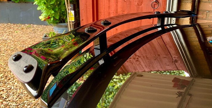

You could design your own and make one out Carbon fibre there are kits out in the market place or make one out of fibre/glass composite a lot of time and effort but it depends on what you want I made my own as I make a Lot of stuff but would not make for anyone else do to the liability factor and time if you want a one off making then be prepared to pay £££ big bucks the only way around that is mates rates or do it your self :wink:
I started my own spoiler in august 2020 did not fit it till may 2021 year…
and I am still working on the mounts I am going to lower the spoiler by another 22mm later next month then I think it will look more aesthetically pleasing & pass the MOT… :wink:
Cost me around £120.00 and took over 200 hours as there is so much more involved not just making this the mounts, the electrics, MOT regs with ref to the Rear 3rd brake light , RF Roof interaction, etc,ect, :sleeping: :sleeping: :sleeping:

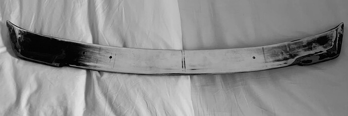

When I bought my NC it already had a boot spoiler which I was told it originally came from a Hyundai Coupe.
I’m afraid I don’t currently have access to the car to take a pic, but this is from a current listing on Ebay that I’m pretty sure is the same or very similar. And it seems the same people (in the Czech Republic) do several other versions and all at what seems like a very reasonable price.

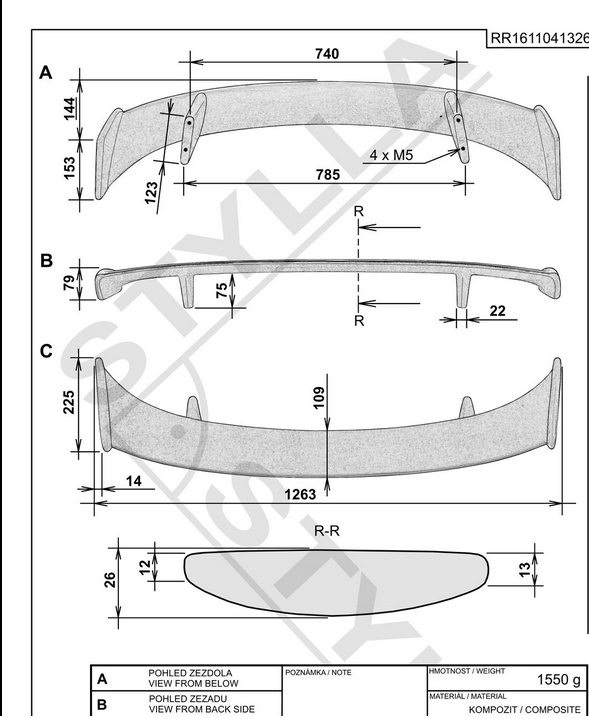

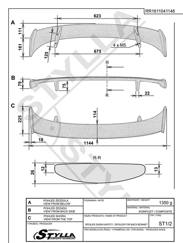

ok, I got a reply from the eBay seller.
he doesn’t do one for the mx5.
however, he says that the following 4 could be suitable.
so he’s sent the diagrams but I am not technical and I am out of my depth with them.
from looking at them i think spoiler 1 is probably the closest curve but i am also probably wrong!!!
anyway here are the diagrams he sent
spoiler 2
spoiler 3
and lastly
spoiler 4
so which of these would best match the rear curve of the boot lids on the hardtop

to be honest, length doesn’t matter so much as most body shops will be able to shorten or lengthen.
it is the curve that’s the important bit.
anyway, the conundrum is set, who will solve it?
ok, I just took some rough, very rough considering it’s 3 am and rather dark.
so measuring a straight line across the back boot lid from the end of the top. is 106 cm or 1060mm
measuring the top wing in a straight line from the edge of the boot lid to the end of the rear light is max 12 cm, tho I would hazard you would want the end of the spoiler to stop at 8 cm so it can blend down properly into the line.
so if we say an 8 cm overhang on the wing that gives a total width of 122cm.
or with nobody line blend at a max width of 130cm
oh my god, this is making my head hurt.
so I’m thinking either the last diagram of spoiler 1 or the last diagram of spoiler 4 for the hardtop!
edit:
changed my mind, I now think that I want spoiler 4 pics 2.
as that one don’t have the endplates and at 118cm wide it will be 6 cm past the edge of the boot lid each side which should blend nicely, if the curve is right?..
