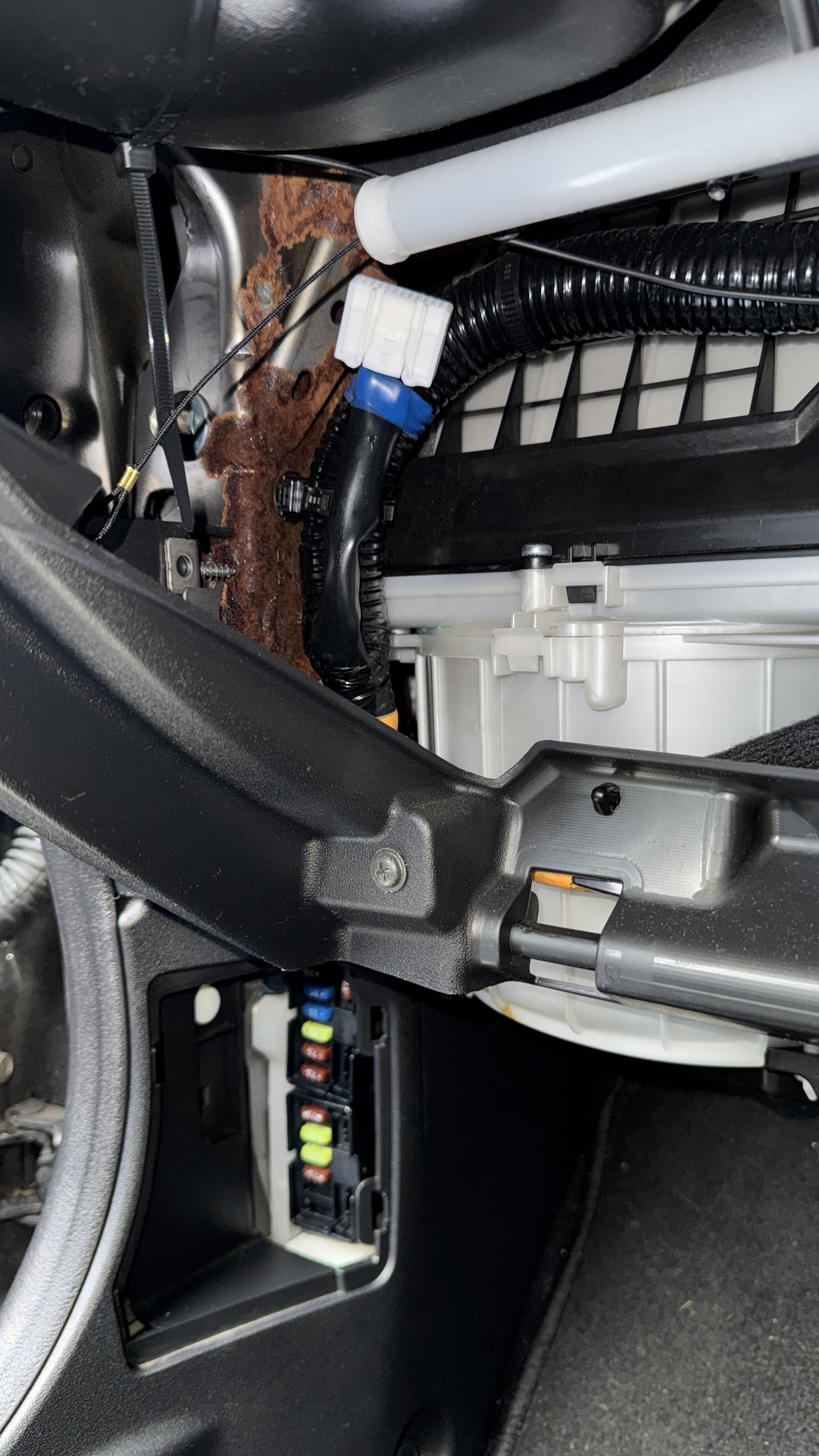

I purchased an NC at the end of November, 49k on the clock, perfect mechanically. Had a good look of the underneath and all the (or so I thought!) relevant points for rust, before purchasing.
Since owning, I have indeed been the culprit of the damned scuttle grommet leak. I had the headlight staying on scenario (OFF on the stalk), as well as the speedometer bouncing and ticking around the 120mph mark, all whilst no key was in the ignition. The PRHT latch light on the centre console was illuminated briefly before going out, too.
I’ve taken the glovebox out and discovered a rather large and possibly concerning amount of rust on one of of the metal frames, directly above the fusebox.
The car was bought from a dealer down in England (I am based in Scotland), and although I’m led to believe I’m within my rights to ask for a repair or replacement as it’s quite clear that the water ingress has been happening well before my ownership of the car due to the significance and amount of rust on the metal, I would rather just tend to the issue myself and make sure it is done correctly, as the time and inconvenience involved would be rather costly, as well as the never ending anxiety of being fobbed off by high street dealers.
My question would be, other than making sure the grommets are sealed up good and proper, and making sure that the fusebox and behind is dry - would there be anything else to watch out for after these electrical gremlins have already occurred? Or is it a case of once everything has dried out and there’s no corrosion in the box or wiring itself, it should be okay?

As for the rust, I’ve seen this on past NC’s owned, not as bad as on yours. Get it cleaned off with a wire brush or better a Dremel type tool and the some rust treatment and paint over. It’ll be difficult to get at but at least arrest the corrosion getting any worse.
