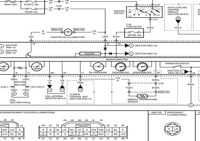

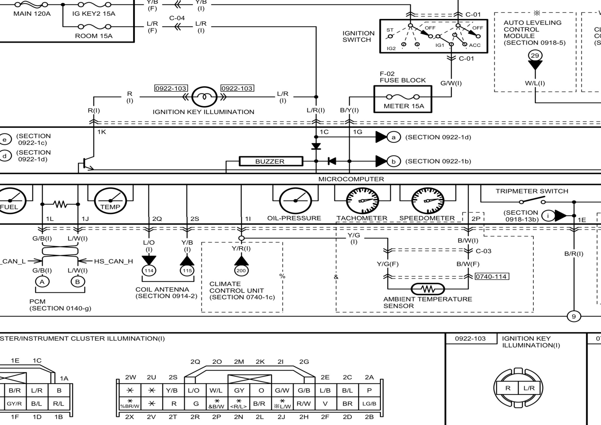

From memory I seem to recall the circuitry runs though the IC for the door open warning light and I think that a component (diode?) fails. If you post your VIN I can give you some tests to carry out but I won’t be able to do so for a week or so as I’m going away.

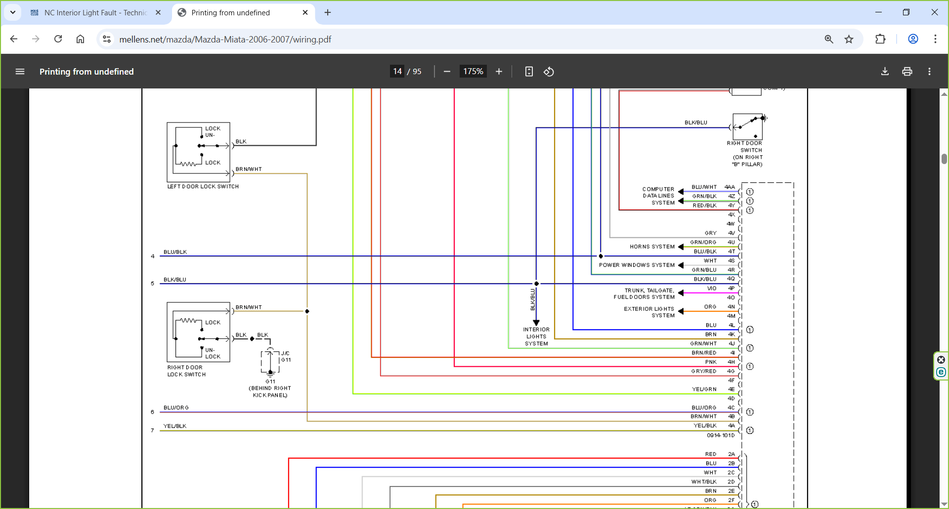

If the NC2 is the same as the NC1 - that door switch is a simple ground to earth to work.

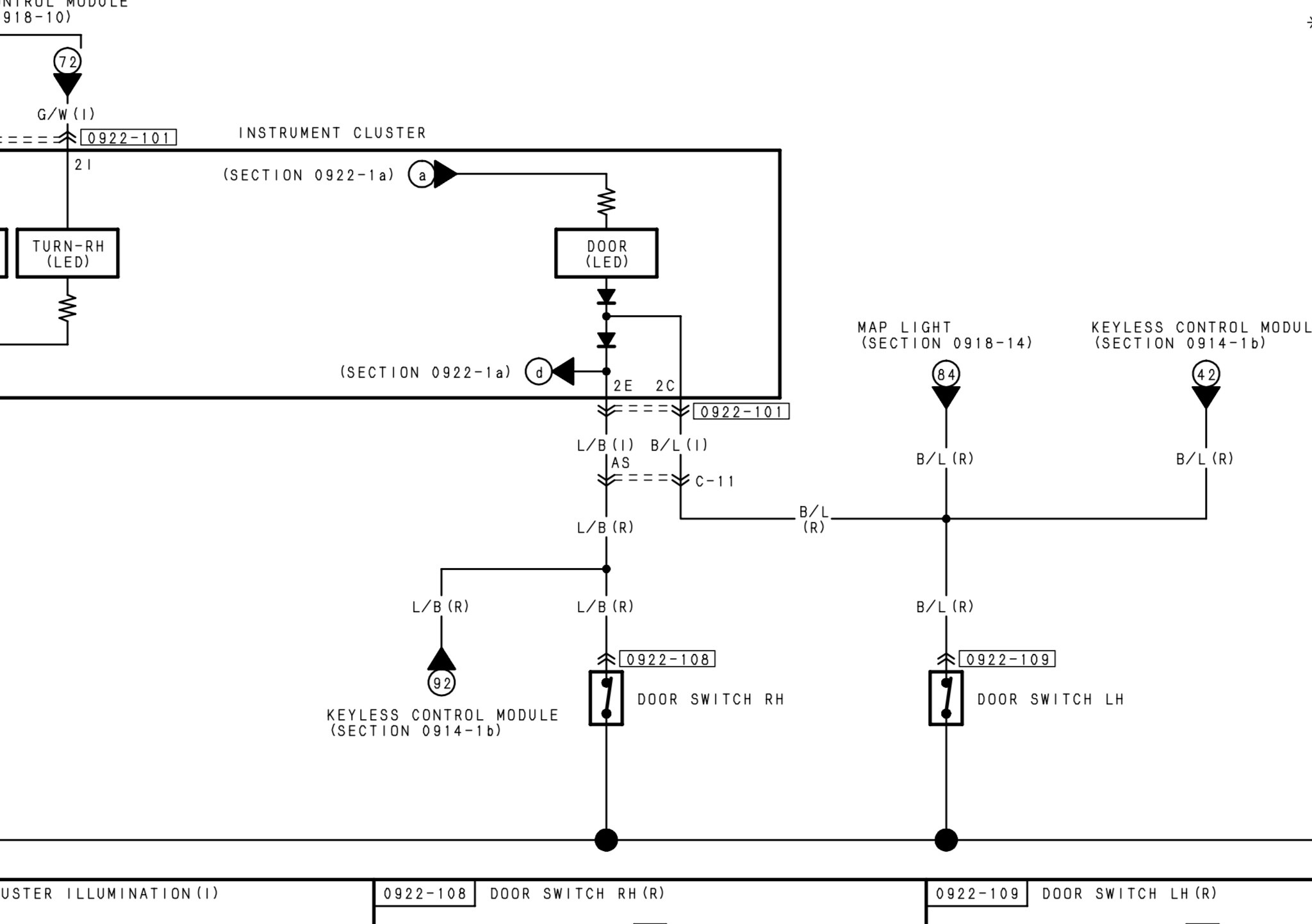

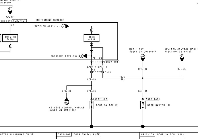

@CBRDEANO I think that wiring diagram simplifies the circuit somewhat, there’s a lot more going on inside the IC.
Looking at the wiring diagram again now, I think that it’s the lower of the 2 diodes under DOOR (LED) that fails.
@SteveMK3 Bridging the Blue/Black (L/B) and Black/Blue (B/L) wires in connector C-11 or at the connector on the back of the IC with a bent paperclip will probably get it working, if you’re keen I’ll point you towards C-11, but try this at your own risk.
