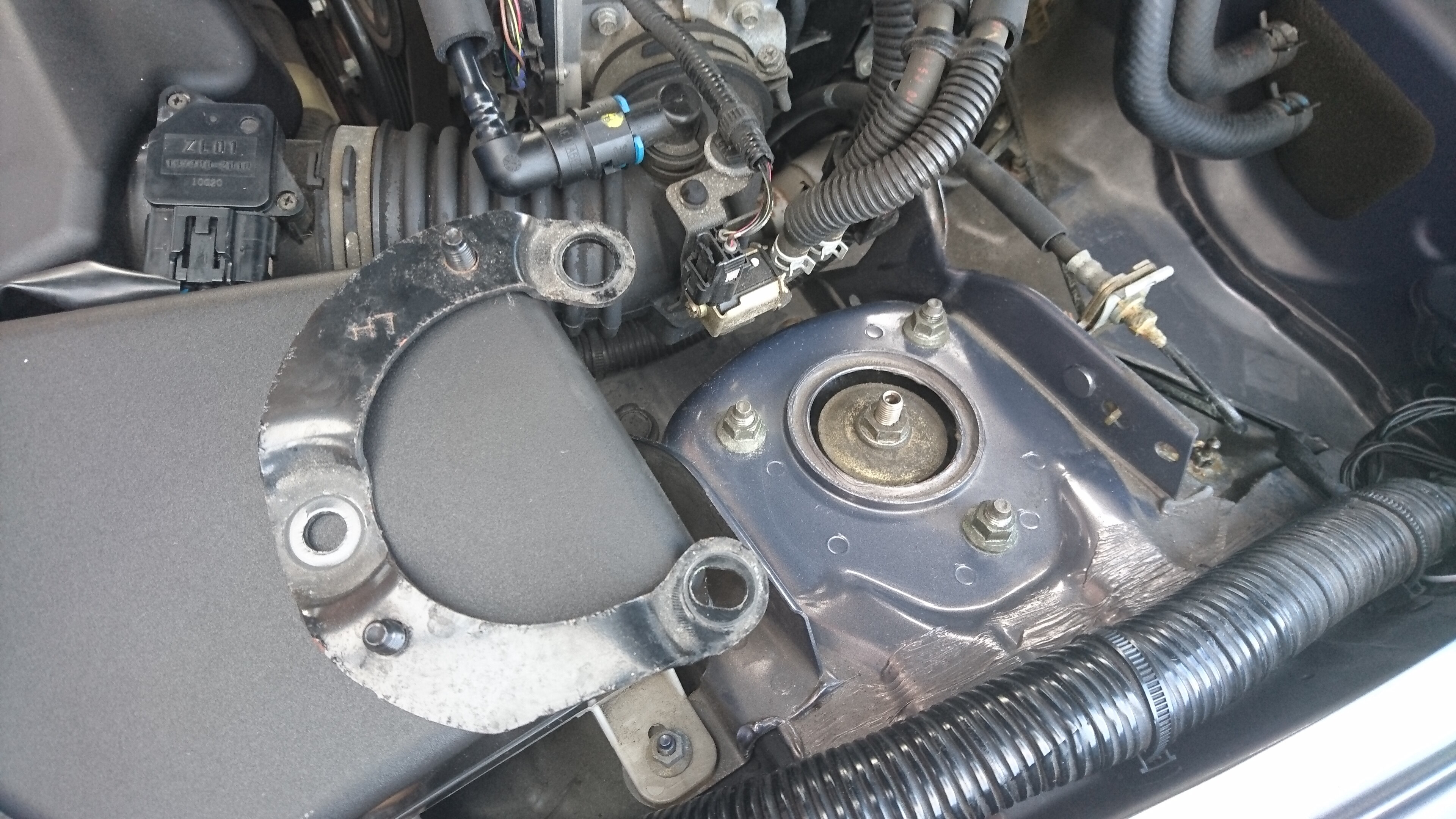

Some years ago with my previous Mk 3 I had a broken front spring, having a Guarantee from Stoneacres I got them to repair it. Both springs were replaced and they handed it back like this !(see Pic) I rejected the repair and after two attempts they got it back to where it was prior to the broken spring . Not to say that they did a good job but left off the cross bar metal connection plate !!MX5 Big GAp- Stoneaches
