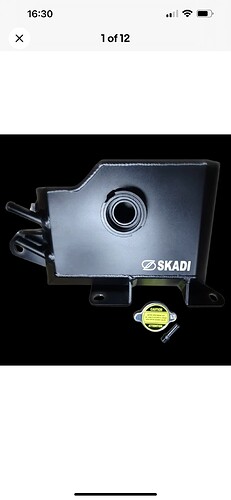

    Has anyone actually bought and fitted one of the Skadi Coolant Expansion Tanks?
It’s coming up to the 10 year coolant change.
So will be changing the FL22 coolant, thermostat (good practice) and was going to replace the expansion tank with a Mazda one.
However, have seen these (apparently not Chinese direct imports).
They do look well made and not the ridiculous price of some of the others out there.
Thoughts?

Yes, I bought and fitted one to my NC. Very easy to fit, with no need to drain anything down, other than the tank itself.
Have done 10,000 miles since I fitted it with no issues. That includes winter, summer and track days.
