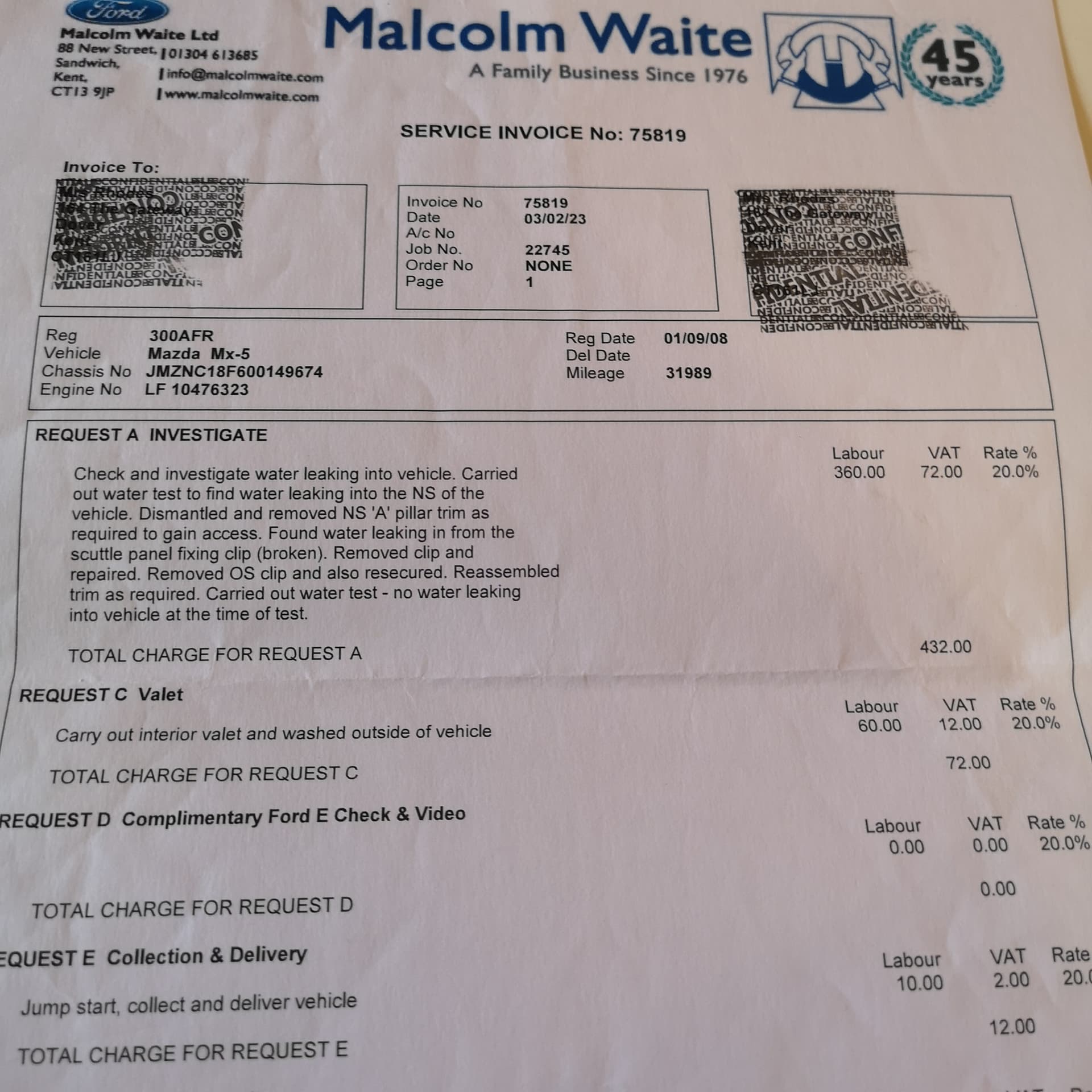

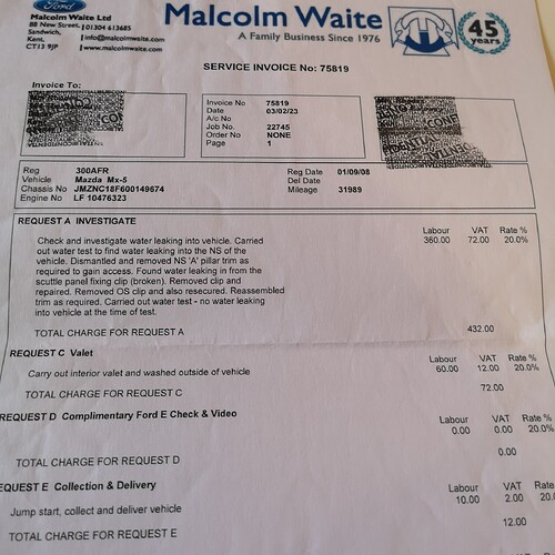

(an aside, just found an invoice in the paperwork from earlier this year for £432 from an authorised Ford dealer to sort the grommets! And they didn’t even put new caps on over the screw heads - jebus. Also explains why the stud on the passenger side A pillar trim is busted - they removed it, I guess clumsily, as part of their ‘investigation’ into the leak.). Between the leak and the noisy deck no wonder the owner wanted shot.

As for the cover caps over the screw grommets, yes they do break on the little tab when removing them. Easiest is to replace them (mx5parts) if in stock, or as I’ve done in the past a little silicone to hold them in if you still have the cap.
A ‘58 plate’ would most likely be the NC1 quite correct on the V5 as a Sport.
Just reread your post, £432 just for finding the leak and sealing the scuttle grommets?:woozy_face:
I think I’d be just checking on those again, make sure the jobs be done properly.

That’s insane! :exploding_head: I thought £60 was steep and that was Mazda’s quote, but £432… Whoa! thats a whole other level.
I’m so glad to know this now. Reminds me, I need to get some gloop! :+1:
I kid you not.
