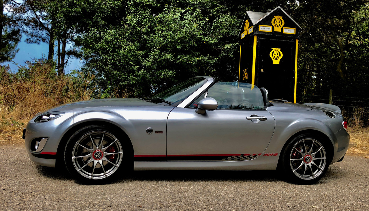

2010 Sport Tech with Meister club race fitted to replace the standard Bilstein suspension. Third set I’ve had, other two were on mk1’s over three separate cars. I really like them as they come with top mounts fitted too, making it easier to install. Approximately 30mm drop which for me, is fine. I recently set the damping almost to full soft from mid setting and find the car very comfortable. Also had Eibach -30mm springs on standard shocks fitted to a previous NC1 soft top, for the money, they were also a good option but more for looks than anything else in my case.
Meister’s on the sport tech
Eibachs on the other car
Kuro on Meister Rs
Kuro on Meister Rs
