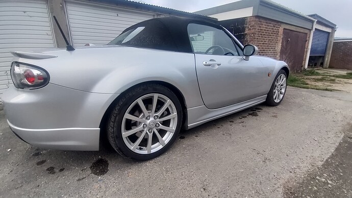

I’ll post some pictures just for reference. Just in case someone spots anything. Also perhaps I should add, all bushes have been replaces with energy suspension, their road version. Another thing to note, which i’m a bit sceptical about TEIN offering any supports. In their manual, it clearly states, offroad use only as they are not road legal, and only an authorised garage to perform the install in order for aby warranty to hold. I did these myself.

And what have you set ride height at? Measured wheel centre to arch.
