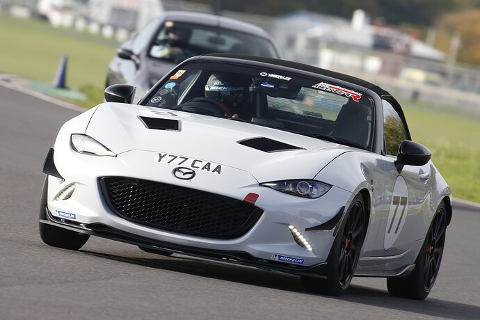

NC Wing Vents *WARNING CONTROVERSIAL*
I think its suits your overall theme you have going on :+1:
Im Usually a big critic of mods. However this looks good ,I think it gives it a bit mote muscle.
Taking a dremel to such a great looking car would have terrified me, looks good I like them. I would be interested to see them painted the body colour as well.
The science side sounds interesting, and it would be interesting to hear your feedback.

The aim of my first comment was not about modding your car or cutting into the fenders, but about modding it effectively so that its a useful mod (or at least to do what you intended it to do).
If it was just about looks (its your car, if you like it its all that matters). if it was about cooling the brakes - I just cant see it working,

They do improve the look of the front wing as in my opinion the NC wheel arch blisters were bit overdone. Before you go cutting holes in the liner drive down muddy lane and see how much mud is deposited. Then have a look at a Le Monday ans sports prototype car… Your vents are small and over the outer edge of the tyres so may not do very much other than dribble some mud onto the top of the blister. On the plus side, if the NC has similar louvres to in the front of the liner to the NB, you could get some interesting f
You might want to read this : Le Mans prototypes get fender holes to reduce airborne crashes
So even Le Mans cars going at 300km/h need rather large holes to be of use to cut lift, and the drivers will accept a bit of mud being thrown up as it will hardly be noticeable compared to dirt thrown up in the wake of a racing car with a ground effect underside.
I do like the look - the wheelarch “blisters” on the NC were, in my opinion, not particularly attractive, and adding the vent seems to reduce the “blobbiness” of the blister.
Before you cut holes in the wheelarch liner, drive down a muddy lane and see how much mud ends up in the area you are going to cut…as someone else has said, some of that is going to come through the louvres on the top surface. If the NC has the same sort of slots in the front of the liner as my NBFL, the airflow through the slots in the liner might end up going through the louvres in your new vents…which might be a less muddy way of making the new vents functional. I would not like to say whether you will end up with more water going into the void between the liner and the fender metalwork.
If you look at road cars, a lot of them have dummy vents added by the manufacturer’s stylists, so don’t worry too much about having a couple of good looking vents that don’t do anything!
Finally, vents on the side of the front wing/fender were originally put there to help extract hot air from the engine bay on cars like Aston Martins and Ferraris…there was a corresponding hole in the inner wing. The reason for doing it was that cars in the 1950s and 60’s had carburettors and mechanical lift fuel pumps which were prone to “vapour lock” when hot air was trapped and boiled the fuel in all those pipes and carb. float chambers. That resulted in cars that wouldn’t start after a pitstop. These days electric pumps deliver fuel at high pressure so vapour lock is not a problem.
If you look at modern cars with a side vent, it is usually a dummy as the holes in the inner wing at the longitudinal/dash junction aren’t good for structural strength. Some high performance cars have vents on the front fender wth ducting from bonnet slots to the side of the car to reduce the airflow seperation on the A-Pillar, but that is real nit-picking detail and I’ve never seen independent tests showing they work!
