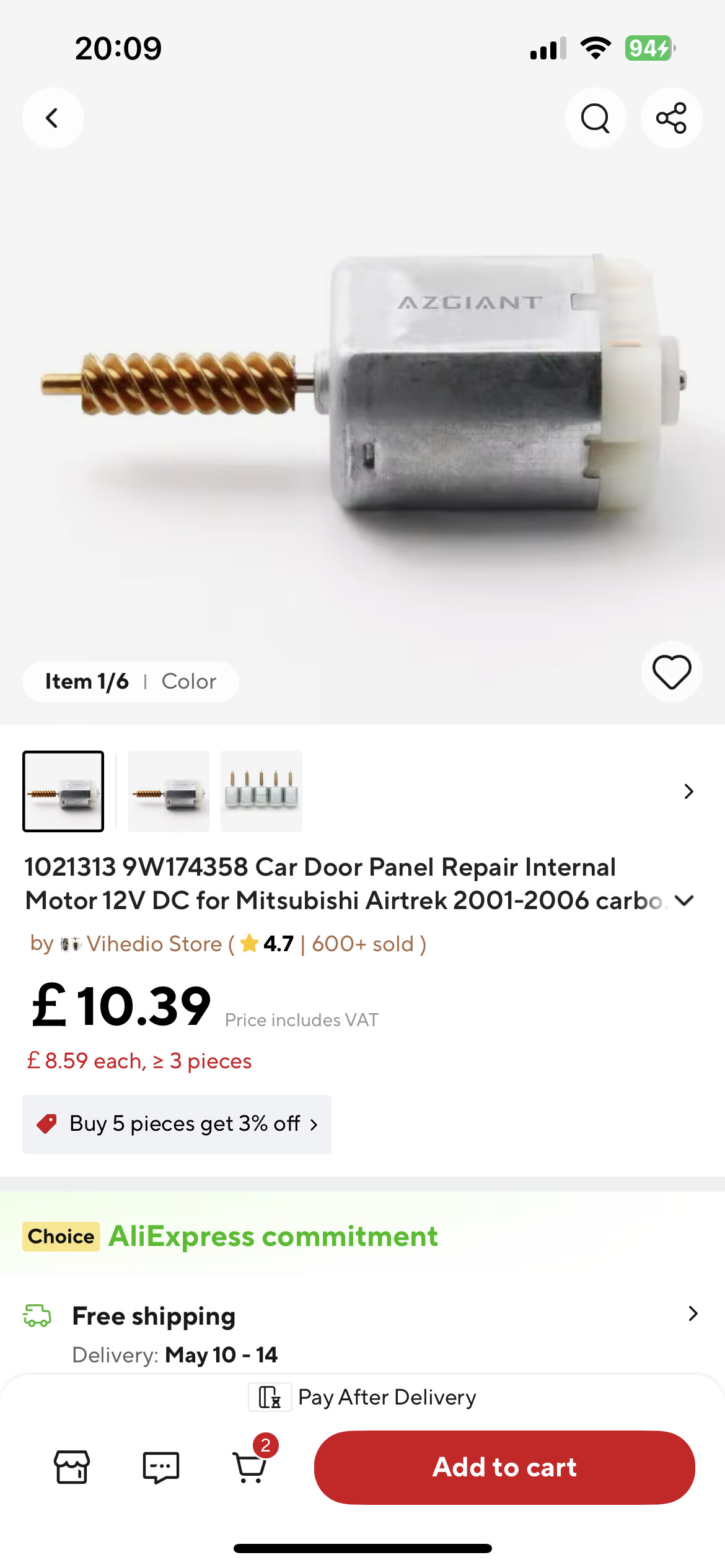

I know NCs CL can play up due to water ingress (mine is never out in the wet ) but it is 18 years old. I looked at a replacement mechanism at £125 but found a replacement motor on AliExpress which arrived quickly. In the meantime I sourced a new Panasonic battery and lo, all worked well and has done for 2 weeks. Until yesterday it was in direct sun again and same thing, had to use key entry.

First off have you got a link to the AliExpress one.

Thanks. Would you be so kind to send me a link for that motor? I’ll give it a shot for 12 quid.
Have a look in this thread, I collected lots of info and posted it for this exact reason.

I’ve got one of those motors brand new, just arrived if anyone wants it? I bought two and only tried one. I figured I’d try a motor while I waited for actuators to come back into stock.
I received a new actuator today from MX5City.
I’ll send you one for nowt.
That would be amazing, thank you!!! I’ll send you the address via messages and you can let me know how much it’ll cost you to send it so I can also do a bank transfer or similar. Thank you so much!!!
