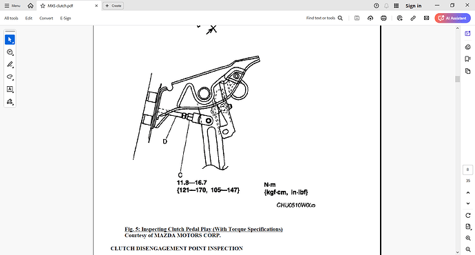

See how I adjusted clutch pedal in 2019, step by step with a few relevant pictures. No need to remove seat.
I needed to repeat this recently on my 25AE.

Still a bit unsure on the procedure. You say loosen the 12mm lock nut, clockwise, away from the bracket. OK with that. Your step 8 says ‘wind out the pushrod a whole turn’…so that’s clockwise, yes? How do you do that - is the 10mm nut I see above the lock nut on your picture fixed and you put your spanner on it to actually turn the pushrod in or out?

Unlock nut “C”
Unscrew rod “D” ( 1/2 to 1 turn )
Re-lock nut “C”

As with Richard’s post re adjustment of the clutch travel follow that, no need for seat removal. Push the seat right back on the rails and place a small step/stool, ideally the same height as the door sill, against the sill and you can use this to balance your rear end on whilst laying on your back adjusting the pedal travel inside the footwell.

Thanks MickAP, sorry to be a pain (and possibly a bit thick here!?) but these posts have confused me again. Not quite sure of the distinction between ‘pedal travel’ and bite point height. CBRDEANO puts it nice and clearly in three steps, which mirrors what the guy on this Youtube video demonstrates Clutch Adjustment On NC MX5. At the end of the day, it’s the clutch bite point I really want to raise up a decent amount.

That adjustment as Richard explains you need to loosen off the lock nut on the rod larger nut, then twiddle the rod or smaller nut (10mm) around one full turn. This should bring the clutch bite point or as also explained the pedal bite point position off of the carpet, the whole reason for the adjustment.
Be careful not to adjust it too much, it needs small amounts at a time. You may have to get under there to adjust more than once.

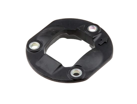

After the clutch bite point - I also changed the limit plate.
Not sure what mileage you have on but at around 78k - my limit plate was worn.
The 1st to 2nd shift felt better after changing it.
