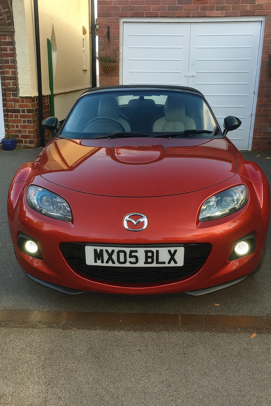

I have fog lights which maybe could be used as drls?
I have the same as Richard in the post below .
Have a look at the CarbonMiata ones, at £115. Will fit Nc 3 and 3.5 without any modifications.
I’ve an NC 3.5 though, will they fit. Thanks
You say you have fog lights already for the ones I mentioned in the post and referred to Richard’s post will fit your car , not sure about others
Edited
Thanks for the info on these vinstar units. Do the light units replace directly with the oem fog lights without and crafting of the unit holding assembly. Presumably the control boxes sit in the engine bag somewhere or is there a better place to put them?
Thank you for your patience.
Ian
Hi Ian. For an model 3.5, those vinstar units will probably need a little bit of fettling. They’re designed to be a straight fit for the 2.0 model. But it only needs a bit of the existing plastic surround on your fog lights cutting away.
In use, I love the Vinstar DRLs. I’ve had them fitted to my 3.5 for about 18 months now, and they certainly make my car more “visible” to other road users.
