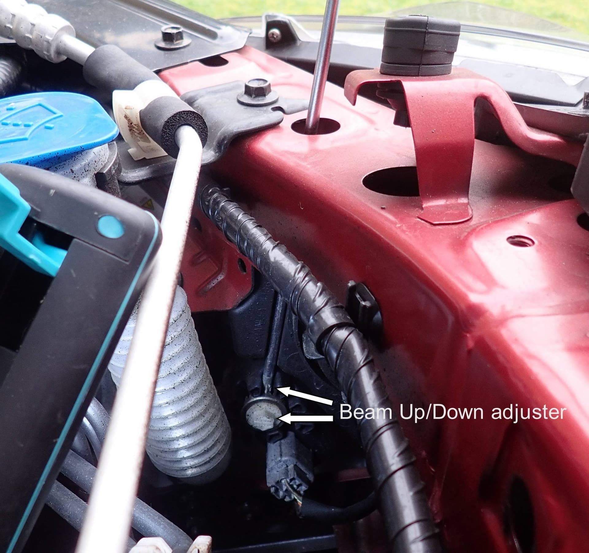

Our 30AE and a friends experienced the same ‘flashing’ issue. If you are confident that you are using the system correctly, as we were, than you can adjust the level of both headlamps very easily.
This Manual pages - MX5 Manual | Mazda MX5 (Mk4) 2015+ explains all you need to know. So as not to overcomplicate things just park a few feet from a wall or garage door, turn on the lights and then ‘twiddle’ the adjusters to lower the beams so they are lower and even. If you are still getting flashed drop them a little more until you achieve your objective. It is not difficult and only takes minutes once you have found the adjusters and how they work.

To begin with from new we were being flashed all the time even though I knew it was dipped!
I took it back to the dealer, and they showed me it was set exactly as specified, and adding three beefy mechanics in the back it adjusted itself correctly.
I checked it again when home and set the beam down a little bit with the adjusters on the back of the headlights, not much, but closer to traditional. Now we are very rarely flashed. And the MOTs are passed, no problem.
The ND has similar adjusters to this, just not so accessible.
