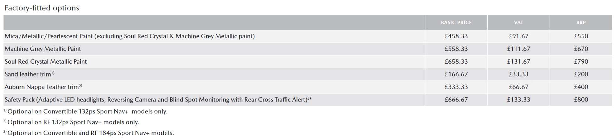

Does anyone know if my MX5 has the ALH or AFS? This is so confusing.
2 Litre RF MX5 2017 Sport Nav. It might have the safety package as it has the rear-blind sport assistance.
Thanks.
Start the engine at night with the headlights on auto and watch the beams. If they move up and down it’s ALH if they move left and right it’s AFS. I think a 2017 might be too early for ALH.
Yeah I think you are right. Still I was shocked at how good the lights are on the ND1. On full beam they do light up high and to the side. I cannot imagine how good they would be on the ND2. My car does come with the safety pack.
In the in-car menu I can see options to turn off HBC and AFS. I guess the AFS is the moving left/right headlights. So in models with ALH I assume there is an option showing the potential to disable the ALH?
