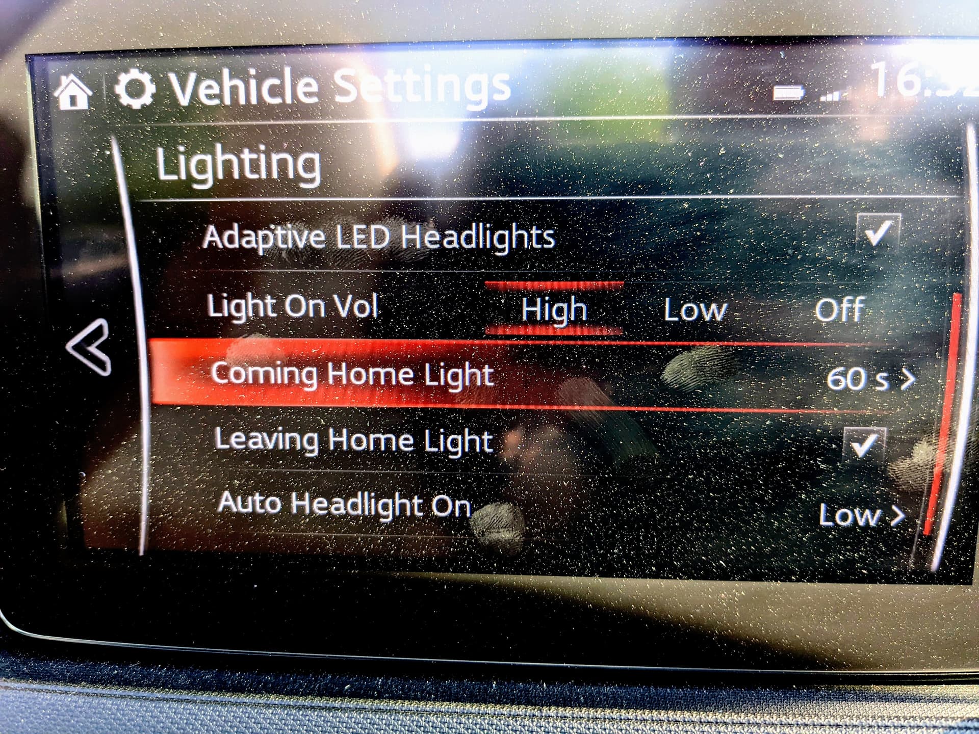

This is the settings menu on my ALH car, don’t know if the AFS has this “Adaptive LED Headlights” option shown at the top of my screen too? Might be an easy way to tell definitively (you can also tell from looking into the headlamp itself but it’s quite nuanced).
Yeah thanks for that. So that confirms it. On mine it shows seperate tick-options for HBC and AFS.
One thing I am going to do is un-tick the AFS option one day and see what difference that makes to the lights.

Can somebody explain what the “Auto Headlight On” options of “High, Medium and Low” actually do. Do they just determine the level of ambient light which will just switch on the headlights when on “Auto” or does it determine the sensitivity of the “auto dip” feature of the headlights when on “Auto”? If not, can the sensitivity of the “auto dip” feature be changed. In my experience the “auto dip” feature is far to slow in activating when there is an oncoming car (especially when it is coming around a corner on a country road. I inevitably use manual dip to dip my headlights to prevent my very bright LED headlights from blinding other drivers.
In theory disabling the AFS just stops the corning/steering function of the headlamps, shouldn’t make any other difference.

Yes, just determines ambient light level required for headlamps come on and go off, mine is set low.
