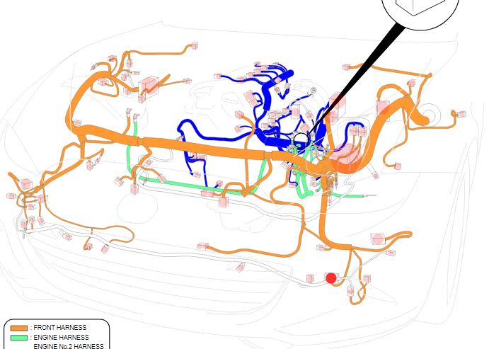

The left front indicator and side indicator share a ground in the left front bumper chamber, see the red dot on the diagram below, other systems share that ground point too, but have you checked it? Was anything done to the car prior to the fault happening or did it just happen?

@Roadster_Robbie suggestion of the front earth point is 99% going to be the problem. The clue is in the rear indicator glowing. Current flow from whatever other circuits use the earth point is feeding back through the front indicator earth wire.
Thanks for the info mate. Looks like the ground could well be the problem. I’ll be looking into it this week.
Hi guys,
The issue was indeed caused by a faulty ground. Thank you very much for pointing me in that direction @Roadster_Robbie . The connectors were quite corroded so we sanded them down and dipped them in vinegar overnight. After putting it back together the indicators all work as they should. I have also put the original bcm back in the car.
