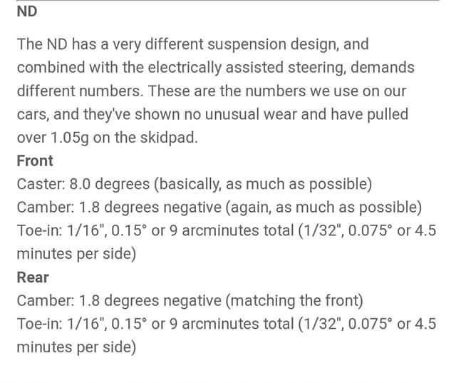

Yeah I came from an NC to an ND and get the same issues. You have to be driving them pretty hard to notice, but the issue is there. I have no confidence in the rear end and it turns in so sharply.
The car did it standard, now has Meisters on and the Flyn Miata alignment specs and still the same, maybe slightly better.
You are on zero front toe, I have a little toe in, I think Im going to try a bit more front toe in to try and calm the initial turn in and therefore not give me that uneasy feeling.

geo - pretty much same as what Blue has quoted above. theres a few variations but all roughly the same.
except for caster… i had that at 7deg which was the most my guys could get, and that was rubbing the arch a bit. so dialed it back to about 6.
camber wise, i am very lowered, but 1.8 was the max we could get. (as per above specs).
Perfect so your running a bit of toe in on the front as well?
Did you import your throttle body from Fab9 or manage to find a UK retailer? Was it the Bosch unit you went for?
toe - yes. as per above specs. (*or as close as the alignment guys could get).
