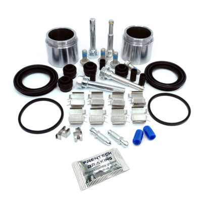

If you do go down the caliper rebuild kits - I can recommend the Frentech kits

Frentech Brakes
