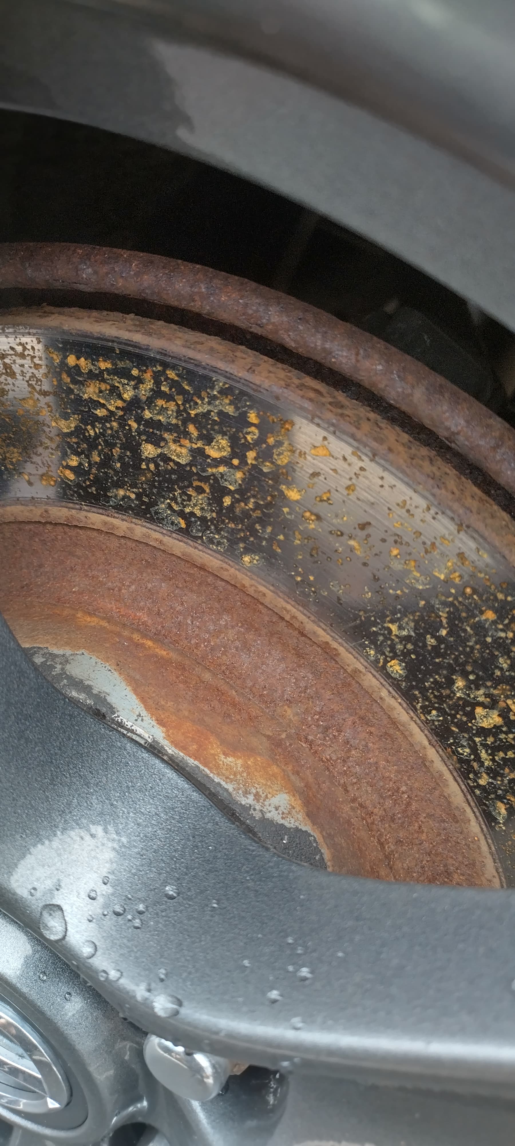

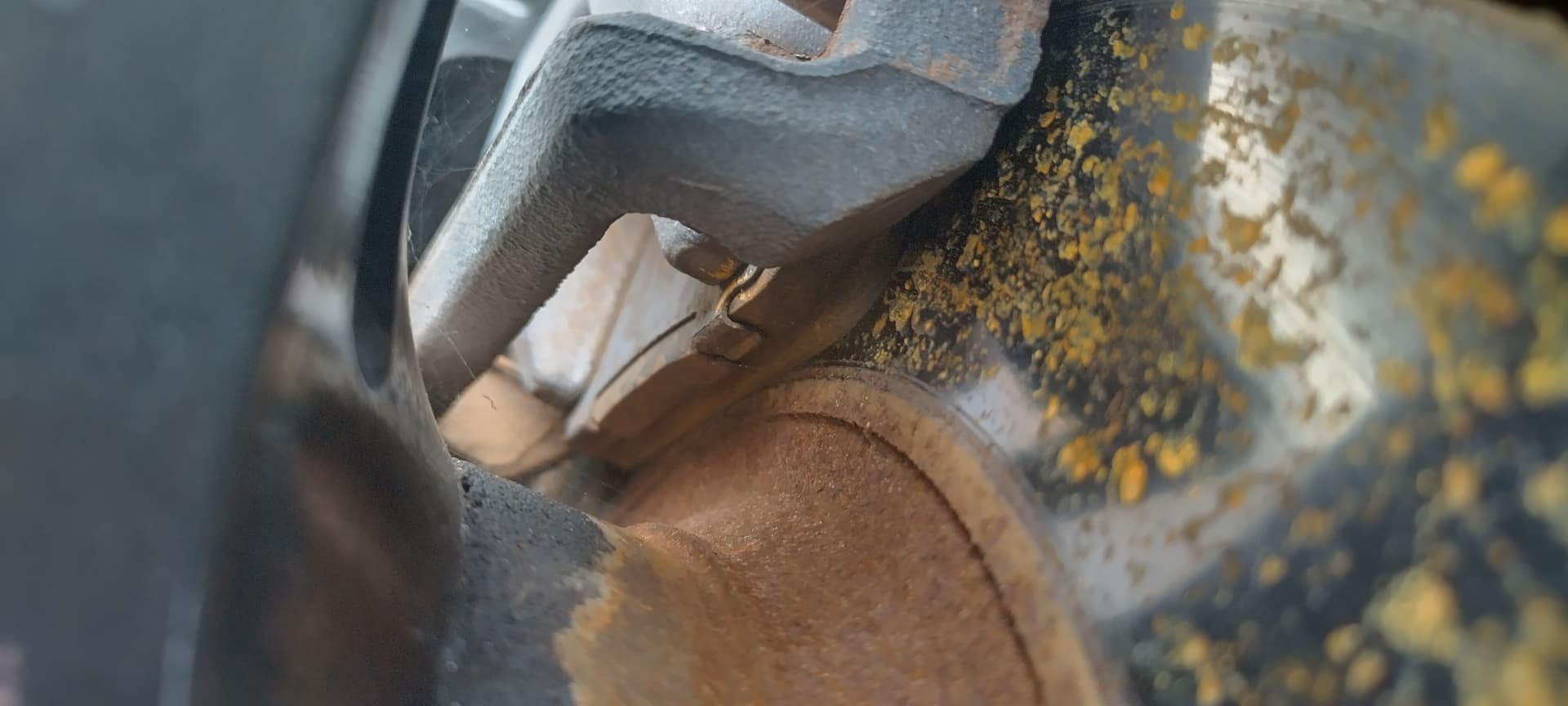

I’m just wondering about the condition of the rear wheel hubs. As I’m about to put the car in to get the tyres, brakes, dust shields done tomorrow… Is there a way to get rid of and clean up the rust from the hubs themselves?
They look pretty shabby and it would be nice to get them looking new again if possible.
I had a look on you tube and it looks like you need to have at it with a wire brush and light sanding disc.
I’ll ask if the garage in the morning if the wouldn’t mind buffing it out real quick. Might be an idea.
Quite easy to give them a quick clean up and paint

I can always ask if they could give it a quick spray. Worst they could say is no.

I thought the part you’re asking about is part of the disc?

If you are having the Brembo discs fitted to the rears (as mentioned) mine came already with a paint protection. That rusty part you picture is part of the disc, some do rust badly if unprotected but if changing no need for painting.
its platina… dont worry about it
Its probably self explanatory but dont put spray any oil or grease or similar onto the disk to try prevent corrosion and contaminate the pads.
