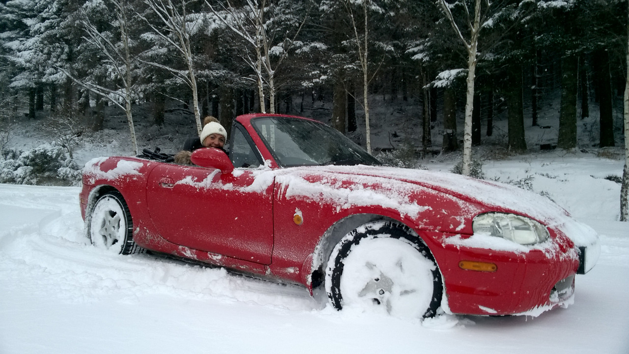

I’ve recently fitted a pair of A005 Weather Control tyres on the rear of my Mk2. So far so good, I’m very happy with them. I run my car over the winter months in Scotland, so always fit winter tyres all 'round (I have a spare set of wheels for this). The only time I get stuck is when the drifts are too deep to get through…I don’t expect the A005 to be as good as a dedicated winter tyre in the snow, but it will certainly beat a summer tyre in cold/slippery/greasy conditions and is clearly very good in the wet and dry. Well worth a try I’d say!
H’mmm - no sign of tyre tread marks in the snow - - - - ?
Tyre marks are quite plain to see on my screen - have you got the contrast on yours adjusted correctly?
