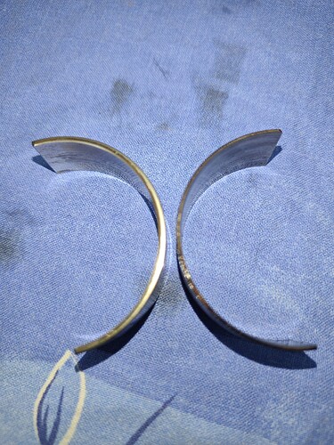

Now to the best part. Took off oil sump and found some metal chips in it as expected when you have rod knock.
So checked very first rod and there you are play all the ways.
Took bearing out and it was left nearly 1mm thickness of it. Seem that oil passage was dry possible blocked and bearing was spinning rounds hence damaged crankshaft.

If it’s knocked a big end out make sure you check the rod for ovality.
Also personally I don’t grind cranks but opt to replace due to big end bearing not having any location pegs and the shell been the weak point
Well yes it was messed up well on the first cylinder big end bearing was running on 0 oil so it was spined around scuffing rod oll around it. When I checked bearing it was nearly 1mm thickness.
Because rod has been damaged ill have to replace all 4 of them. Not good option but it is what it is.

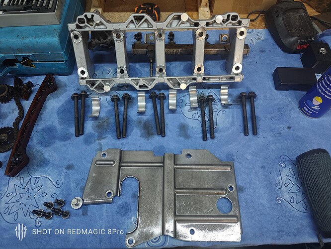

While waiting for news regards crankshaft today was may washing day.
Also I couldn’t resist to prep few parts for painting. I was thinking about yellow same as gonna be callipers. But for now only this much I have to share.
After painting and installing in the car I bet it will add at least 20 hp :slight_smile:

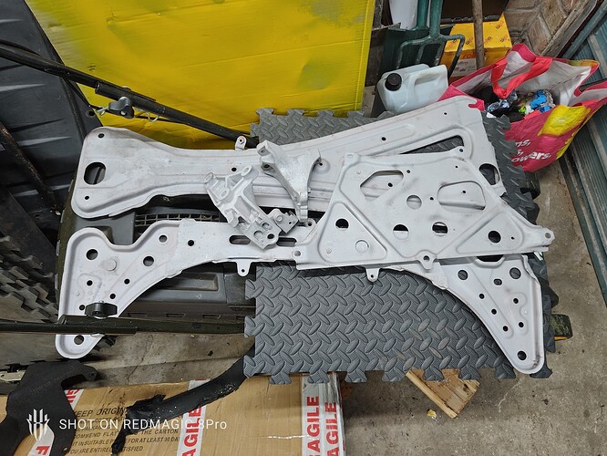

2. Engine case and gearbox arrived from sandblasting.
As well as some chassis cross members.
I thought parts will look more polished :slight_smile: but now they look more like primed.
I guess now I gonna have to paint them otherwise all the dirt will stick like crazy to parts.
