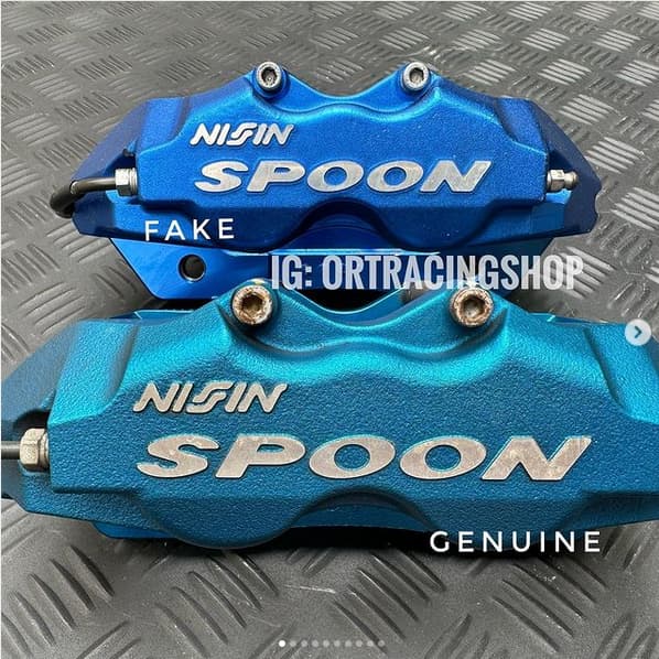

The reason why the OE marks are not visible on a pattern part is because a pattern part is not a fake or counterfeit parts. Its not being sold as “genuine Mazda”. In fact, if one’s only check if a part is genuine or not is because of the existance of a casting mark, one could be in trouble.
