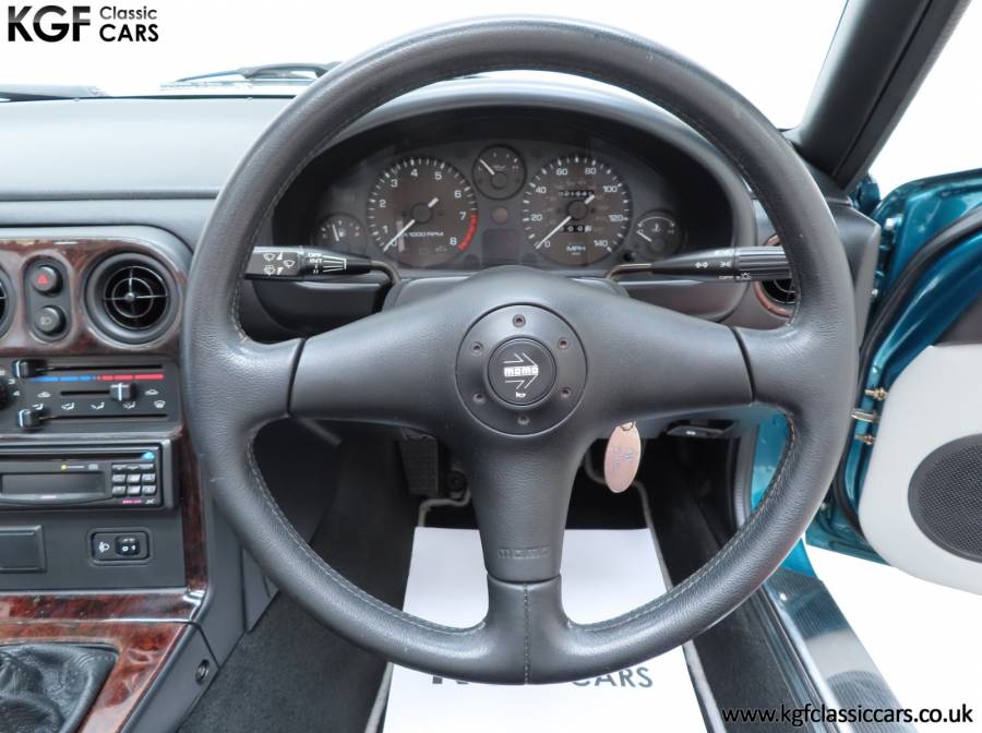

This is my later 1995 N-reg S-Spec 2, with the standard non-airbag Momo. Note the bent, or dog leg stalks, which should be present on a 1997 V-Spec.
