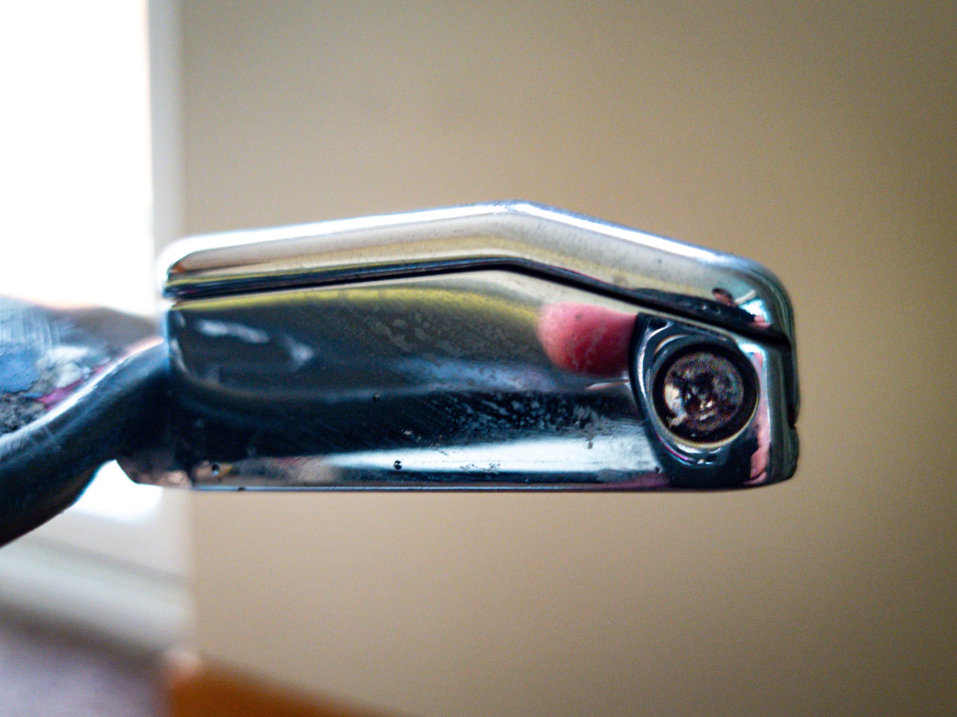

Has anybody got any ingenious ideas to get this screw out on the hardtop frankenstein bolt holder thingymajigs?
I’ve tried brute strength and I’ve tried heating it up and then brute strength, no joy as of yet.

Two things, those screws are treated with blue loctite on assembly that’s why they are difficult to shift. If you’re lucky releasing fluid may dissolve this and make removal easier. I use a mix of acetone and auto transmission fluid and the acetone may help dissolve the loctite over a period of time. Secondly I bet you used a Phillips or Posidrive screw driver? Mistake… those screws are JIS (Japanese Industrial Standard) heads and the normal cross headed bits will easily cam out particularly if the screw is tight. I think you need a #3 JIS bit and an impact scew driver may help. Best of luck!
