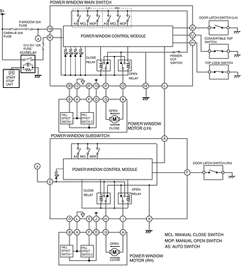

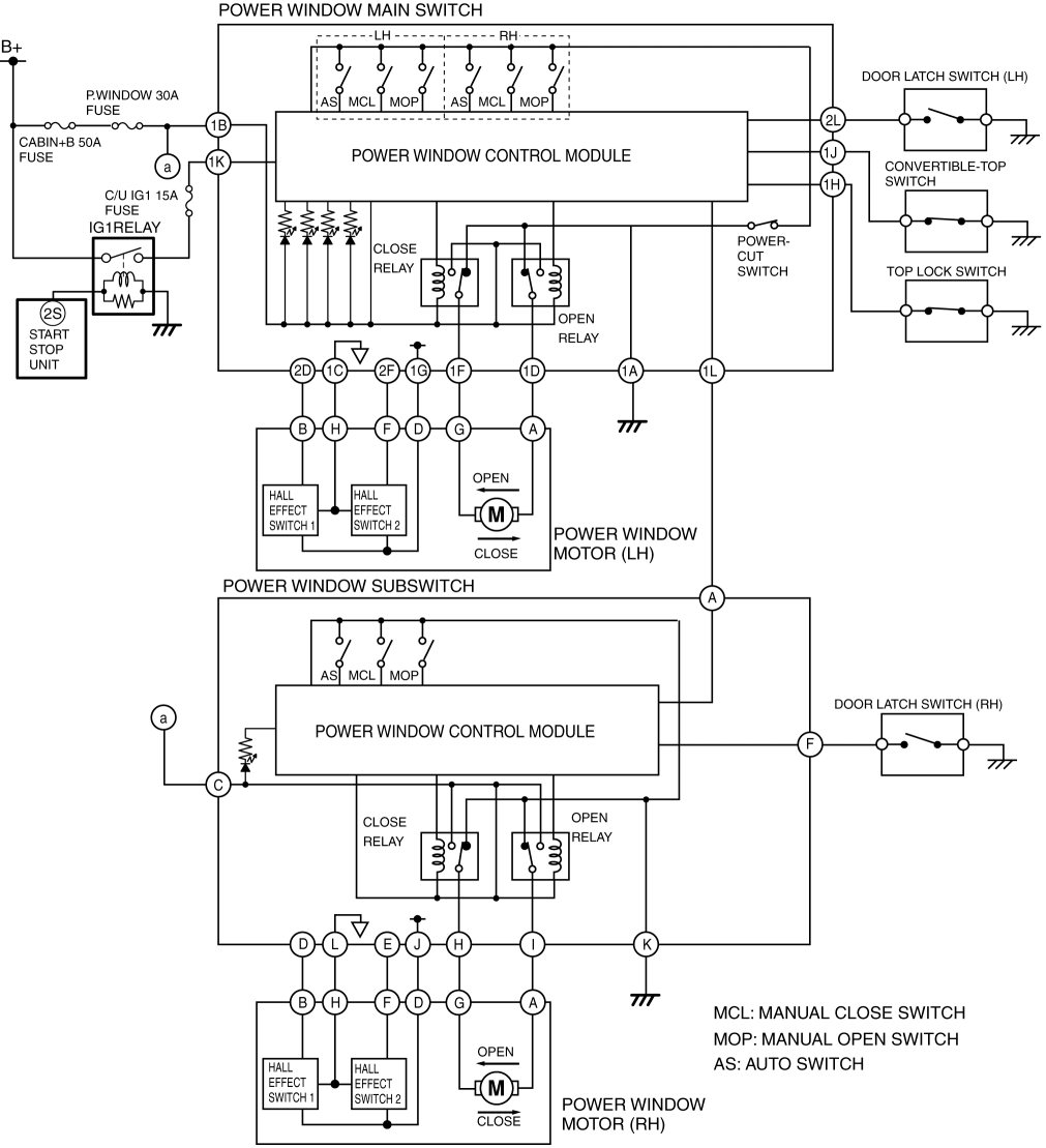

Regarding the idea of replacing the ECU, I don’t really think it has to do anything with it as in the wiring diagram the power windows are in no way connected to it. There are only two control modules (one on the driver side and one on the passenger side) with only outside inputs being the door and top latch switches.
In my opinion it’s either the issue with the control module itself (chip) or in the HAL sensors on the window motors.
