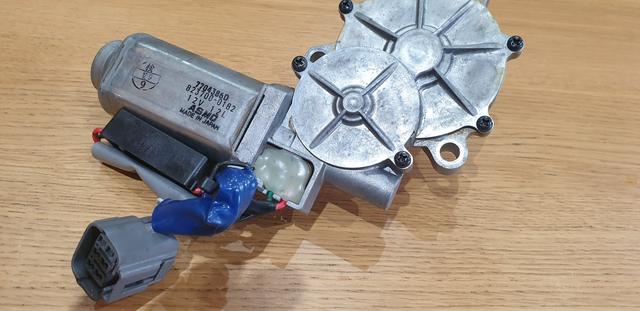

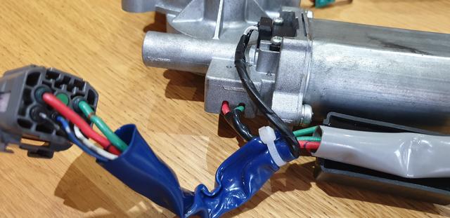

In the last picture the Red and Green high current leads to the motor go via a grey plastic sleeve in a black cover box.
Does this contain a one-shot thermal fuse? Or a surge-limiting resistor?  Or something else?

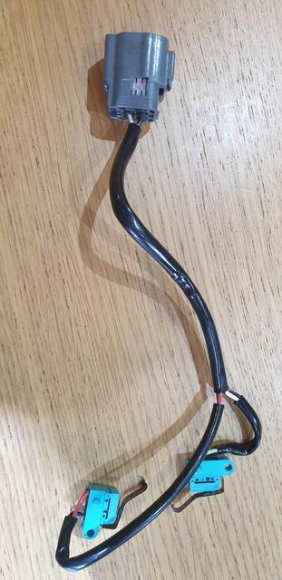

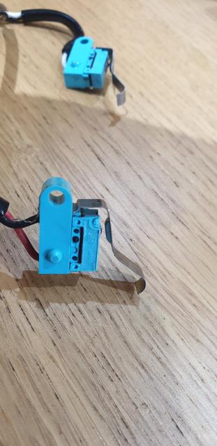

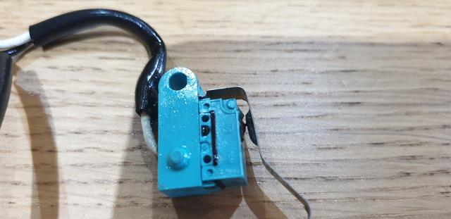

Might be the angle of the camera Barrie but the gap between the metal strip & the button (or contact?) on the switch with the white wire appears to be significantly less than the gap on the switch with the red wire?
If the switch with the white wire controls the failed motor, I wonder whether that switch has failed to open properly, causing motor damage (as per RichardFX’s suggestion that the motor failure could possibly be the result of switch failure)?
Andy, you’ve won first prize in the spot the difference competition  very observant of you and TBH, I leapt at that too, as soon as I got the old harness out of the box. Turns out it was just some spray residue (WD40 or something) but I took the pic before investigating fully, the other switch was as clean as a whistle! Ironically, the ‘dirty’ switch passed the multimeter test and the clean one failed?  They are momentary switches rather than a proper on/off, they don’t click, just depress the contact to make(or break) the circuit. Good spot though mate, appreciate that you’re on the case, as it were  it’s quite likely that switch may have affected the motor though. Away from its position in the car, I’m not sure about the orientation, which is top and bottom positions for these switches, glad I wasn’t refitting them  been into garage this morning and opened roof, absolutely fine, no issues

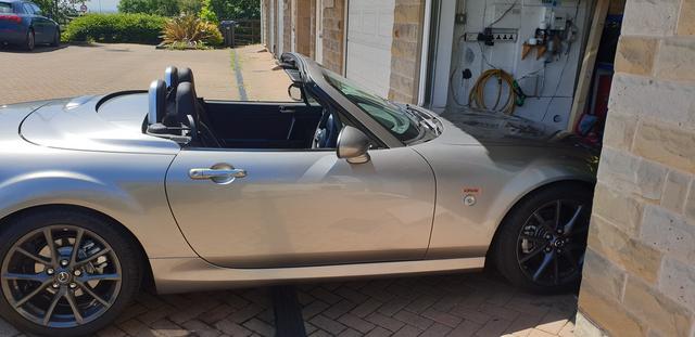

Here’s roof up,

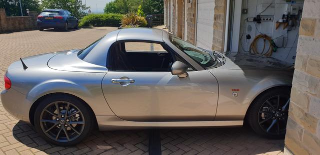

Roof down,

We know you have mastered lifting dropping the roof the manual way these picture prove nothing…we need video
HaHa, very funny  I’ve all on doing pictures on here Bruce! Plus, it would need two people, one in the car raising and lowering and another filming? Hmmmmm, you never know though?  I knew I should have date and time stamped the pics, less than 20 seconds from roof up to roof down. How much more do you want?  Couldn’t do that manually in that time, I’m good at it but not that good!
