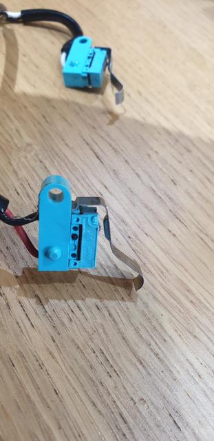

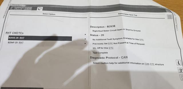

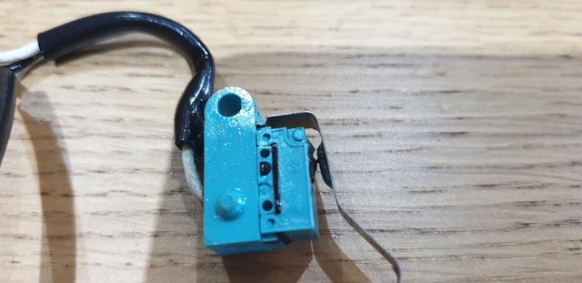

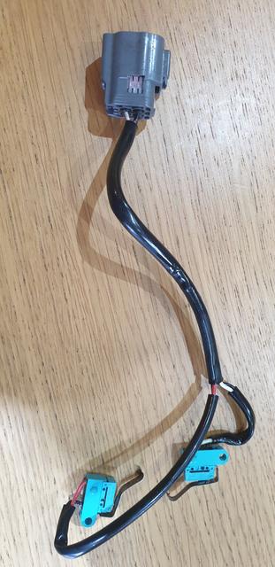

Back from dealership  OK, went in to reception, car was waiting for me and invoice prepared with attached diagnostic report, my complimentary vehicle health check report too!  I asked to see service manager, no problem, we went to the car and chatted, the old parts were in the delivery box that the new stuff came in. He didn’t know why the diagnostics hadn’t picked up on the microswitch, only the motor? Anyway, all good now and working nicely  I guess that’s the main thing. He admitted that they’ve had a few switches go but never a motor ( at his dealership) not to say it hasn’t happened somewhere else. Bill paid, I was on my way home. Report says roof position error, Also, motor open circuit or short to ground. Sniff test tells me nothing  no burnt smell or whatever. My very, very limited knowledge got a reading out of one of the switches on my multimeter but nothing from the other one. Leading me to believe that one of them was indeed faulty. I also, didn’t realise that both limit switches are on one harness and plug? Still not £170 worth though

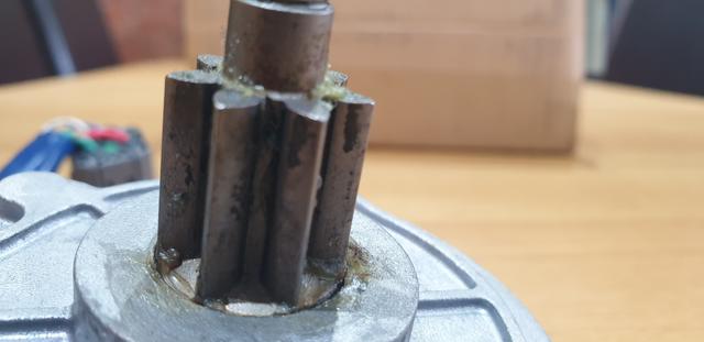

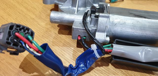

Very little wear on the pinion in that last pic, which is good as I’d read of wear issues but probably more one the gear sector itself due to the silver hex nuts being loose. I advise all PRHT owners to check their nuts as it were . Easy access by raising rear deck panel, switch off ignition after pausing the roof cycle, then you can get straiget at the silver bolt.  I got the service manager to take a picture of the motor before I left the dealership too, for his own reference. I suppose that just leaves the checking of the motor, there are two thick wires, a red and a green one, also three thinner wires a white/grey, black/grey and blue grey. I presume the two thick wires are for power? They all go into the motor at some point.

That motor looks like the one associated with the chrome dome Allen screw accessed from under the rear deck panel, but maybe we should put this one to bed and put it all down to experience.

Mr Blue, thanks for that  not certain about the micro switches, the replaced one i have is a two switch mini harness? Does the plot thicken or are there more switches lurking? You were indeed very fortunate in having the services of such a tech guru as Roadster Robbie, excellent that yours was fixed easily enough too!
