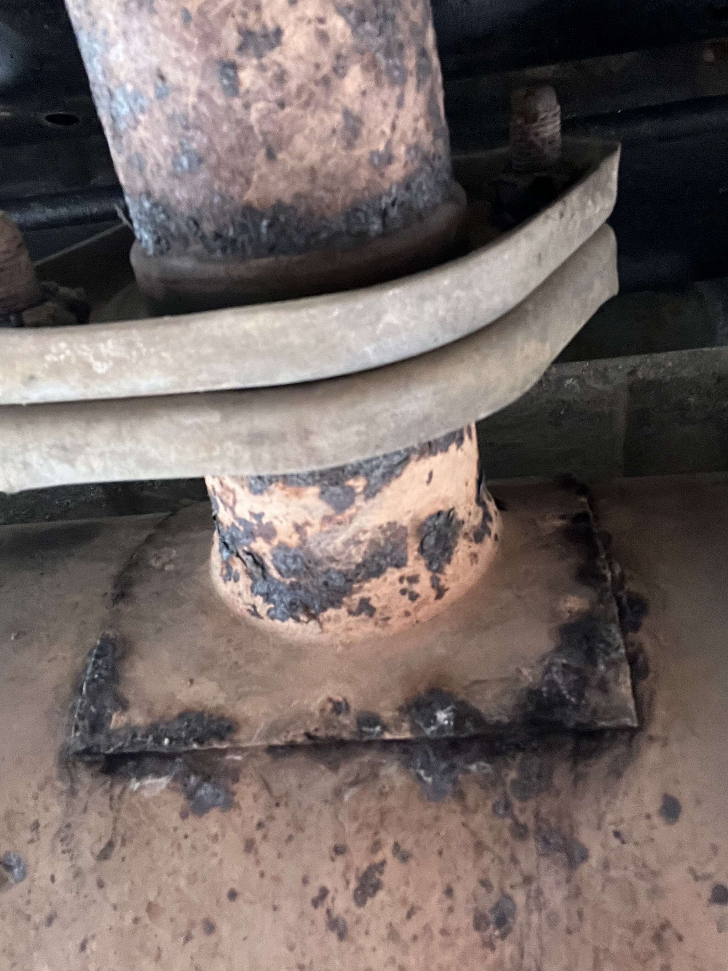

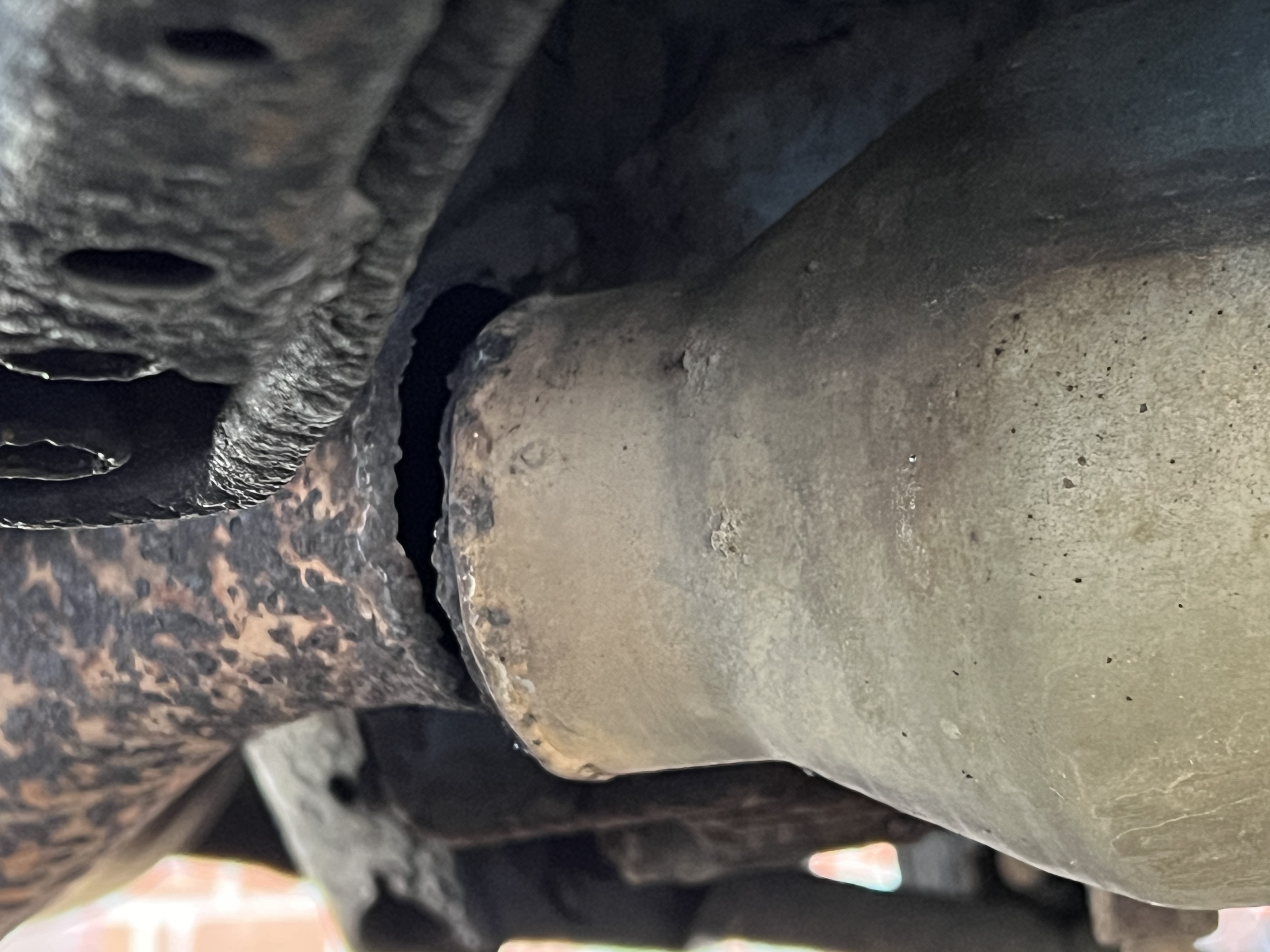

Hello all, the exhaust centre section sheared at the weekend and it looks like the MX5 Parts centre section will sort this, however it looks like the backbox has previously been patched up and I suspect it won’t last too much longer, so replacing this at the same time may make sense and an easier job.
I want a stainless steel part, but don’t want to increase the sound. Are there any good options that will just give me a longer lasting part - and one that I can get hold of now (ie: the Cobalt one seems to be forever unavailable)? Around £300 seems reasonable - is the MX5 Parts one any good or any better alternatives, please?
