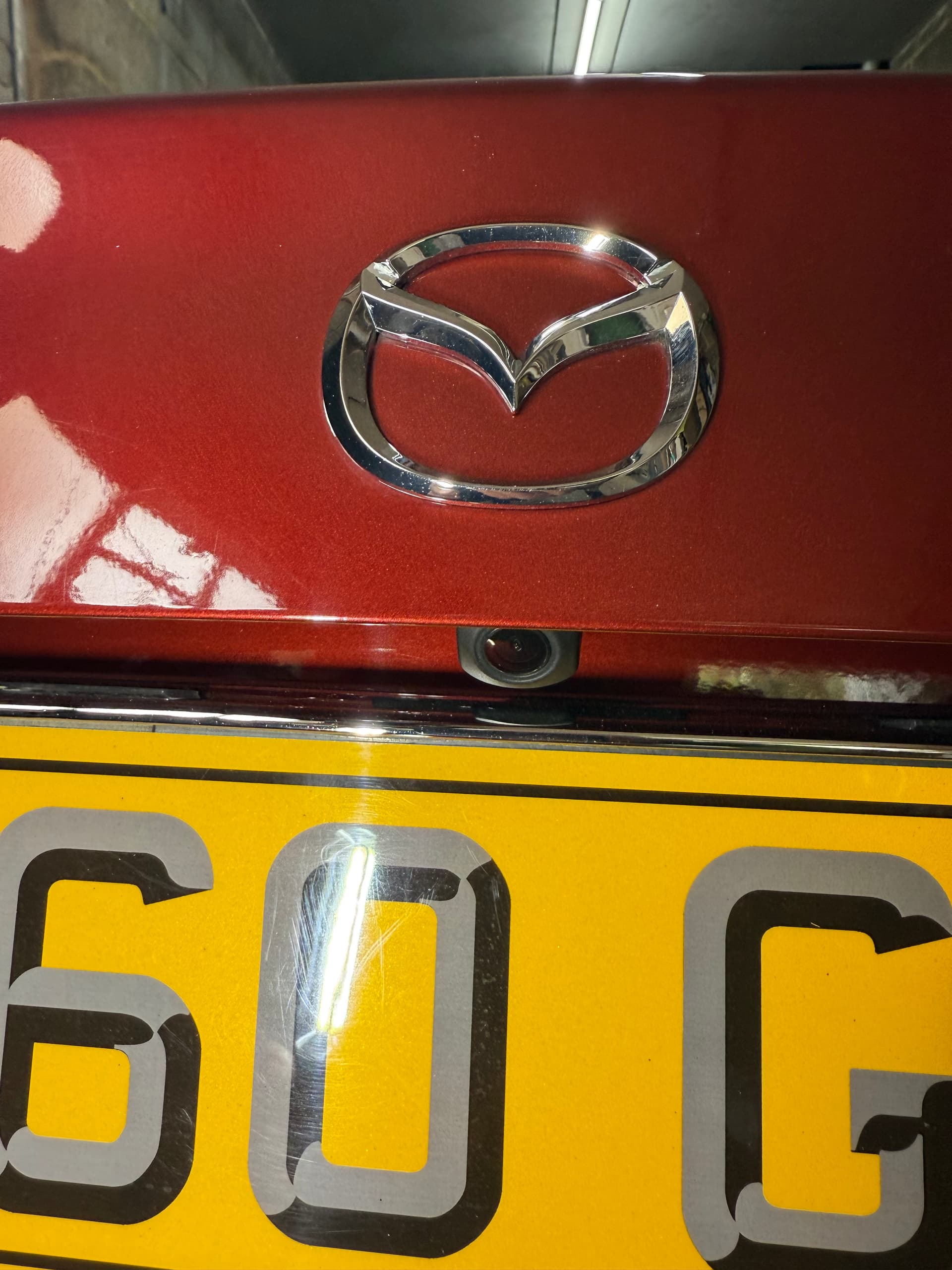

Here’s what I did with my 25AE, hardwired all the way, no new holes drilled, and still with a watertight boot. This replaced the radio camera I’d fitted earlier and now uses the head unit instead of the satnav.

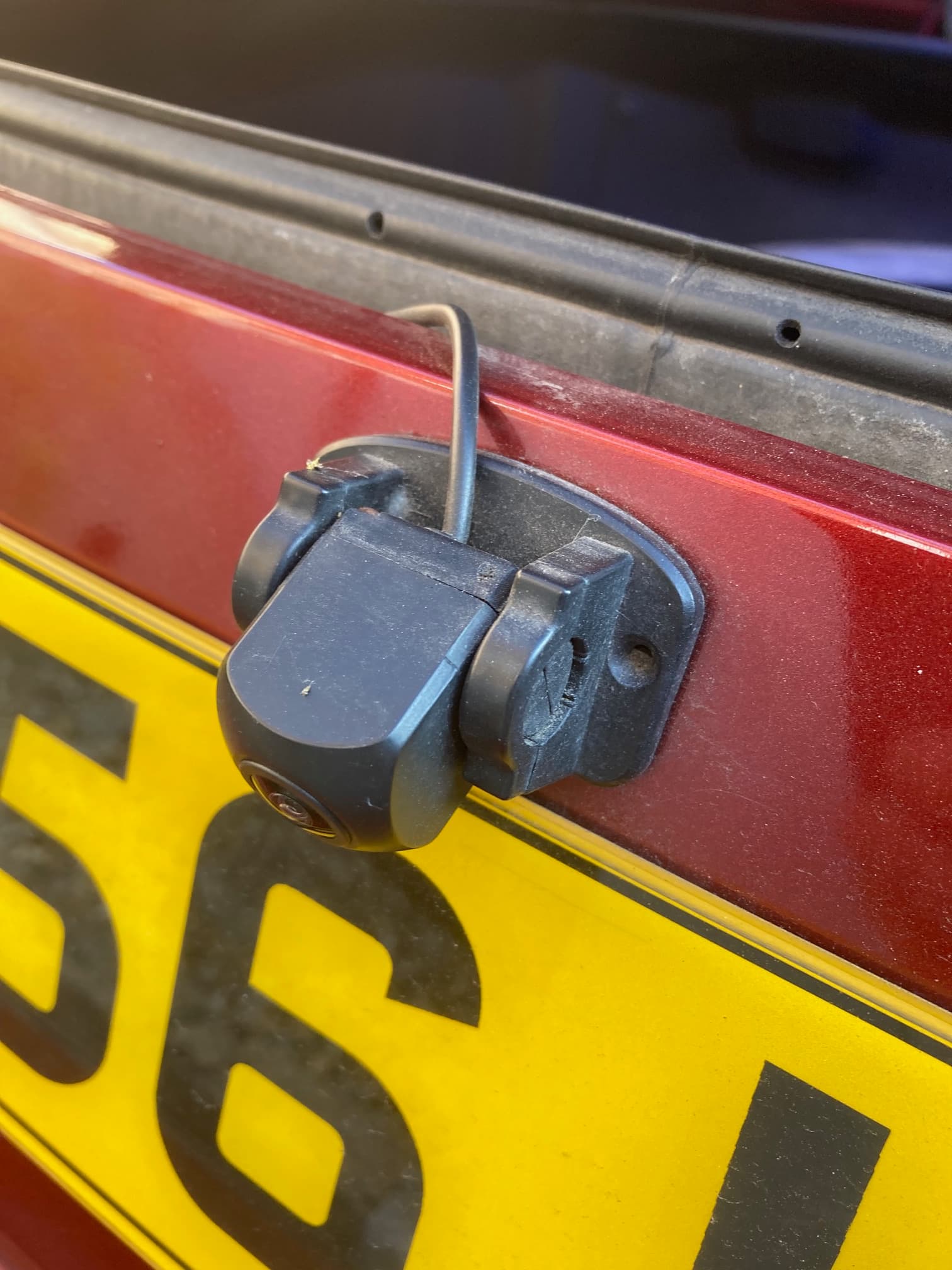

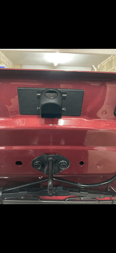

I definitely recommend fitting one. I’ve got one on my NC and wouldn’t be without it. I fitted my camera under the lip of the boot just above the number plate and fed the cable through a rubber grommet behind the bumper. Very easy job to do.

Did you drill any holes to mount it or just use adhesive ?
Camera is attached with double sided badge tape. I did have to modify the mounting bracket a bit to get it to point down.

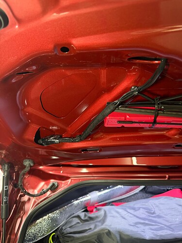

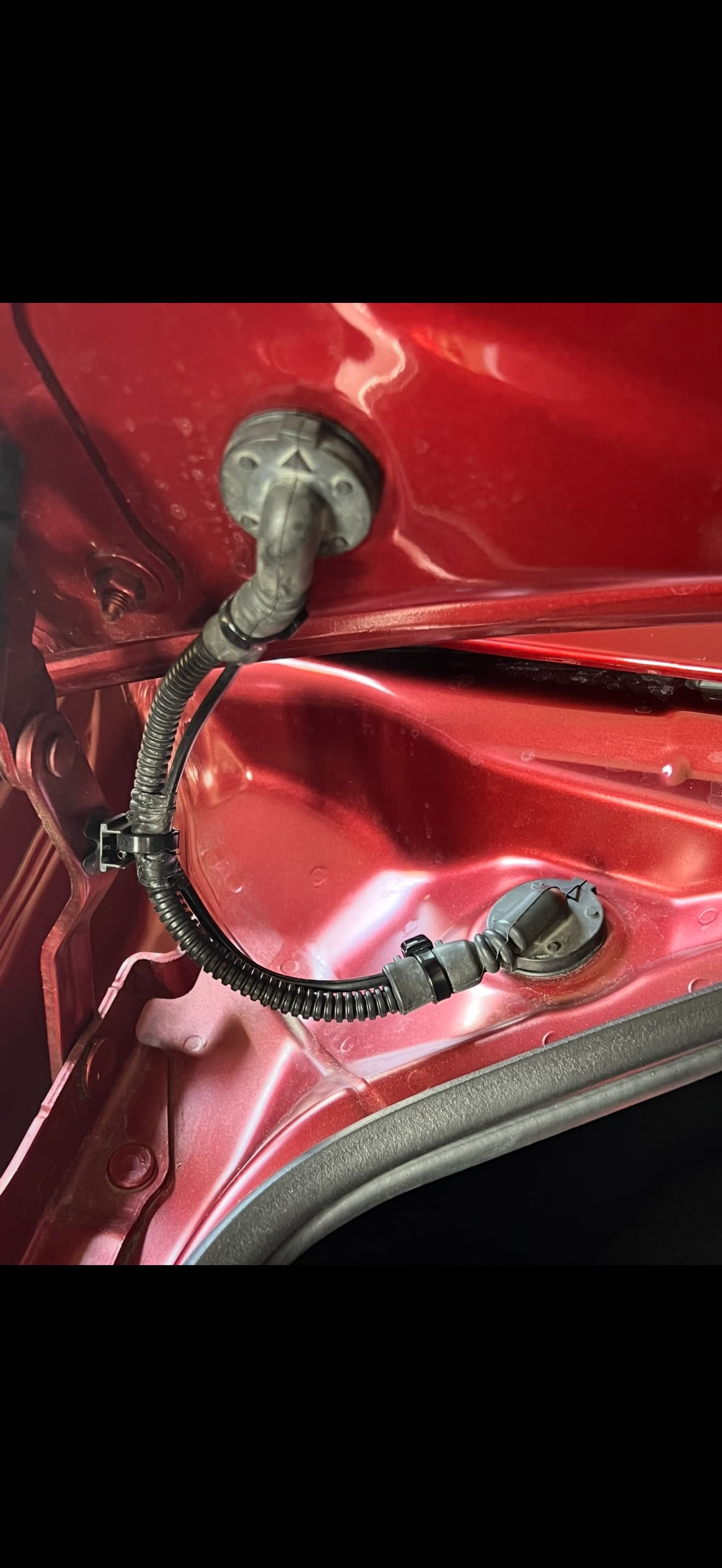

I removed the grommet from inside of the boot, took the top bolts out of the bumper and dropped the cable down behind, no need to remove the bumper.

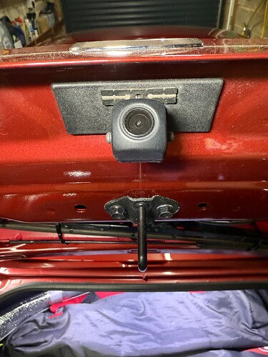

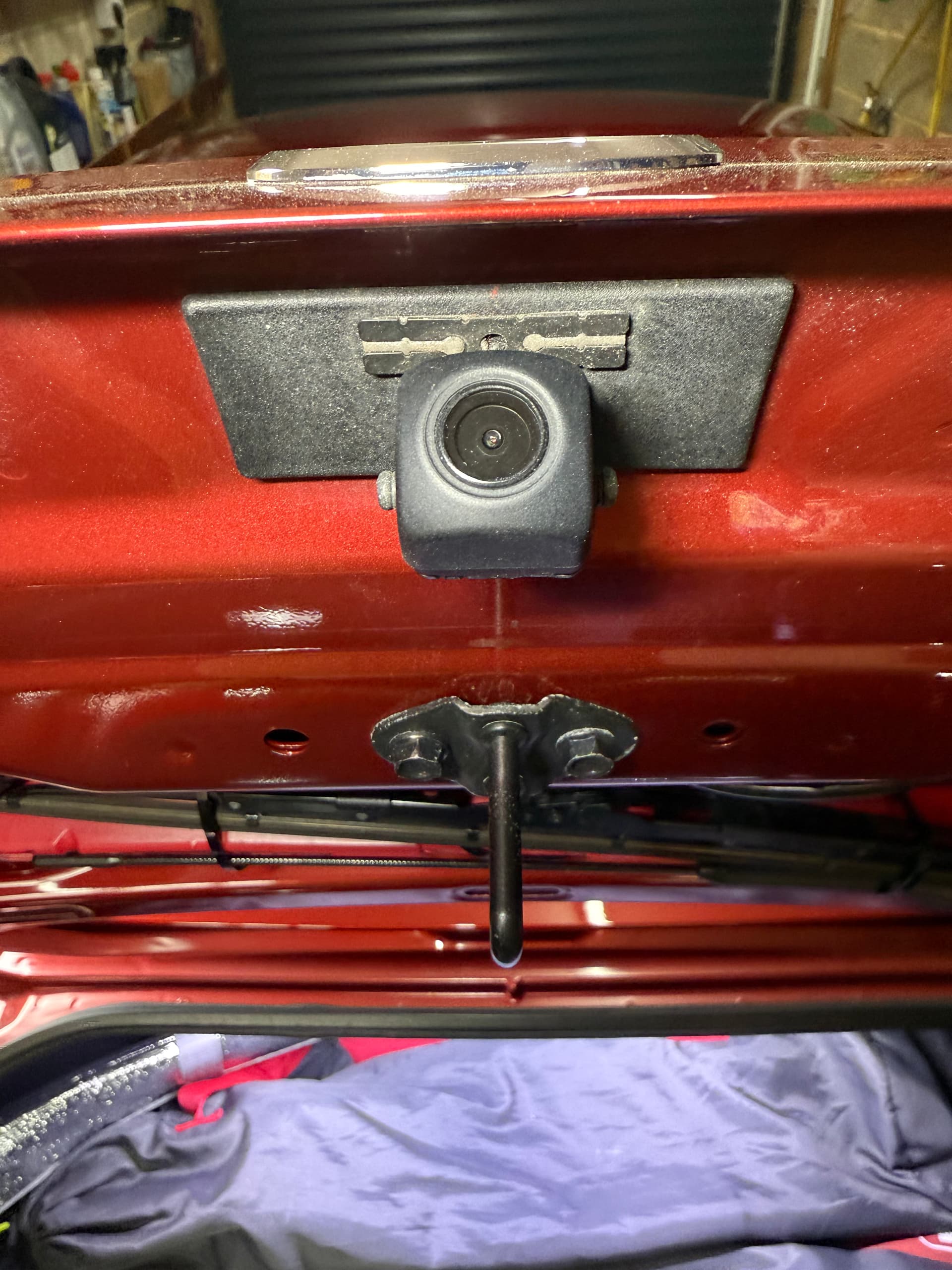

Thanks and where did you mount the camera itself ?
Screwed and sticky pads onto the plastic blanking plate.
Cable routed as photo’s.:+1:
