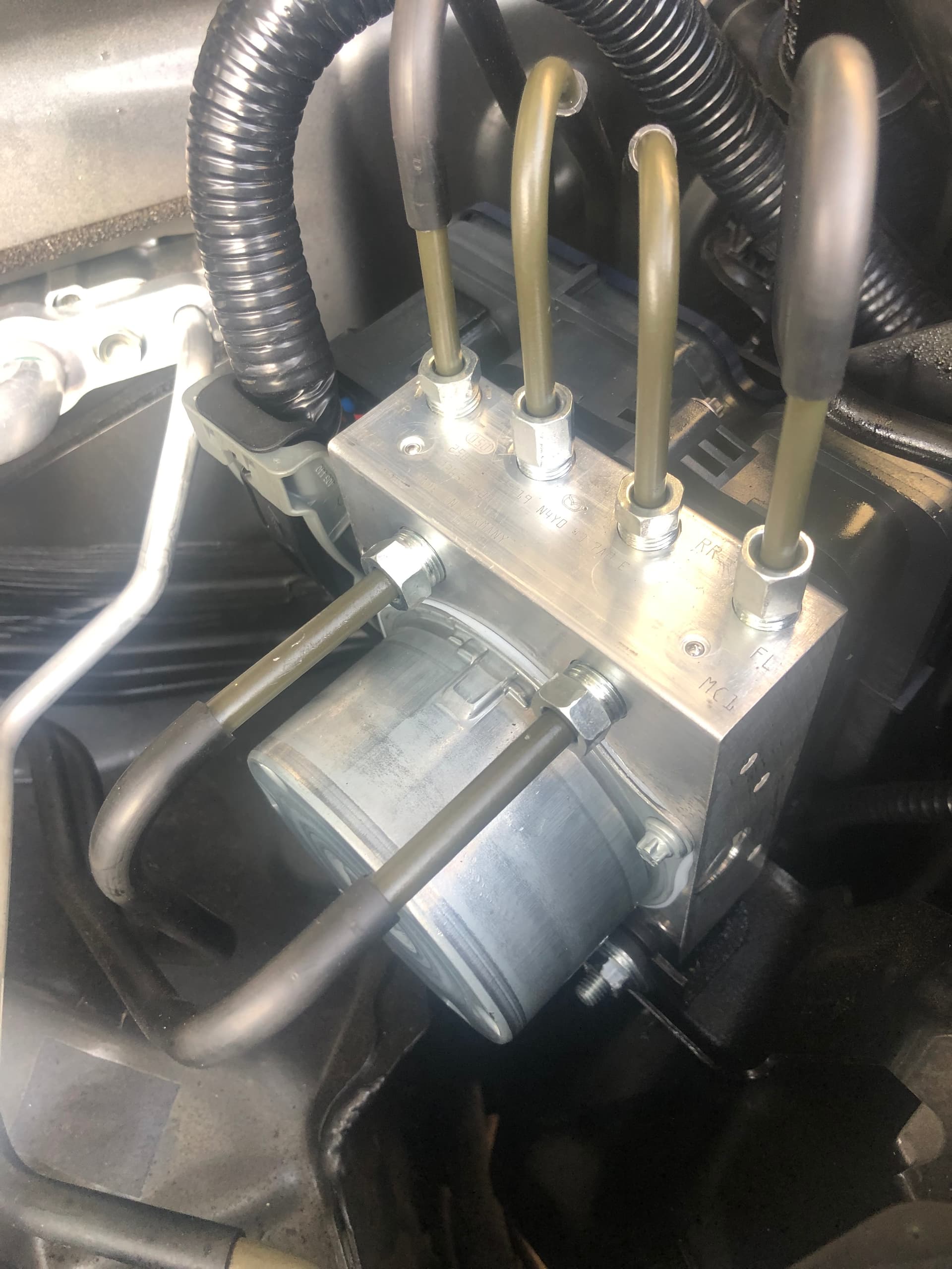

Car went in today to fix the problem. Software update, replaced the physical gizmo (up near the back axle apparently) and bled and replaced the brake fluid. Took about 2.5 hours. Car washing session tomorrow before winter hibernation.
Who told you this? It’s under the bonnet on the passenger side just in front of the bulkhead.
Interesting! It was the person on the service desk at the dealership. Just glad they weren’t doing the job then! Is this the component below?
