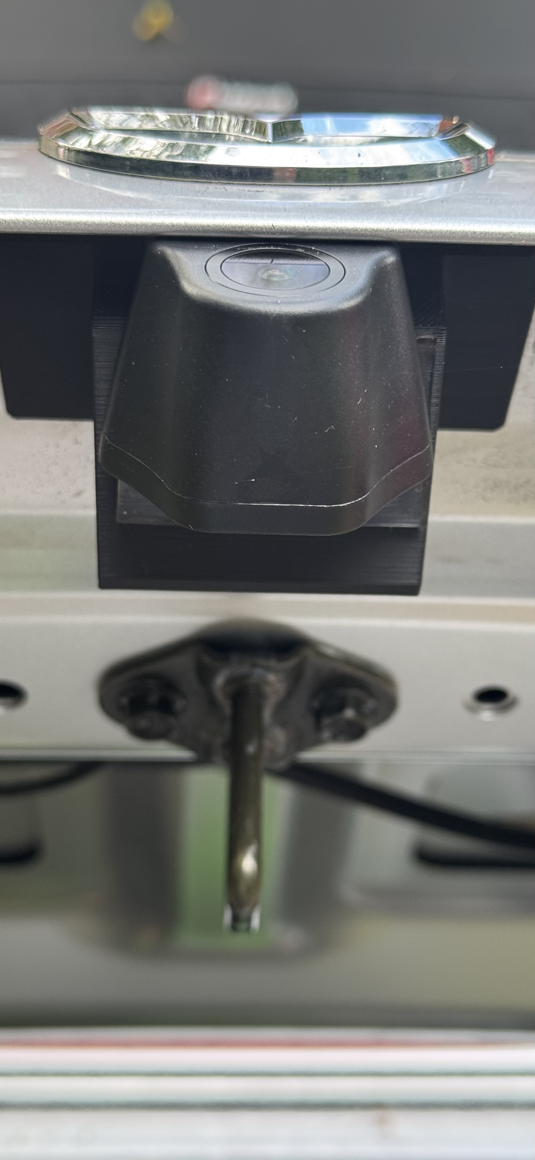

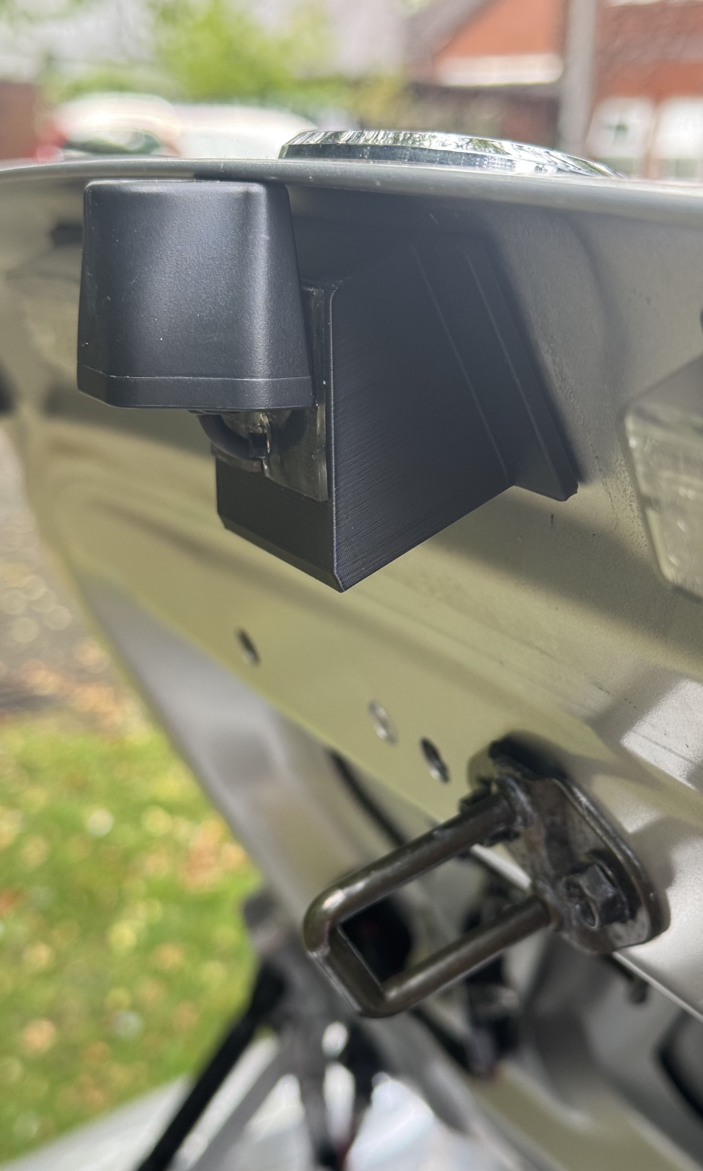

I’ve a 2006 MX5 NC and was wondering where to install the rear camera. Above the number plate meant drilling holes which I wasn’t keen on. I came across this YouTube video for mount for underneath the boot lid. https://youtu.be/pL56XR_ucHs I followed his download link for the 3D Model and uploaded the files to SURFACESCAN in the UK.
As you can see from the photos it fits perfectly.

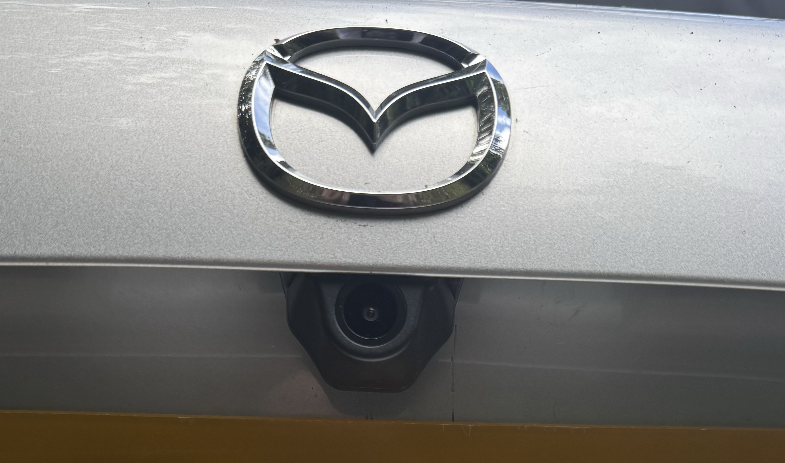

My Motorsport IL camera is mounted in the position recommended which is directly above the number plate on a downward facing portion of the bumper, so even if you make any drilling errors they will not be apparent. The camera is unobtrusive and gives a good rear view for parking. The kit comes with a gasket to create a seal between the camera and the bumper.
