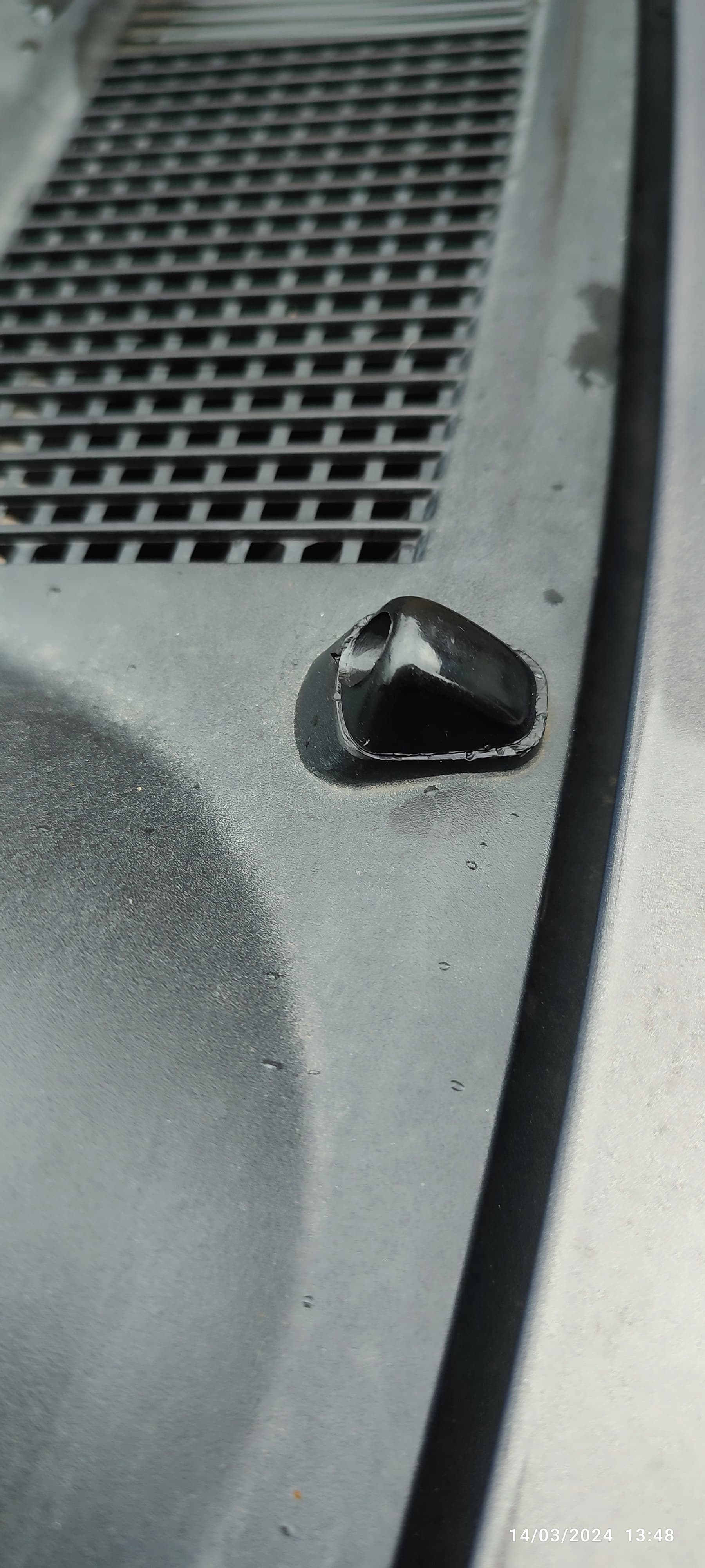

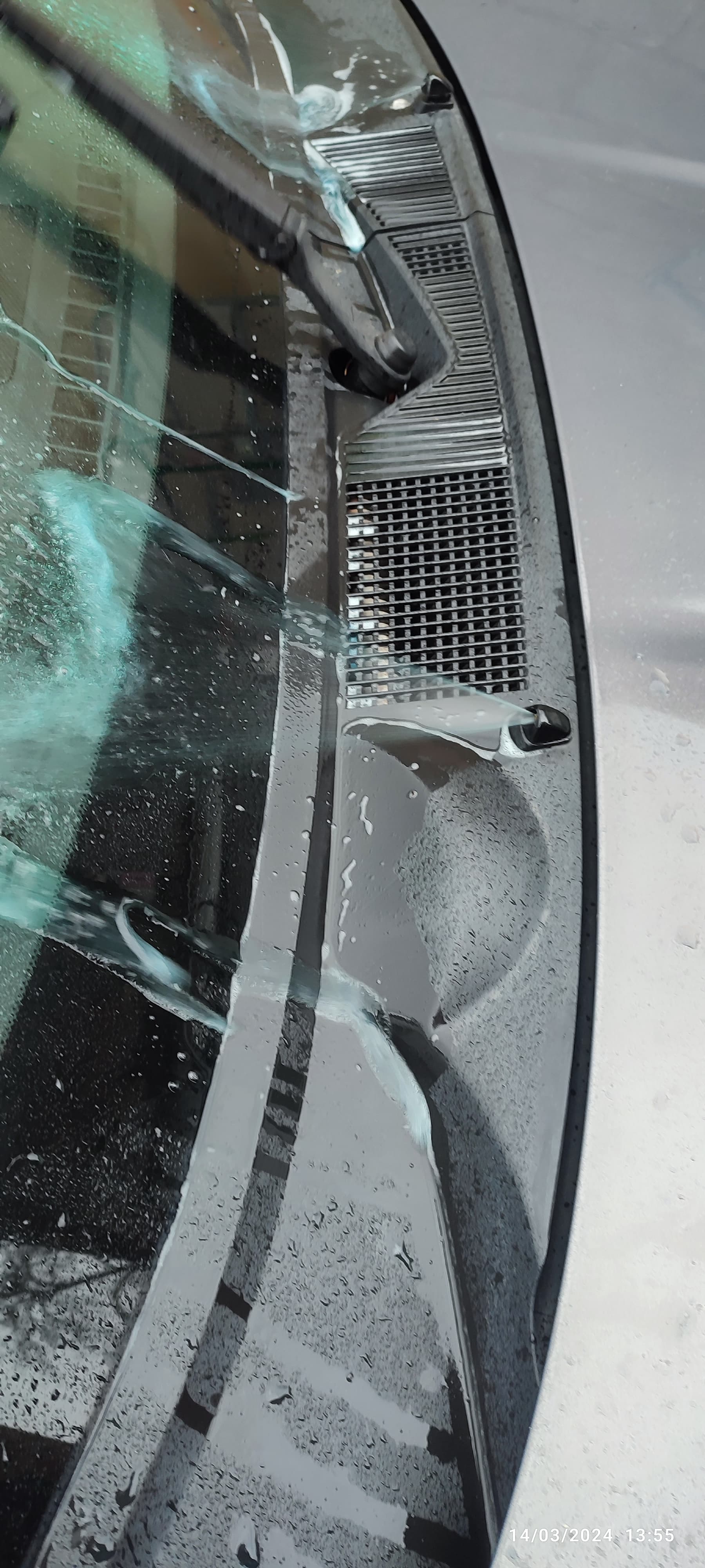

I have a pic of the jet fitted and spraying, bear in mind I need to adjust the jet still!
fix the spray pattern and get back to us… our lives depend on this
Not too much pressure then :grimacing:
