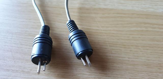

Hello everyone, I made a pair of test speaker leads up this morning.

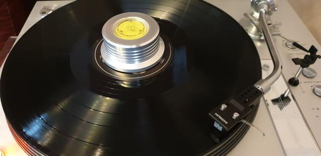

So, today I’ve been setting up the turntable to get the best out of it. First off, was getting the turntable level,
This record clamp has a built in level.

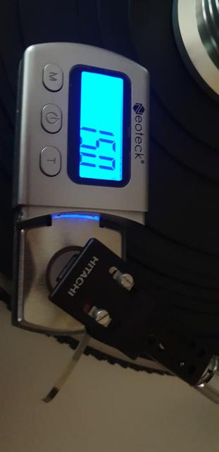

Tracking force was next on the list. Handbook said 1.5g so calibrated the scales and set the counterweight on the tonearm the same.

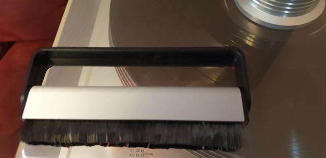

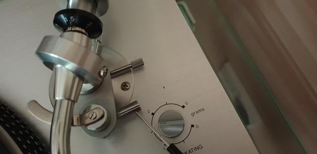

Also set the anti skate to the same measurement of 1.5. Also bought a new carbon brush for the records.

Hi Barrie. It might be worth re-checking the balance of the tonearm again after setting up the stylus overhang, as, if you had to make some adjustment to the overhang it could alter the balance. I have the same record clamp as you and yes it is a great and reasonably priced product (compared to some). I must say your turntable looks fantastic and beautifully engineered .
