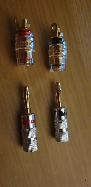

These are the banana plug and socket arrangements I’m using to convert the LEAK 2060 speaker input plates.
They’re not expensive and are a better solution than the 40 year old screw in peg type that are original to the cabinets. These plates also provide for 2 pin DIN plugs too although I shall not be using them. The holes in the plates are the same size for both the old and new sockets so relatively easy to install. I de soldered the speaker cable pin connections to remove the plates from the cabinets and I’ve used crimp terminations (female spade and ring types) to reinstall. I’ve done one speaker, the other tomorrow and then put the banana plugs onto some decent gauge speaker cable. I currently have the LEAK 2060’s with a nice pair of LEAK 600’s coming, also a pair of MOURDANT SHORT M10’s so I’m on the look out for a speaker switch box of reasonable quality (either passive or powered) Ā without paying the earth, to control the speakers (1 in -3 out). I have a cheap one off eBay which is total rubbish, one of the spring cable terminals fell off the day I got it!Ā I would love something with banana plug sockets but not sure you can get something like that?

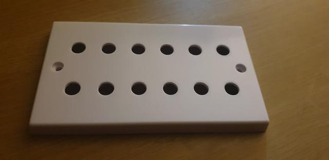

I mentioned that I wanted a speaker switch box with banana plug sockets. I had a light bulb moment and have decided to strip down the one I have and replace the awful spring speaker wire connectors with new banana plugs. So, I’ve ordered a double socket wall plate that has 6 pairs of 4mm banana plug sockets on it. Cheaper than buying the sockets on their own actually. They are only bolted through the fascia plate. I need to make a new back plate to overlay the rear of the switch box as it has square and rectangular cut outs where I’ve taken out the spring connectors. Once that’s fixed in place, I can drill new holes to mount the new sockets.Ā Just waiting for Amaxon now to deliver the bits!Ā

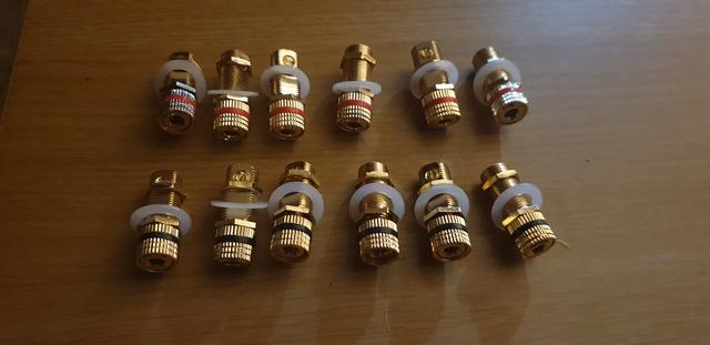

Salvaged these tonight for my DIY speaker switch box.
They came bolted into this
A double socket size AV wall plate. It was cheaper to buy this complete rather than just buy the sockets on their own? Go figureĀ
Anyway, 5 minutes with a 10mm open ended spanner and they were off! To go with these chaps,

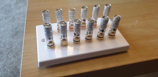

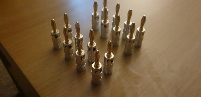

Hiya, not got too far with the switch box but refitted all the banana plug sockets to the double fascia plate and matched them with plugs. Waiting for the pedestal back box to arrive, hopefully next week sometime then I can finish it off.Ā
The eagle eyed amongst you will have noticed one of the black bands is missing from one of the sockets? It pinged off somewhereĀ Ā I’ll soon sort that though with an O ring or even some black paintĀ
