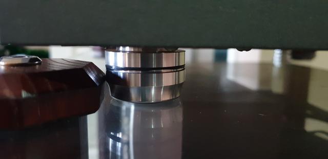

Also fitted the new feet to the TT. The originals have a soft (ish) rubber suspension inside a hard circular foot. Two of these had collapsed through age I guess. Instead of being proud of the foot, they had settled down inside the foot cup itself, negating any benefits. These new ones are billet alloy with an O ring under the foot. Very well made and solid.
They are a smaller diameter too, so fit inside the top mounts of the HIFI stand
