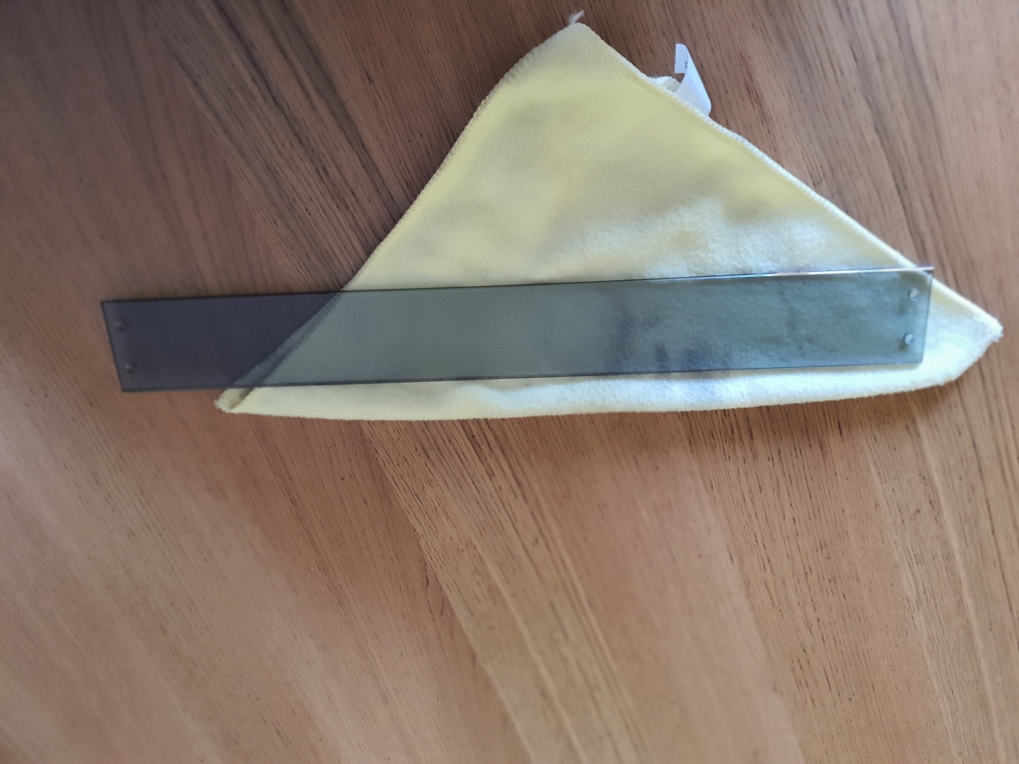

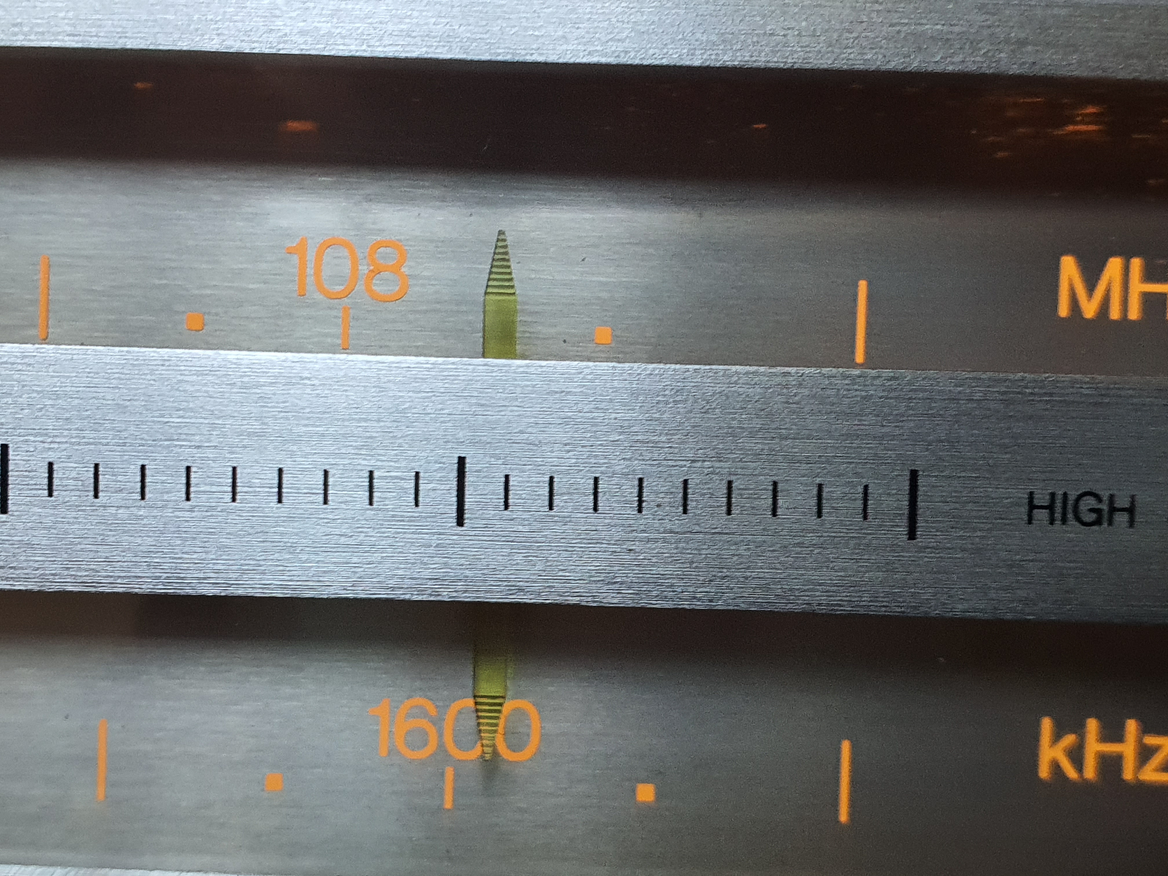

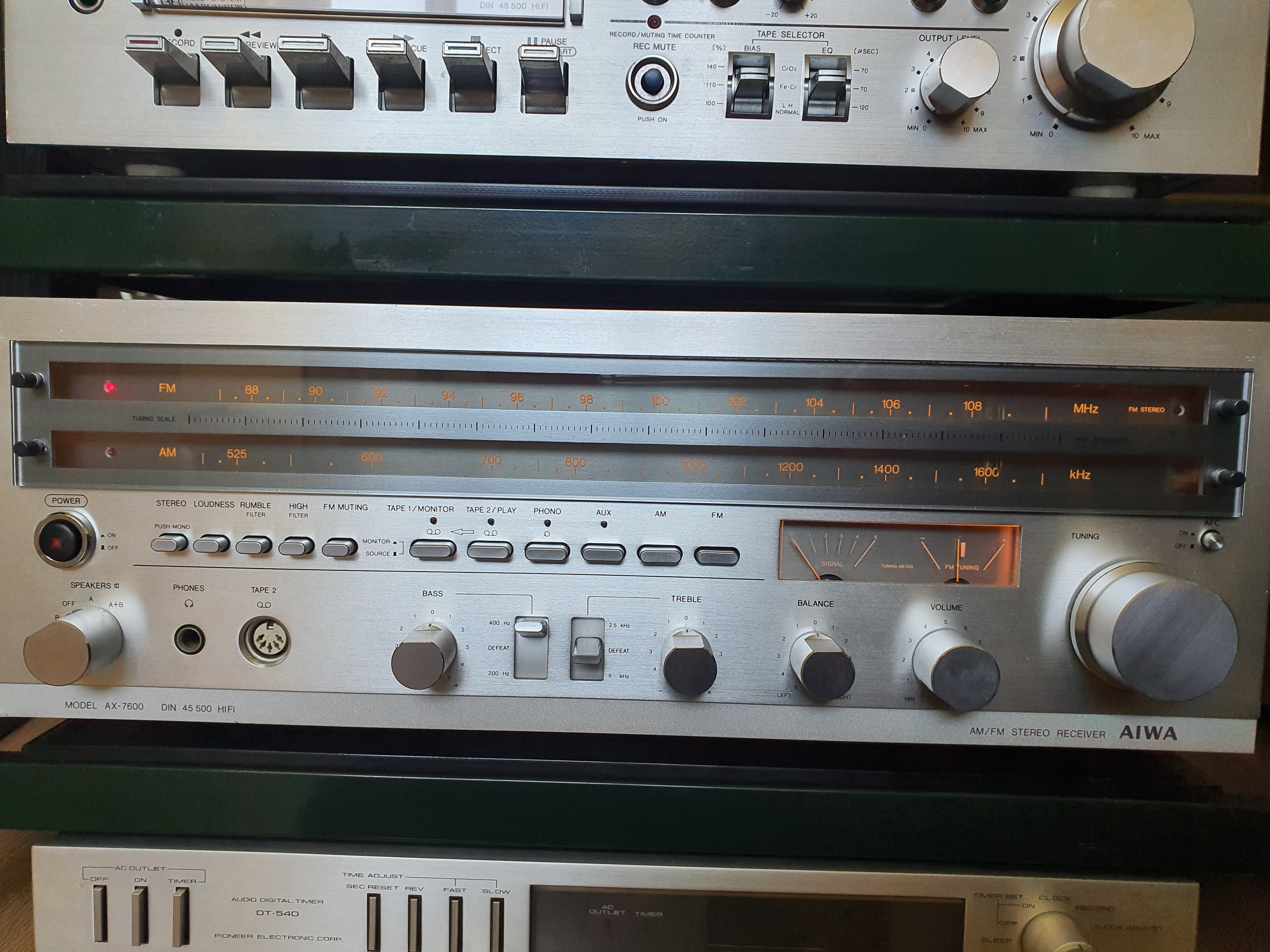

I’ve had several exchanges via eBay messaging regarding the damage to the glass fascia on the AIWA AX-7600. End result is the chap has reimbursed me the cost of having a new fascia made, which I’m very happy with :+1: I bought the cassette deck from him too, although that was described as for parts/not working which is exactly what it is. :rofl: A real shame as it’s a beautiful (IMO) looking cassette deck. The joys of eBay buying! :thinking: I’m picking up the glass later today and I will post up some pics when I get it. I’ve also ordered a red, grain of wheat bulb for the tuner needle. The originals are 8v 60ma, all I could find were 6v 65ma, fingers crossed it will work. The only other option I could find were 12v 80ma, my thoughts were that may be very dim? Richard, if you read this perhaps you could advise if my choice of bulb is OK?

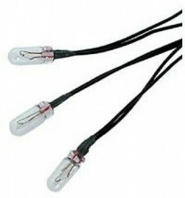

What about these? Might not be red but nothing that a bit of nail varnish wouldn’t put right.
If you buy the 6V bulbs their life will be merry but brief. The 12V 80mA bulbs will be dimmer and more yellow, but will last the future life of the equipment. If you could find some 9V 50mA that would be a very good compromise.
Remember a few points about bulbs.
Power used is I x V, ie 80mA at 12V is 1Watt, and 60mA at 8V is 0.5W. This at normal working temperature.
A cold bulb has roughly about 1/3 of the resistance of a hot bulb and will take that much more current as a surge when first turned on. But when lit with any kind of glow will be near the working resistance.
Some working out for your application.
The original 8V bulbs have a working resistance of 133 Ohms at 8V, and about 45 Ohms cold
That 12V bulb will have a working resistance of 150 Ohms at 12V, and about 50 Ohms cold, and will take about 55mA at 8V, about 0.5W, so it’s OK to use, similar light level just a bit yellower.
That 6V bulb will have a working resistance of 90 Ohms at 6V, and about 30 Ohms cold, and will take about 90mA at 8V, about 0.75W, so it’s not OK to use, regardless of its bright brief life.
And I assume you are happy with delicate soldering by now…

Hmmmmm? :thinking: I take on board what you’ve said Richard. I’d read that folk were using the 12v bulbs but were complaining they were dim. However, dim is better than nothing, which is what I have currently. It’s only for illuminating the tuner needle so I think I’ll order the 12v ones to be safe. The bulbs is on a long lead as it moves from the power connections along the dial, so easy to solder and heat shrink to the original leads. Not sure about replacing caps and the like though :woozy_face: Thank you Richard, I was hoping you would come along and give advice :+1:
Hi Paul,your suggestion got me thinking :thinking:

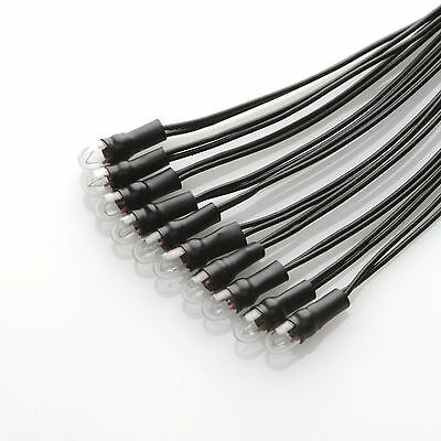

I recently bought some 8v bayonet bulbs for a piece of equipment from Germany. Great service from them. Went back into my orders and found them, searching their store, found these.
Almost perfect for the job, as you said, nail varnish will give the colour I need :+1: Many thanks to all for help,suggestions and advice.

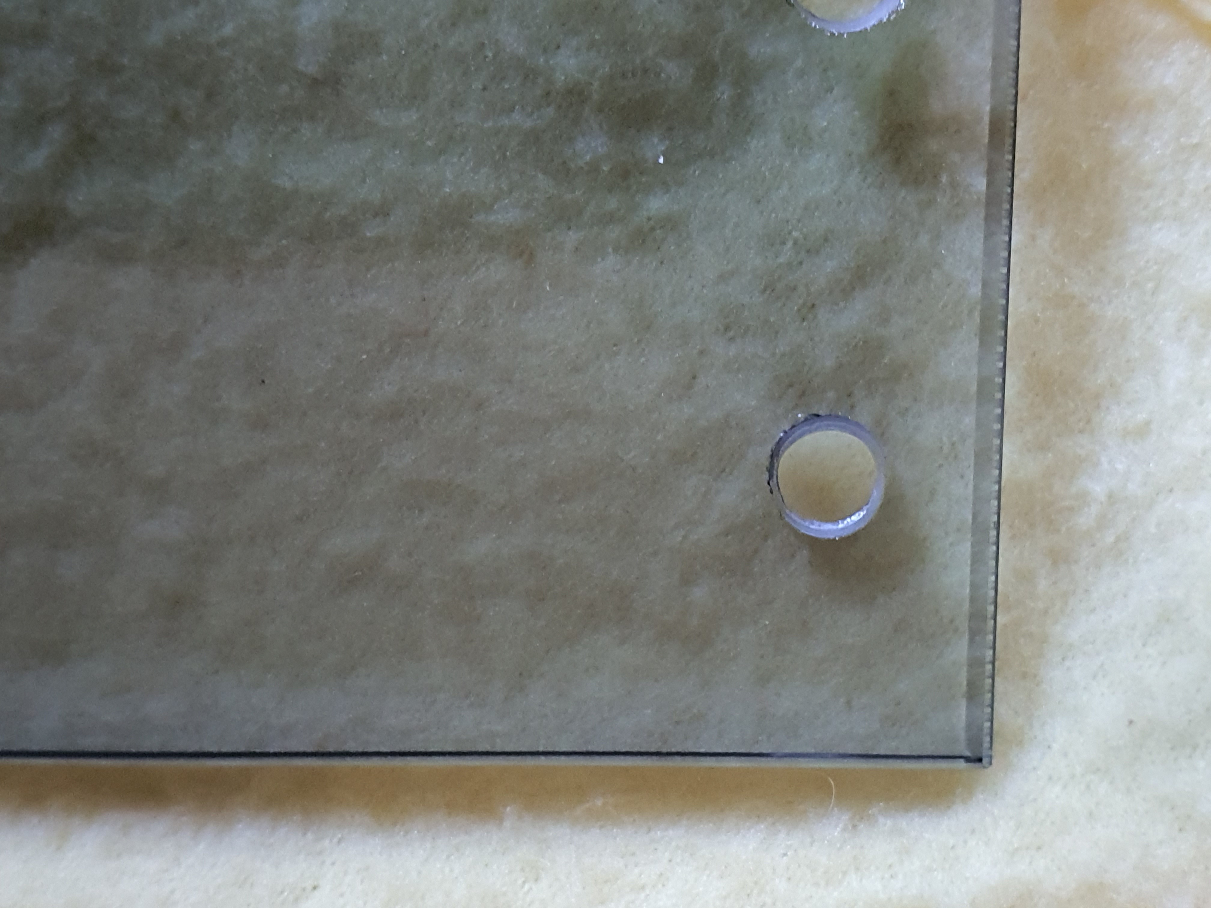

Just popped to the glass place, 1 mile from me, to pick up the glass fascia for the AIWA AX-7600.:+1:Top job and fits perfectly. The same tint as originally fitted, holes are perfectly aligned and exactly the same diameter, etc.
Very pleased. Just need the new grain of wheat bulbs to arrive from Germany to illuminate the tuner indicator and job done.

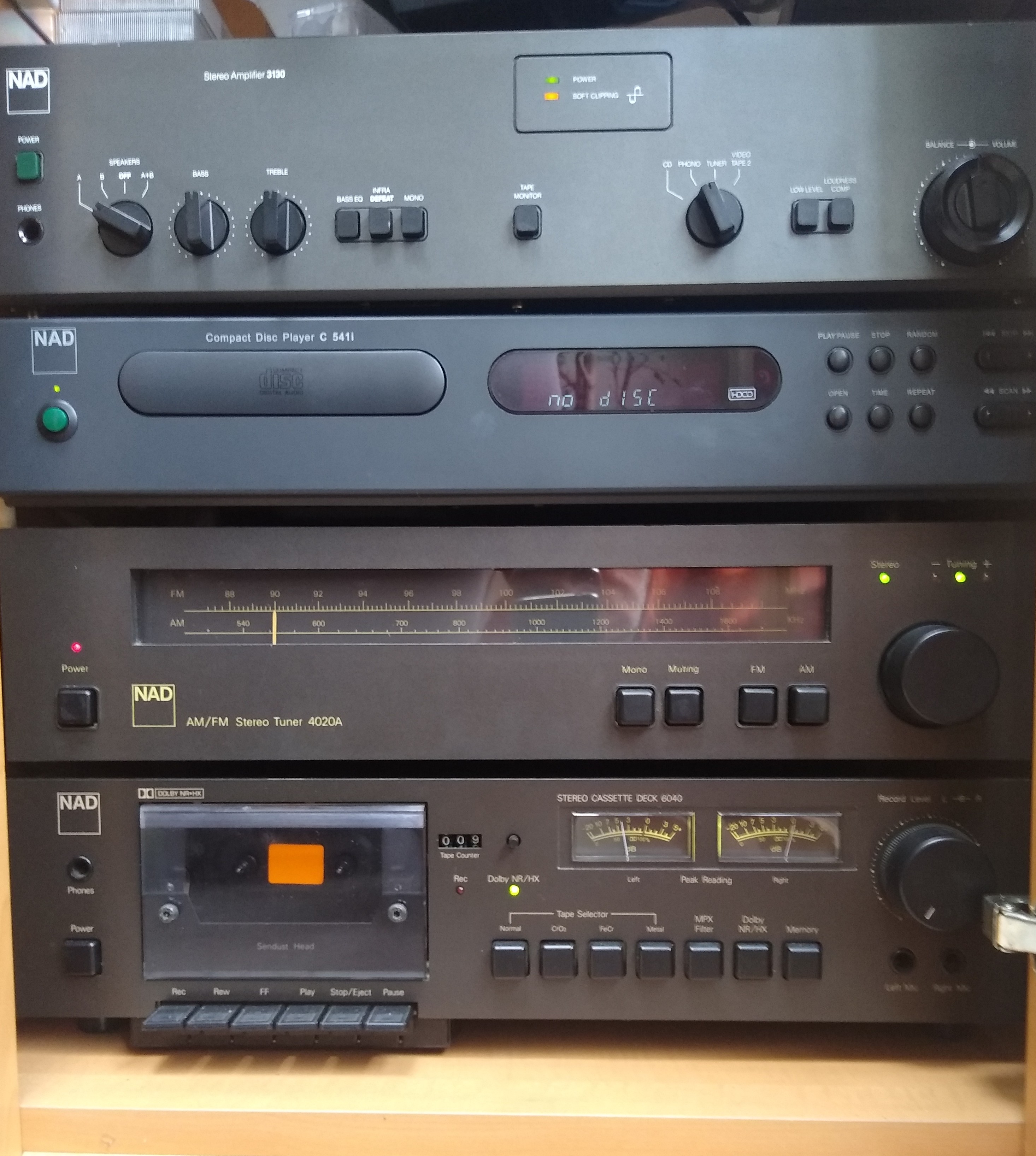

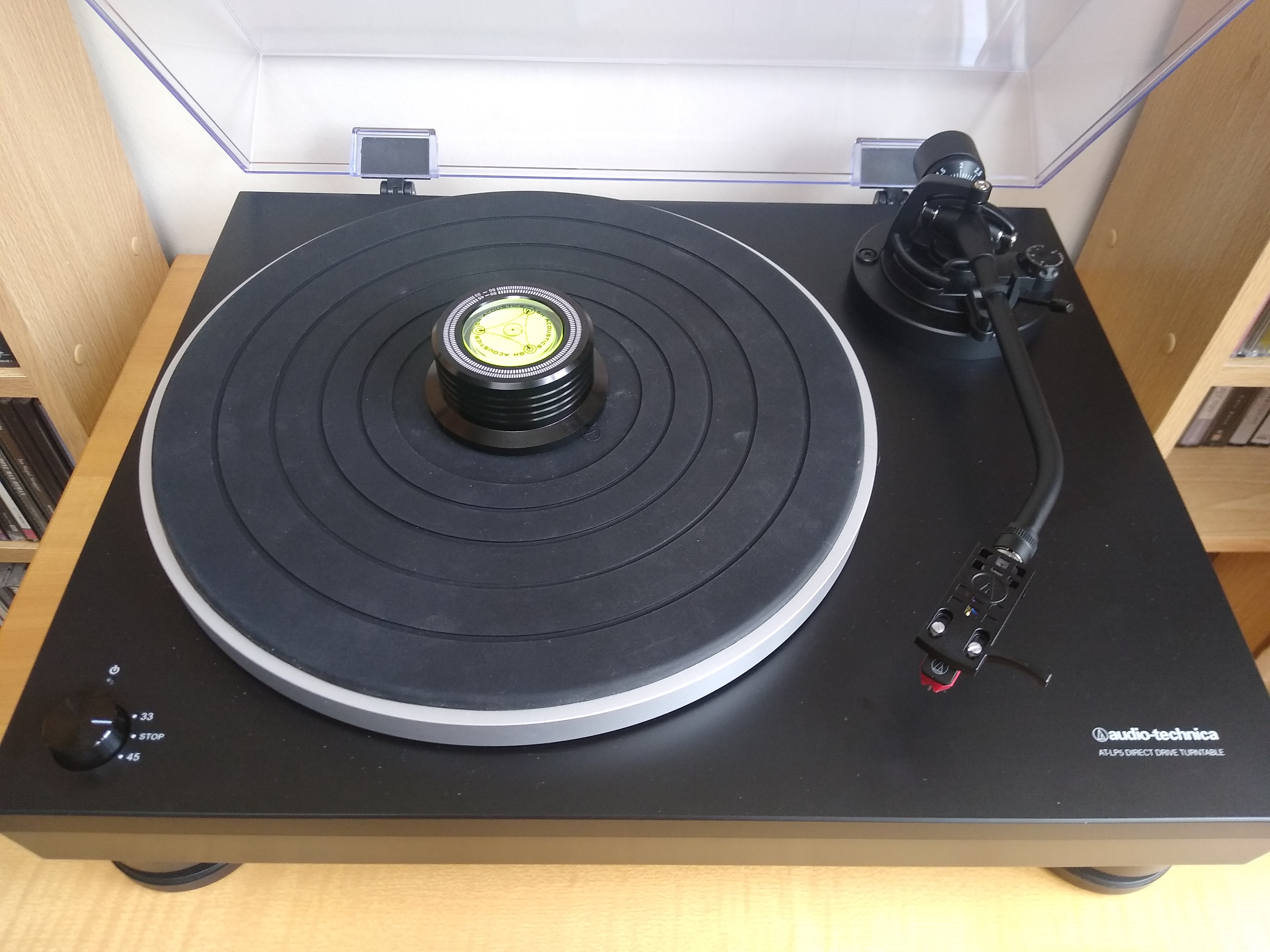

Below is a picture of my mainly retro HiFi. Not as stunning looking as some of the other outfits on here. The NAD Tuner and Cassette deck are about 40 years old. Unfortunately the needles in the VU meters of the cassette deck are stuck but otherwise it functions extremely well. The NAD 3130 amplifier and the NAD CD player are about 35 years old. I gave my old NAD 3020 amplifier and Dual 506 turntable which are about 40 years old to my son and they are both still performing perfectly.
My turntable is a 2019 Audio Technica AT LP5 direct drive with an Audio Technica VM95 cartridge fitted with a micro-line stylus. It may not look as fabulous as some of the other systems on here but the sound it produces is superb.
