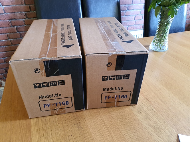

Thanks Roger :+1: hopefully all will be good. I think these Proart mono-blocks get bad press from some high end audiophiles (and some not so high end folks) for £100 a pair though, factoring in that they can be individual stereo amps as well, I couldn’t resist! Will report back when I get them! :grinning:

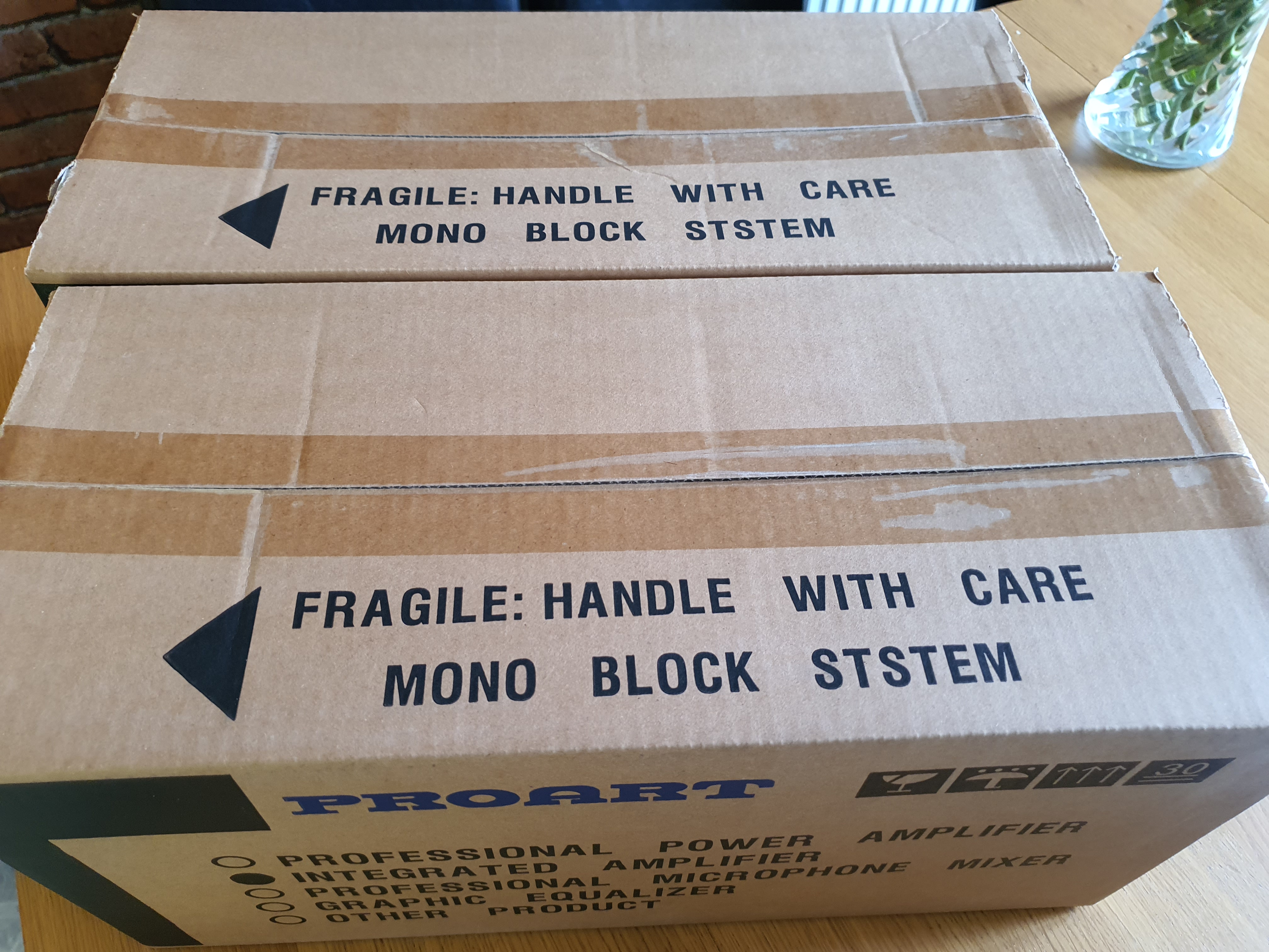

You’ve got to smile :smiley: its a mono block ststem rather than system!

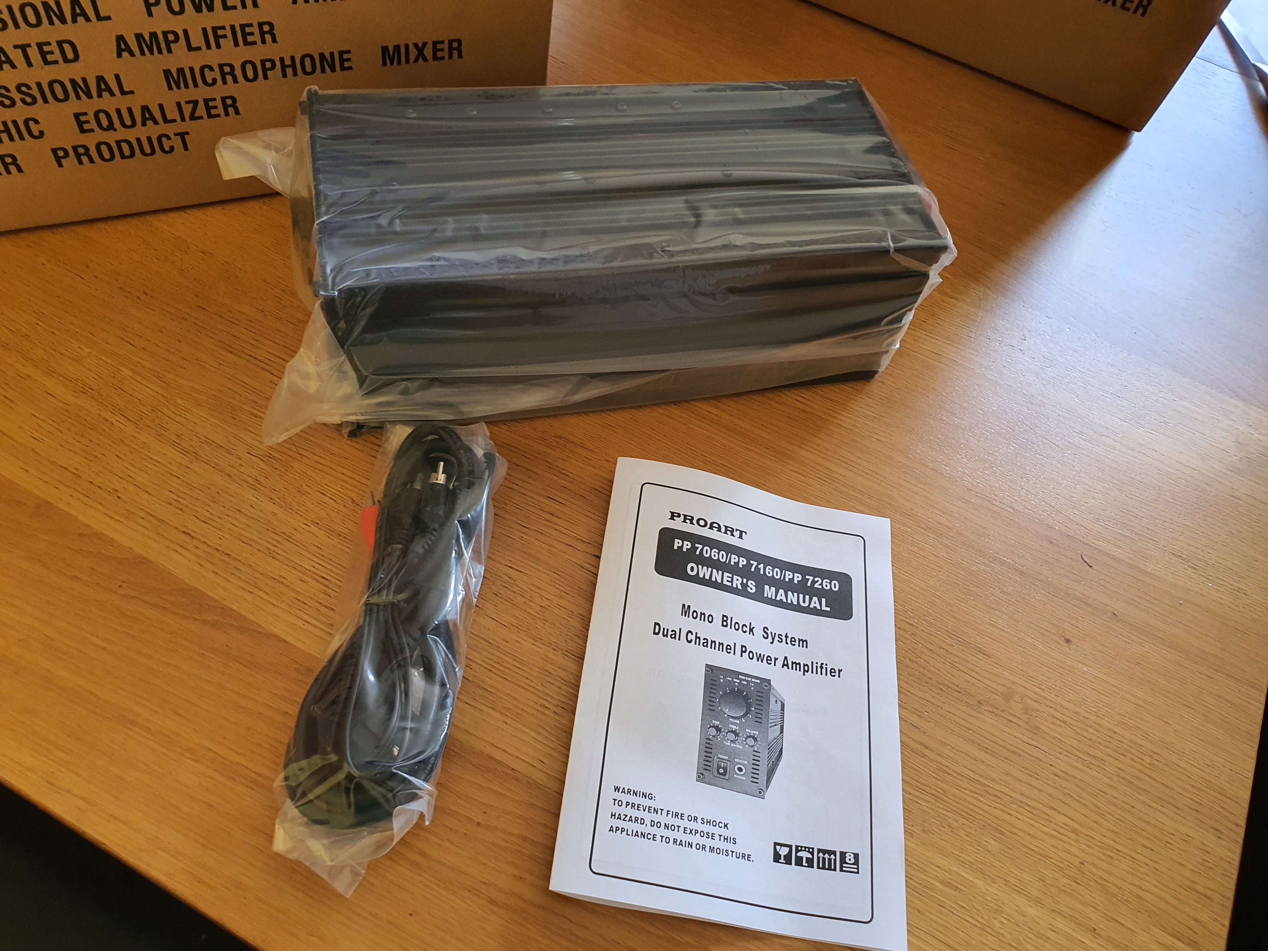

Well, it did come with leads although a 2 pin non UK Plug fitted. There is a manual of sorts so thats possibly good too!

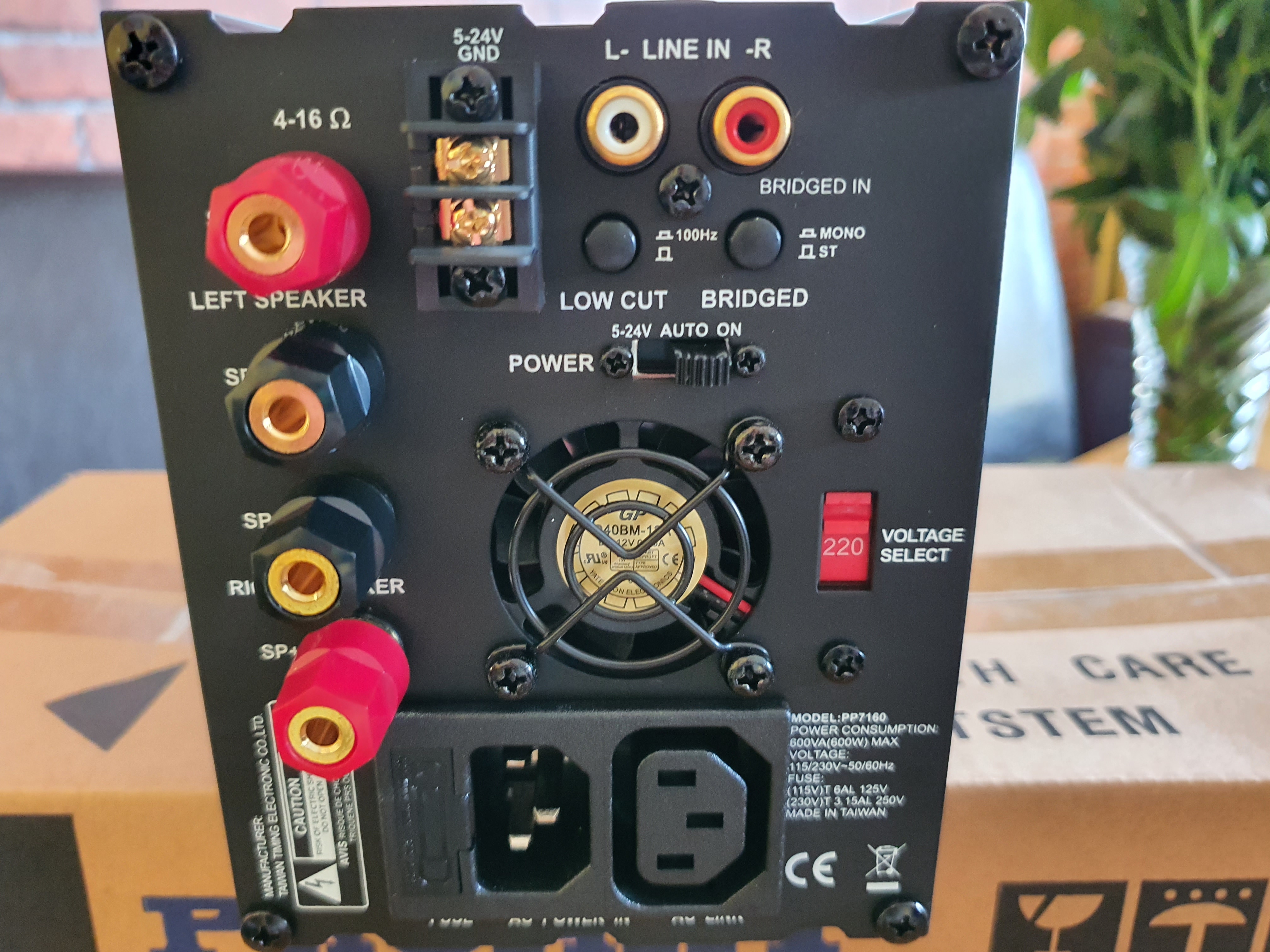

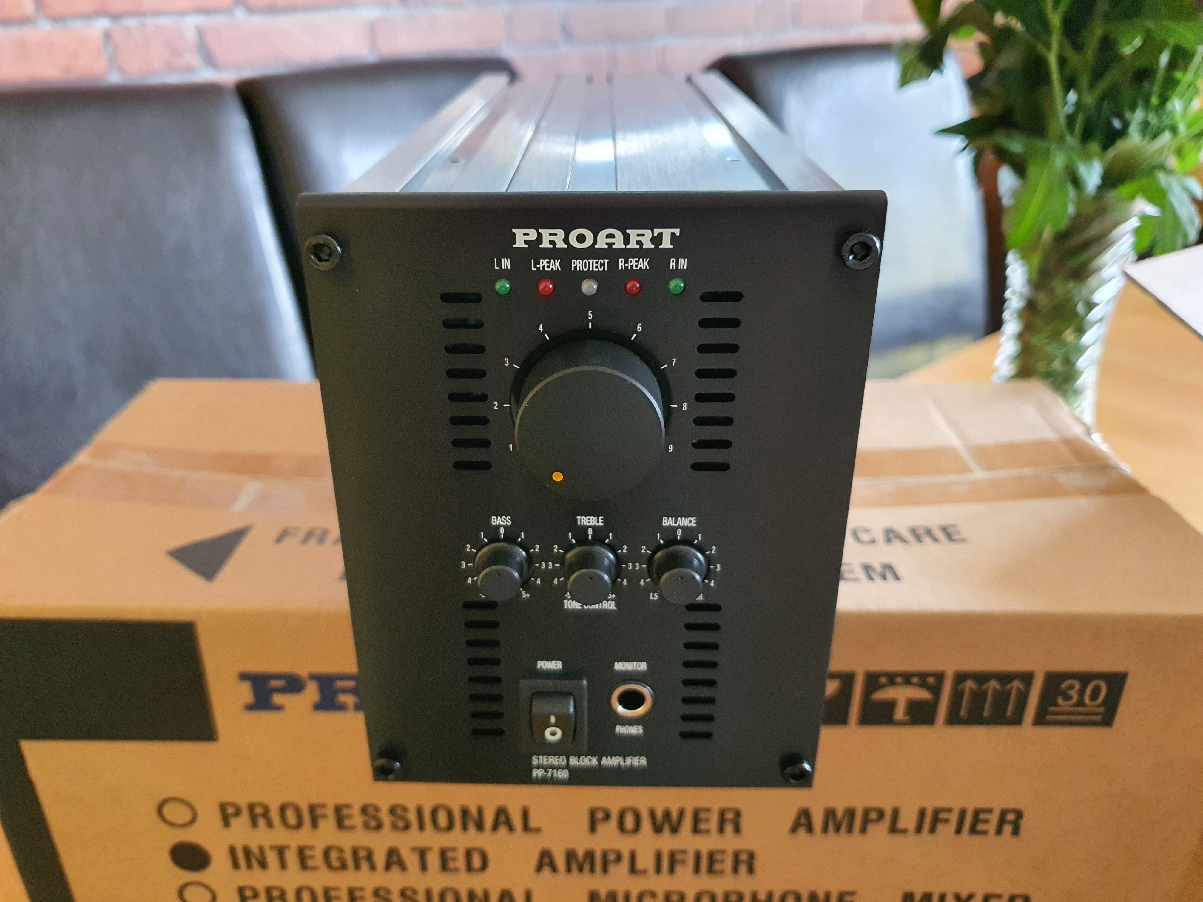

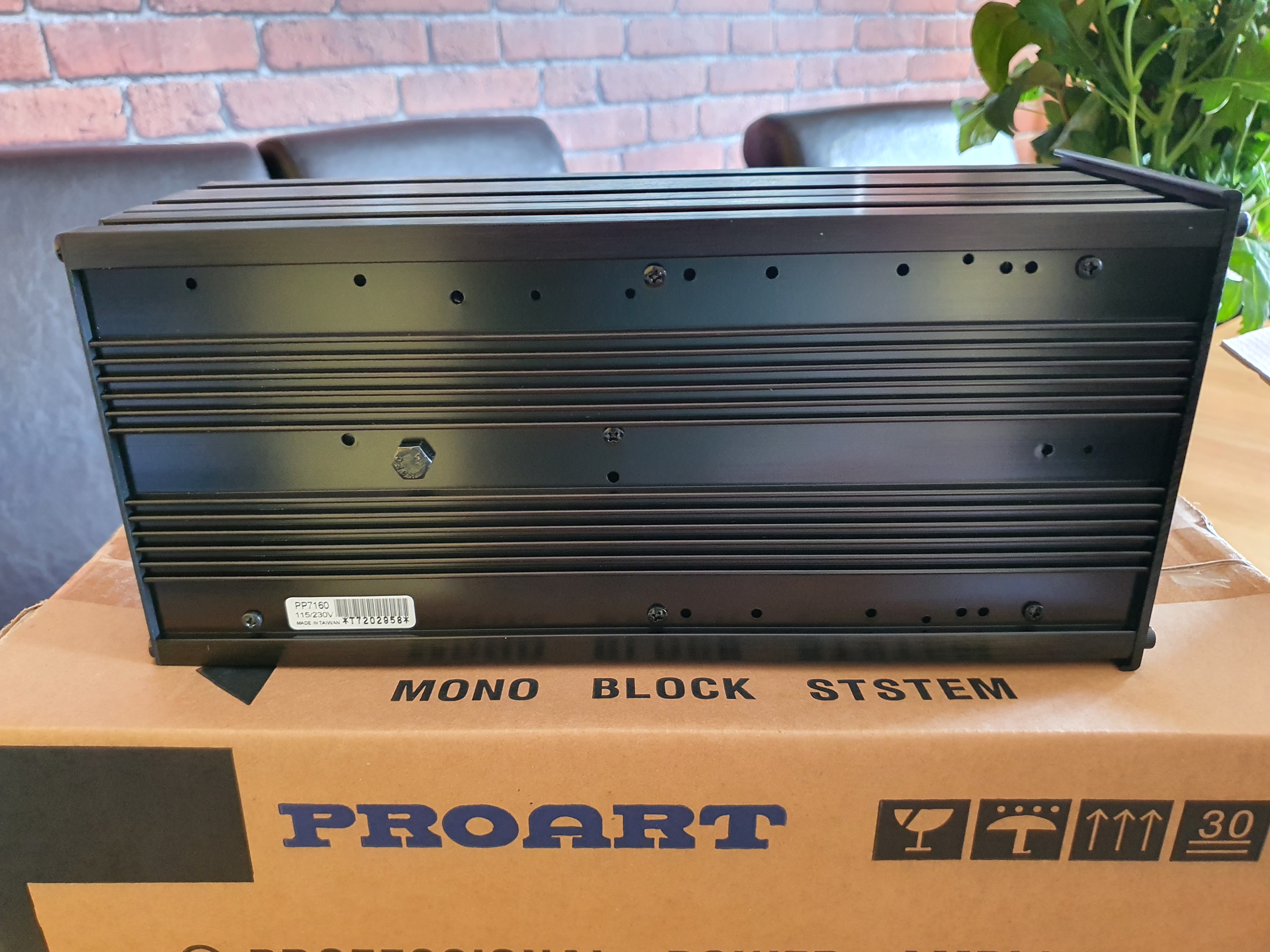

Out of the packaging and everything ‘feels’ nice. Quite heavy for a small amp at 5kg, beautiful finish, alloy anodised black casing, front and rear panels as well, volume knob has a real nice click as it turns. Banana plug speaker binding posts too! All good from the aesthetics department :+1::+1:

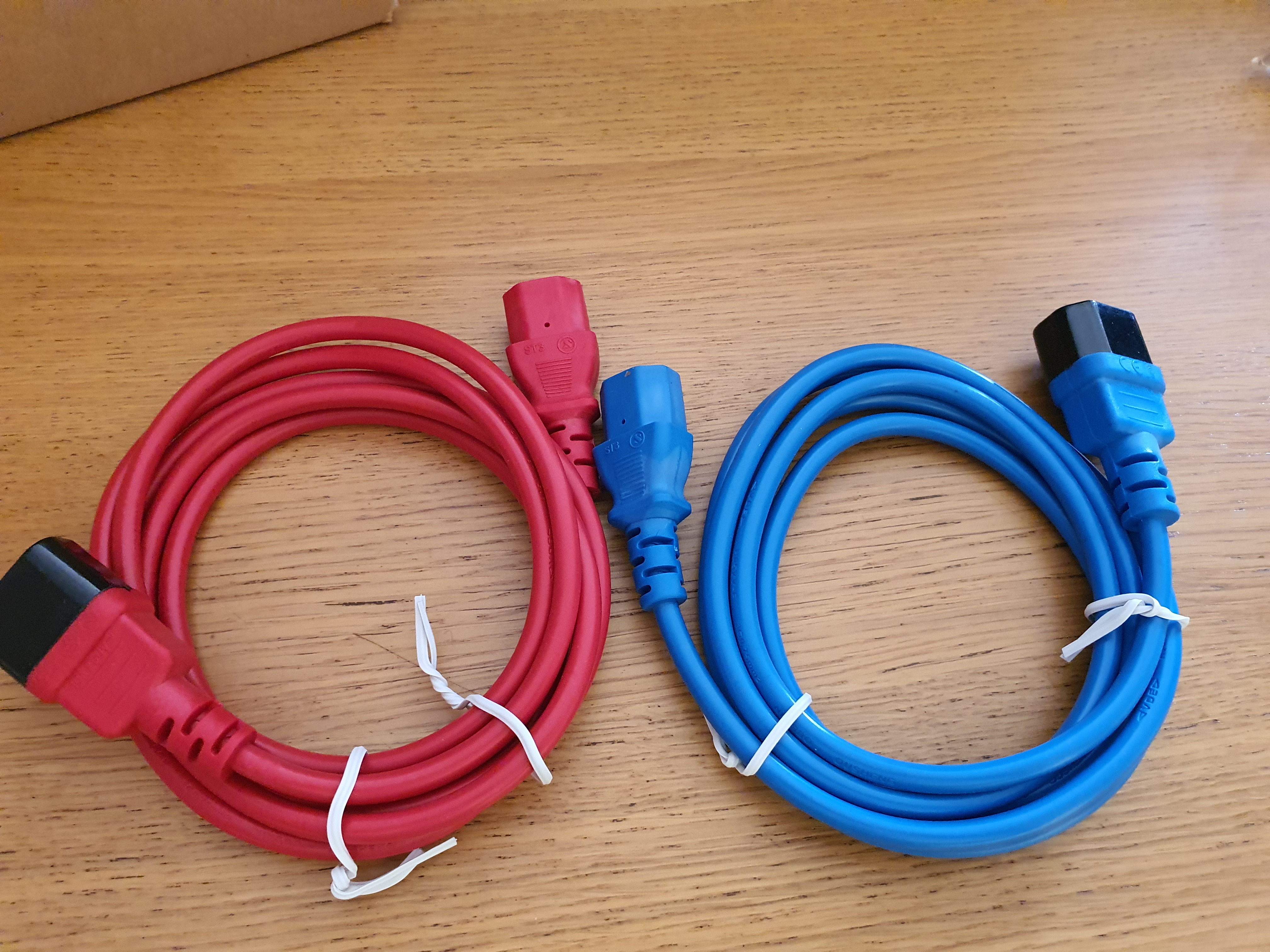

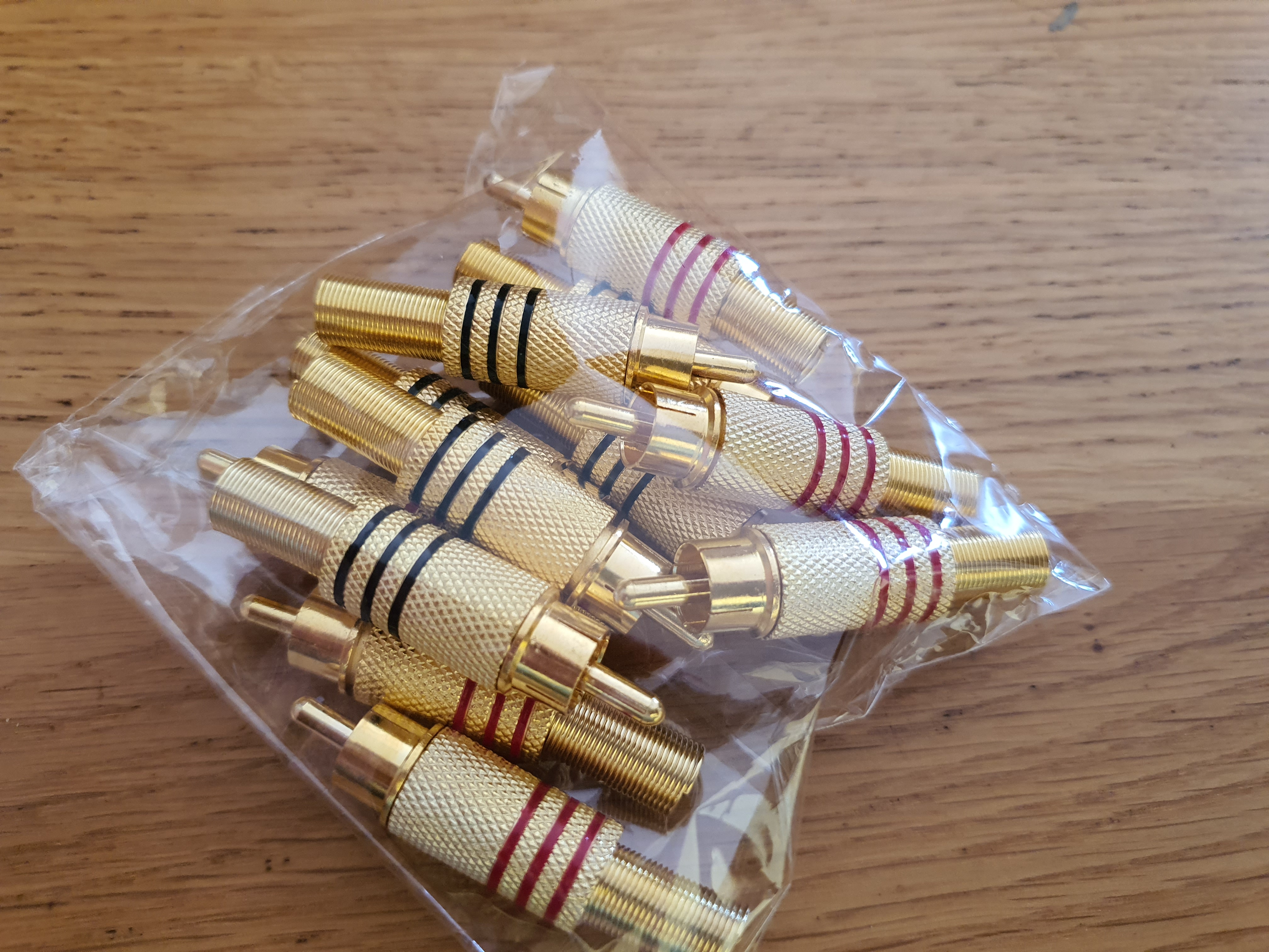

The new leads arrived along with the solderless RCA phono plugs :+1:
We must be getting back to normal possibly regards posting/deliveries as everything was ordered yesterday and here today :grinning:

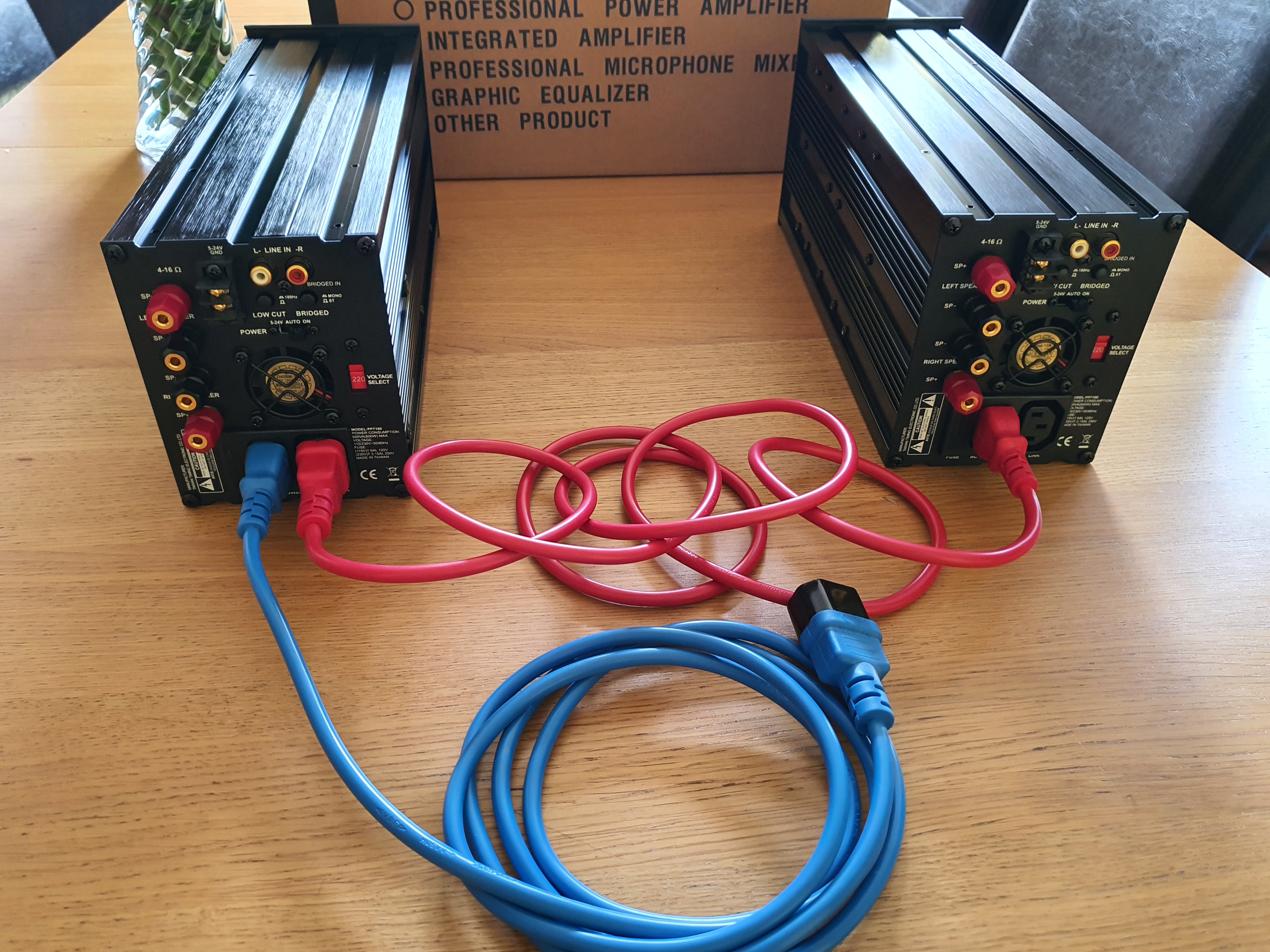

2m leads so plenty of length, I just need to wire a UK plug on one of them and use the other to link the amps as they have an AC out (not switched) to daisy chain them together.
Test fitted the new leads :nerd_face:

Hi all, been combing the internet for information on these new amps. I found a snippet regarding using them in bridged (mono-block) mode. Basically, the speaker connections should be both red (+) outputs from the amps to a single speaker, not using the two black (-) speaker terminals. Read this on an AV forum and also viewed a picture showing this on a Russian? site. I’ve now got a 2nd line level converter to match the one I already had so, my next step would be to connect these (or one) to the speaker outputs of one of my main (Call it a pre amp), hopefully.
https://images.app.goo.gl/ovSddfCDfFtWmuMC6
I do have an issue though :thinking:
Originally, my intention was to use A +B speaker outputs together (selectable on the main amp) into the converter, then plug both RCA outputs from each line level converter to the pair of RCA input sockets on each mono-block. (I’m thinking though that these input sockets are for using the mono-block in stereo mode with a audio component (cd player/tape etc as a single integrated amp).
Each line level converter has 2 pair of speaker connection wire inputs, the line level outs are a pair of RCA phono female sockets. Using only one converter, I could connect both pairs of speaker wires on the converter to +/- L/R outputs A or B selected, on the main amplifier, that would give me just a pair of RCA phono connections.
Is plugging one RCA output into left mono-block and the other into the right mono-block going to give me what I need? The Russian website shows a single RCA connection to an amp with, as said, both red (+) connections to the speaker with the mono -block switched to mono. I need help as I don’t want to burn out or otherwise destroy the system by making the wrong connections! I feel like the scarecrow in Wizard of Oz, singing “ If I only had a brain” :crazy_face:
